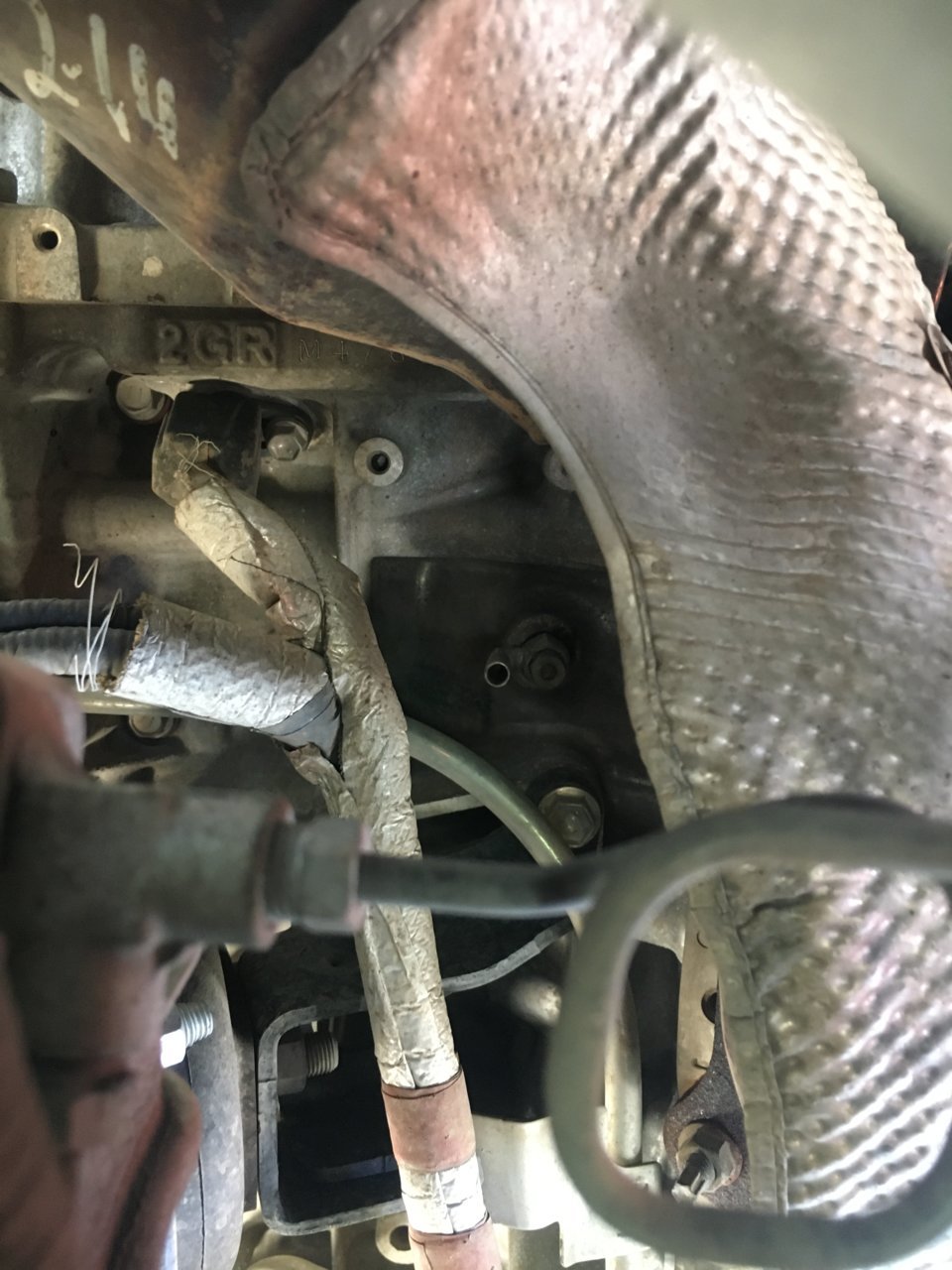

    To put in new fluid? It takes 15 mins to drain and fill yourself. Just find the drain on the side of the block . Passenger side , including the main drain on radiator as well of course.

    Gotta drain the block too

    If you get the plug on the side of the block like others have mentioned, you got about that much out. Including drain from radiator.
    I emptied 2.5 large bottles

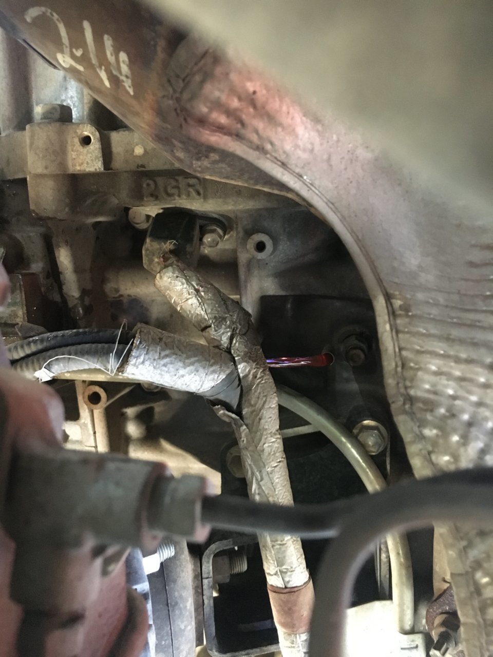

    U have V6?
    Its easy to spot if you look through passenger side above straight past suspension spring. Lift the flap and use flash light. Just a tiny bronze color head on it

    Following up on this after my scavenger hunt to find the block drain plug.
    I took some pics:
    Looking straight in through the passenger wheel well (move the rubber flap)
    10mm to loosen it
