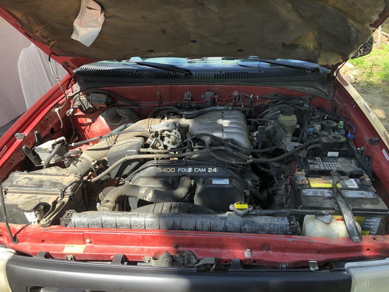

    Alright so I’m sure this has been covered in here about a thousand time but I’ll tell you what I’ve got goin in and if it sounds familiar and you can point me in the right direction or a post that covers this I would greatly appreciate it. I have been looking a bit but I just don’t have a ton of time to spend on my phone browsing right now
    so my 3.4 runs great when I first fire it up or it sits for an hour or two. However when I start it right after running it in any temp above I’d say about 80 degrees outside I have a problem with it chugging like it’s over fueling itself. Sometimes if it’s like 90+ and I just shut it down it won’t start at all. It will just crank and crank. I do have the dreaded PO171 code so that could have something to do with this. The last owner said they replaced the maf and the fuel pump. I replaced the tps and got rid of that code. It didn’t want to start today at one point and I had some intake cleaner so I sprayed into the air box towards the maf and the truck finally started and ran but it did chug for a about a mile after I got going. Just not sure what to do next? Any help would be greatly appreciated! Also I can answer any questions about this that might help me get to a solution.
    thanks all

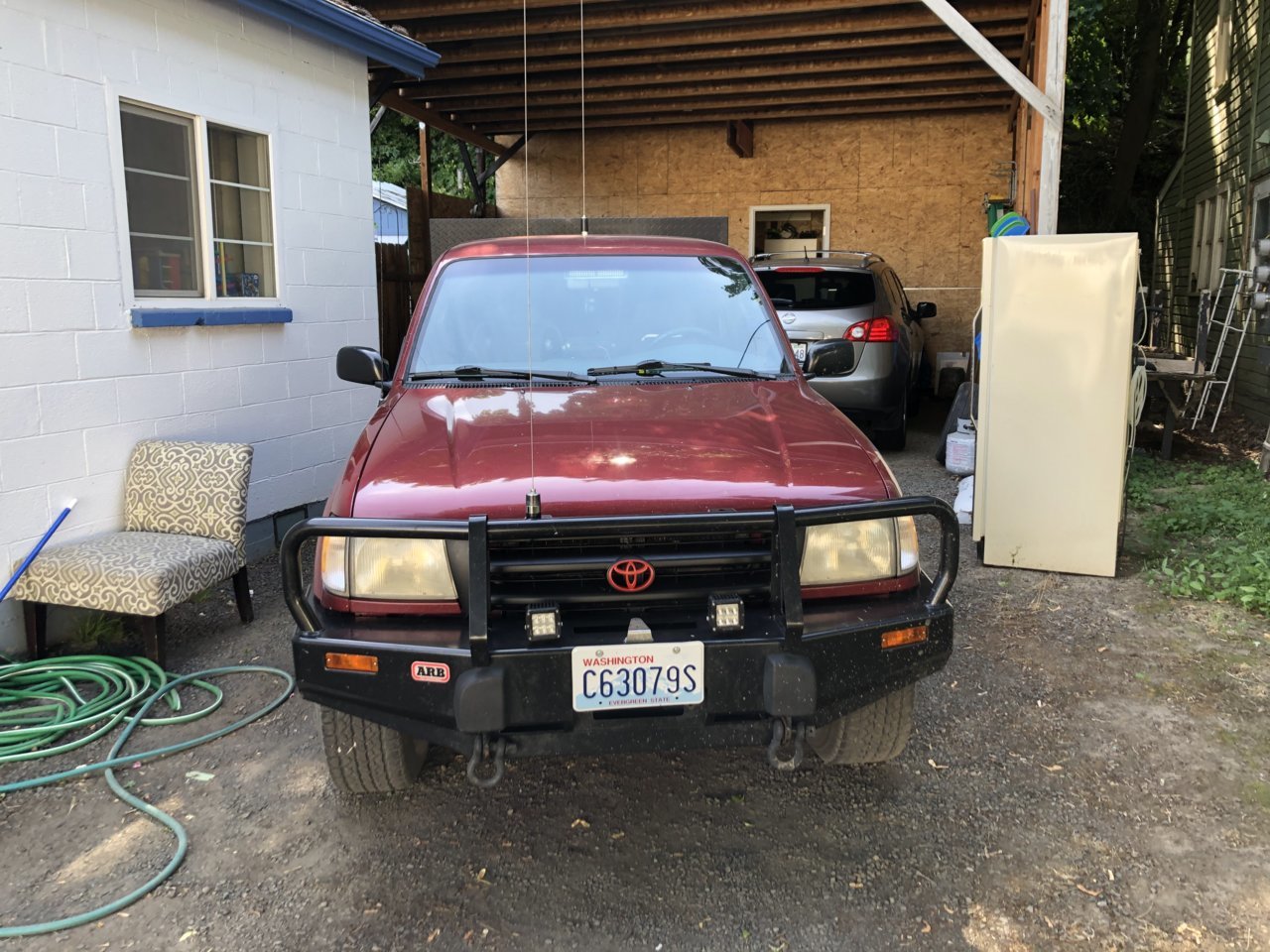

    1. Edit the title and remove "help" since that's reserved for those that are stranded, stuck, etc. Your title could lead someone to believe you're out stranded somewhere with a no start issue
    2. Your front bumper pads are installed incorrectly

    I put help because it has stranded me twice while I’ve been on a time crunch. So I’m good. second I didn’t install the bumper so I didn’t even know or know they were. Thank you for pointing it out I will look into it.

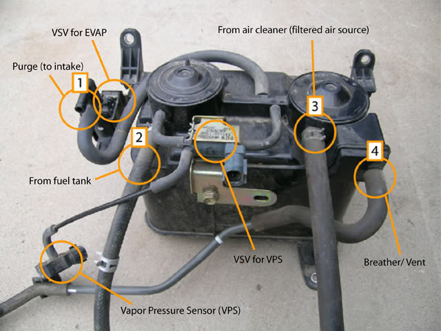

    You got the charcoal cannister under hood like this?EEBFF8B4-ACBA-4316-A854-9F2FD05AC2A0.jpg
    Tank pressure sensor is on top of gas tank.
