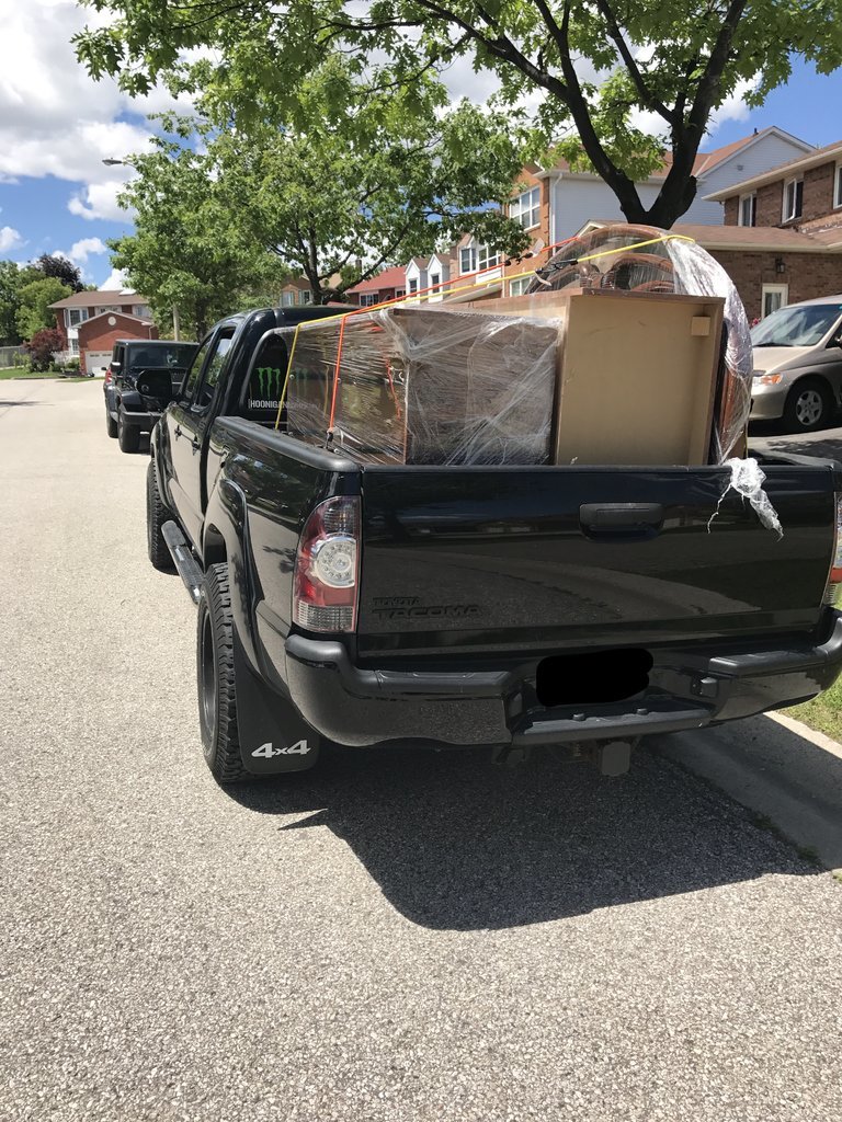

    Look for 9" wide wheel with an offset between +10 to -10
    Closer to then negative side - the more it'll poke out.
    I have 17x9 with -5 offset on 265-70-17. No rubbing after removing mud flaps

    That's all stock suspension? Looks bitchin dude!
