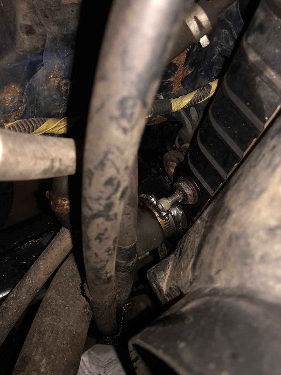

    So a transmission oil cooler fitting snapped on my 2007 trd sport 4x4. I went to my local Toyota dealer and they cannot find the part and I also have looked online and I cannot find the part! Anyone know where I could find this part?

    It goes in where the bolt is and that is what it looks like.

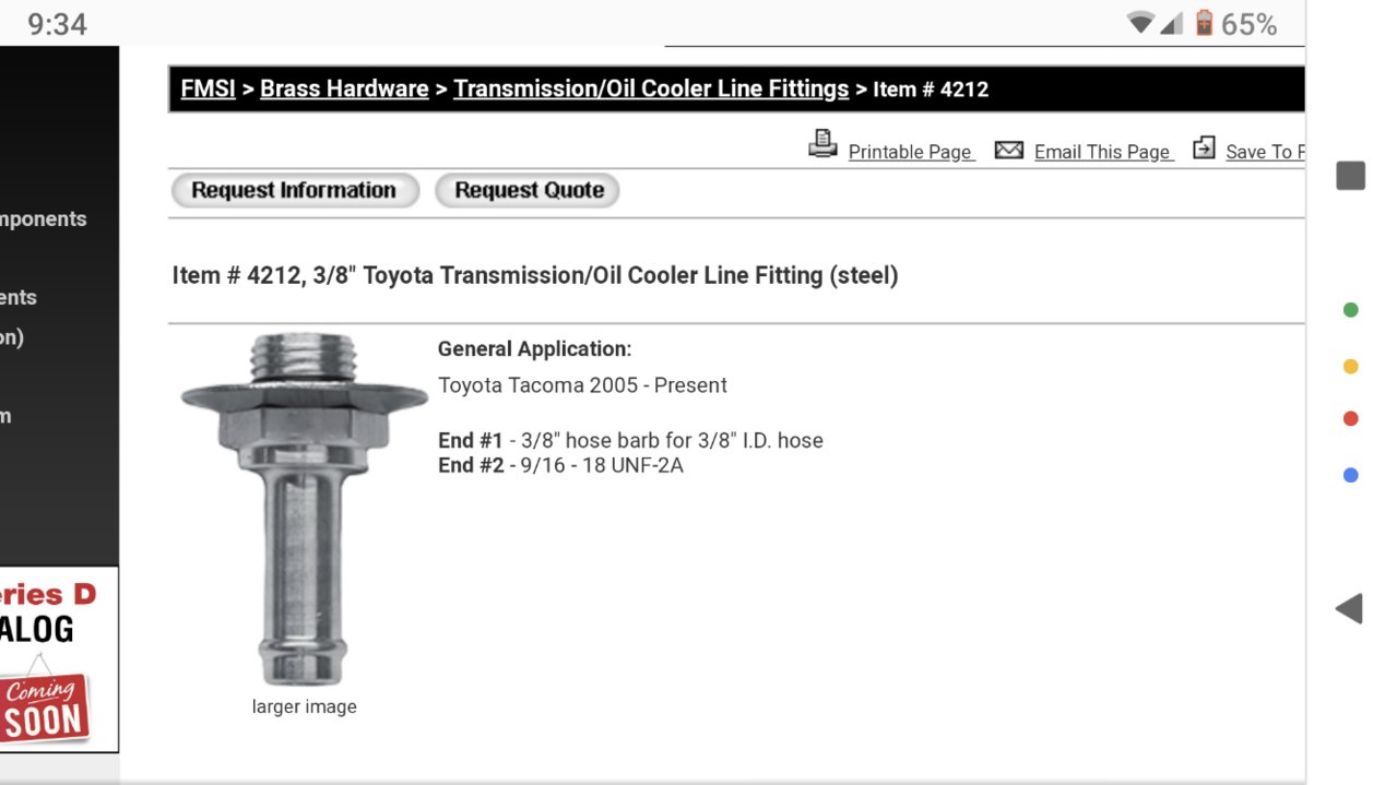

    Can you remove the "bushing" that bolt is threaded into? If so, go to Home Depot, get a brass hose barb that fits the hose and drill and tap the bushing to take the hose barb thread. You will probably need a 3/8" male pipe thread x 3/8 hose barb, or possibly 1/2" MPT x 3/8 hose barb.The home depot guy can sell you the proper drill and pipe tap hopefully. Or try a transmission or radiator shop.

    I will definitely check into that if I cannot find anything else
