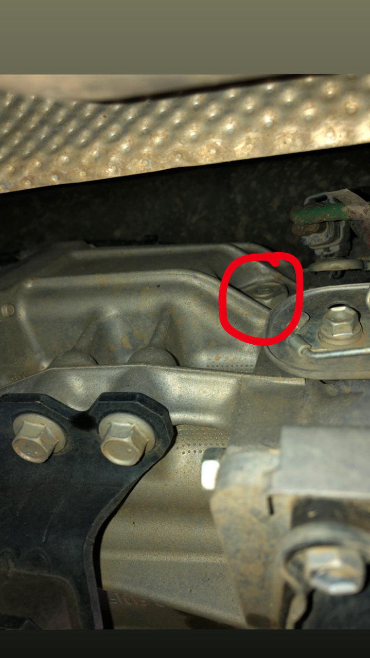

  3. Feb 12, 2020 at 1:07 PM
    #43
    Dragonaut
    Dragonaut [OP] Well-Known Member
    Mar 12, 2017
    #213111
    80
    Dennis
    SoCal
    2017 TRD OR AC (MGM)
    Correct?
  4. Feb 12, 2020 at 1:08 PM
    #44
    Beer:30
    Beer:30 There's always money in the banana stand
    Mar 15, 2016
    #181299
    1,955
    Kevin
    Somewhere North of Denver
    2016 DCSB OR V6 4X4
    Bullseye!

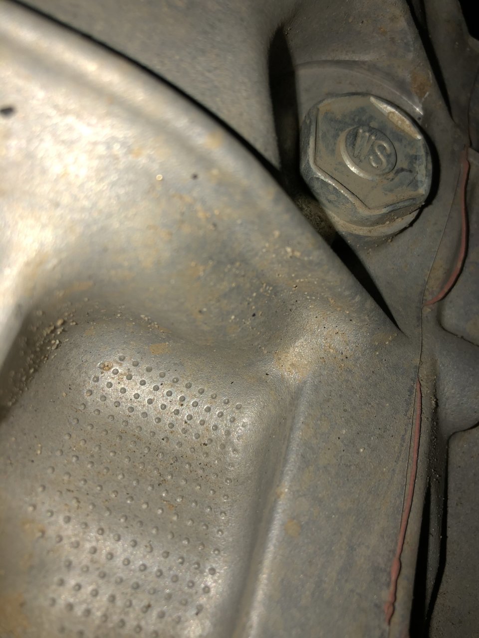

  5. Feb 12, 2020 at 1:09 PM
    #45
    Dragonaut
    Mar 12, 2017
    #213111
    80
    Dennis
    SoCal
    Another view
  6. Feb 12, 2020 at 1:13 PM
    #46
    Beer:30
    Mar 15, 2016
    #181299
    1,955
    Kevin
    2016 DCSB OR V6 4X4
    Nope, that's a 2WD AT. It's clearly stamped AC60E (4WD AT is AC60F) right there on the body.

  7. Feb 12, 2020 at 1:13 PM
    #47
    dilbert
    dilbert AI Member
    Mar 14, 2016
    #181276
    2,852
    PNW
    2019 DCLB TRD Off-Road
    Yep. Stamped WS for the WS trans fluid.

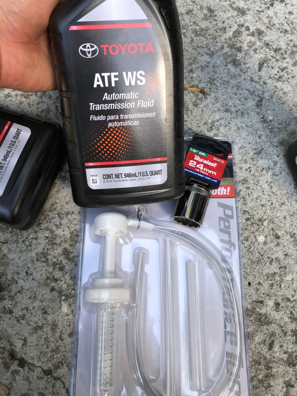

  9. Feb 12, 2020 at 1:19 PM
    #49
    Dragonaut
    Mar 12, 2017
    #213111
    80
    Dennis
    SoCal
    En route to dealership to pick up new oem fluid and crushwasher.
    Thanks for the help everyone

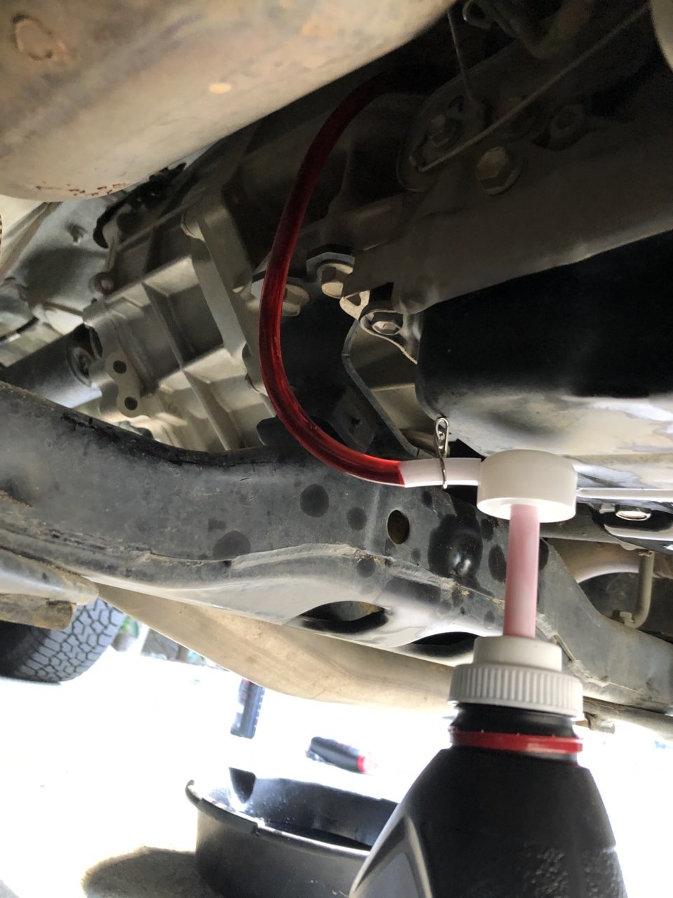

  15. Feb 12, 2020 at 2:08 PM
    #55
    Dragonaut
    Mar 12, 2017
    #213111
    80
    Dennis
    SoCal
    Installed drain plug with new crushwasher, moving on to refill phase.
    After the drained trans fluid sat undisturbed in the container i drained it into is now showing only 2 qrts exactly on level ground. So I will pump in two qrts and give it some time to work its way in and then start the truck?
    What is the margin of error with this refill ie if its off +/- by half qrt. somehow can i cause irreparable damage?

  17. Feb 12, 2020 at 2:17 PM
    #57
    Beer:30
    Mar 15, 2016
    #181299
    1,955
    Kevin
    2016 DCSB OR V6 4X4
    Based on my experience with my own truck, a drain and fill takes ~3 qts. If you only drained out 2, then yours may have been low from the factory, as many of the 16-17 MY Tacomas had this problem (mine was .75 qt low from the factory). If I were you I'd put 2.5 qts in. Actually, if I were you I'd put 3 qts in and then follow the procedure linked earlier to do an accurate level check. It's not nearly as complicated as it might seem. It does require that you have a 5MM Allen key or socket to R&R the check plug, however. If you don't feel like this is something you can do, then fill it with 2.5 qts and call it a day.

  19. Feb 12, 2020 at 2:42 PM
    #59
    Dragonaut
    Mar 12, 2017
    #213111
    80
    Dennis
    SoCal
    First quart pumped back in successfully
    Grindstone, ryan760 and Bootselectric like this.
