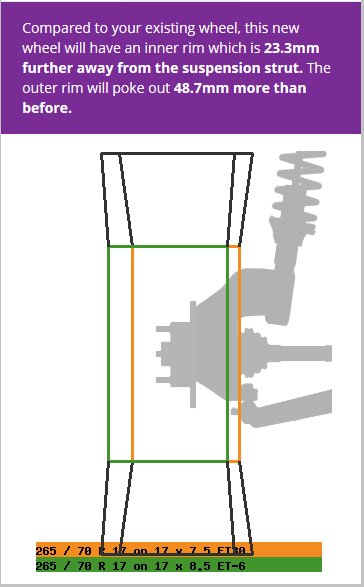

    Hopefully this will help you get an idea how the wheel will fit compared to stock and why there may be a bit of trimming required. Typically just the black plastic inner fender liner. Easy to do, I did mine with a basic pocket knife. Hopefully you also ordered a set of cone seat lug nuts to gow ith your wheels (M12 x 1.5)
    265/70R17 17" x 7.5" +30mm offset vs 265/70R17 17" x 8.5" at -6mm offset.

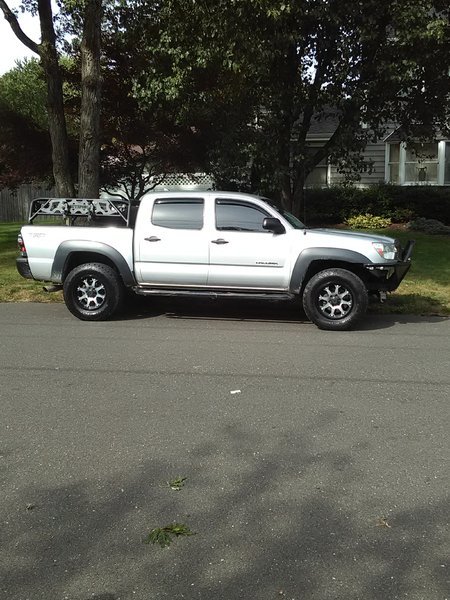

    265/70/17 at stock height all o had to do was remove the front mudflaps. Hope this helps you:thumbsup:
