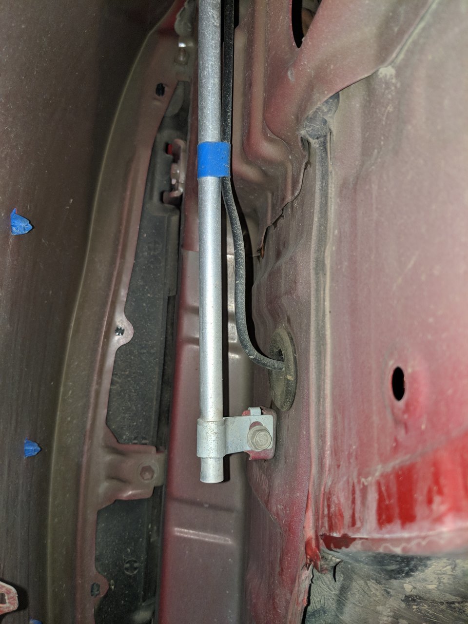

    After removing liner then remove 10 mm bolt on antenna housing. Inside of fender.IMG_20180316_165306.jpg

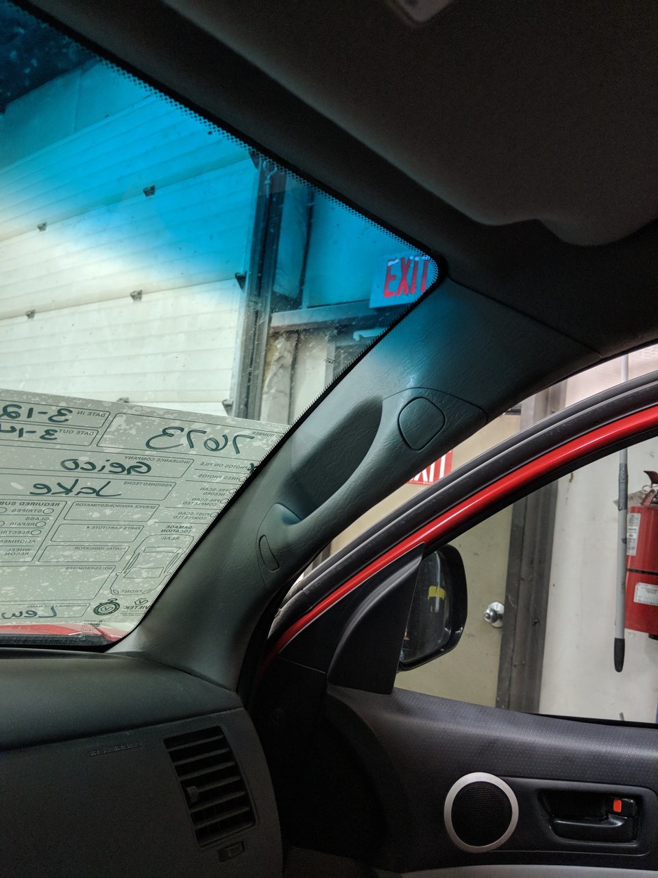

    Next remove pillar trim inside cab. To do this use a pick or very small flat head if you have one to remove covers. Try to be gentle not to gouge plastic. Remove 2 10mm bolt and pull off trim start at top.MVIMG_20180316_165710.jpg

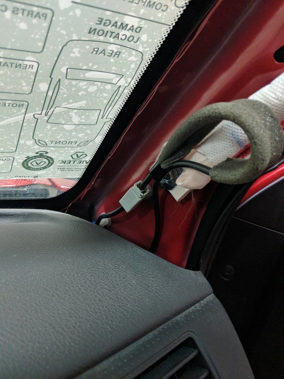

    Antenna connects here. There are a few clips on pillar attached to harness. You can break these to remove them they will be on new harness. Then pull back through firewall under fender area. If you have mechincs wire or equivalent available tie to this end use about 3 feet. Once you pull harness to opening in firewall cut wire. Attach new antenna harness to wire and pull back through.MVIMG_20180316_165739.jpg

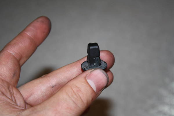

    does anyone know the trick to remove these fender well clips without breakign them? I did not remove this one... this pic is from this thread: https://www.tacomaworld.com/threads/how-to-replace-oem-antenna-in-fender.261341/
    Once I can get these off, I can finish this stupid project. I had everything else off, but after breaking one of these clips, I decided to wait until i know how to remove them or just get replacements. I have a bunch of trim panel tools to remove stuff like this, but none of them worked.
