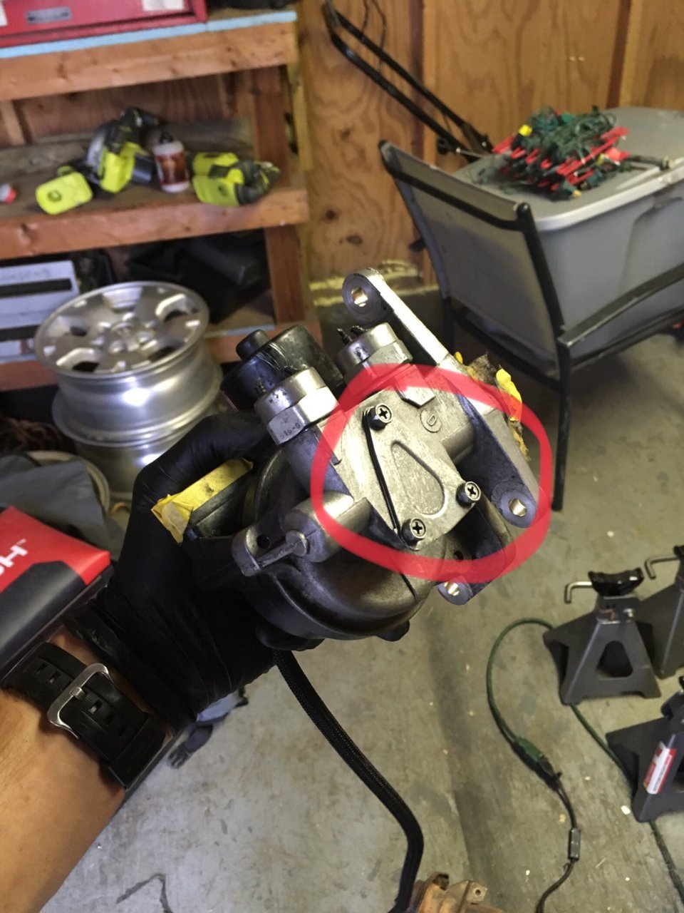

    If it’s the same t case as 2nd gens (which I’m pretty sure it is?) there’s a triangle shaped tab on the side of the actuator that you can remove with an 8mm socket. Behind it is the gear that actuates the fork in the case, you can try switching between 2/4/4lo and have someone look to see if it’s functioning.

    it's your front actuator, shitty Toyota design, will be replaced for free if you still have warranty.
    Happened on my 2nd gen, and another member with a 3rd gen had this problem recently.
