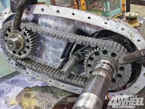

    Have it towed. I wouldn't drive on pavement in 4X4 for any distance unless it were a matter of life & death. While the parts may not break immediately, you are damaging the transfer case. This is what the inside looks like. Every time you go around a curve it stresses the chain and it stretches. After a period of time it stretches enough that it starts to slip on the gears under a load. If you try take a sharp curve you'll break the shaft the gears are on. Either way is an expensive repair.
