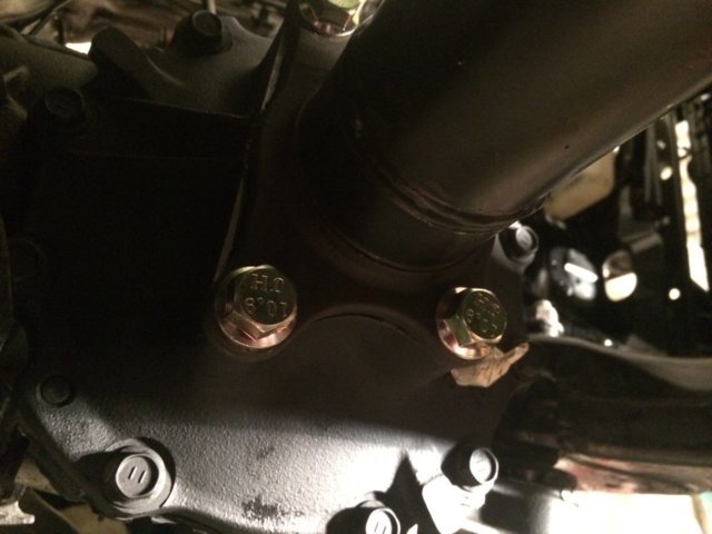

    Yes, life is good when you have these:
    1B8187E2-73A1-499F-9036-77301C6DCBE6.jpg C3D69BD6-7957-4FCB-A283-CCB2AE3FEC7F.jpg
