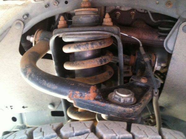

    Unless you received some UCAs for a full size vehicle, how can they be too long? That pic above is about all there is that came with mine. There are some install threads about them here on the forum. Not sure what else the shop needs to see if indeed you have the right UCAs.....sorry for the trouble with them, should be no brainer alignment. They add caster and camber alignment capabilites and toe shouldn't be an issue. Caster is the only thing that could be whack depending on what position they put the ball joint in. That part is explained in the pic above of the document that comes with. Do you have the part numbers listed on the document above?

    If SPC is facing out on each side looking at the ball joint and the nut on top is in the middle of the slot on the arm then there should be no issue getting smack in the middle of ranges of green assuming they are putting in your VIN in the machine for the specs, especially set at .85.

    Letters stamped into the flat edge of the ball joint plate. The box they came in should have been red with spc all over it too. They should be able to align the thing in green set at .85 without the UCAs even. Here's as close as I can get, see the gold plate on bottom of arm right above the tire? That edge facing the tire should have spc stamped into it when positioned correctly..........

    I bet the UCA's have been installed on the wrong sides , this would put the ball joint in the incorrect position and they would seem " too long "

    Tell them to put it where they are positioned like in the pic I posted above in post #32....curved side forward, flatter side to the rear......
