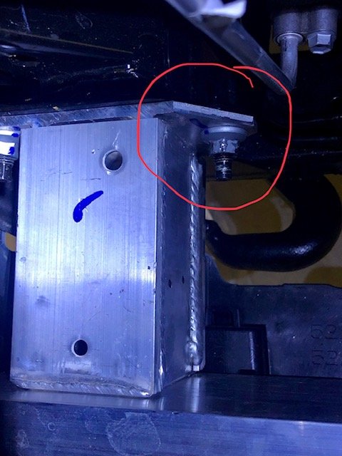

    here's the picture (not sure if I attached it right lol)… I've been looking at similar tools, but now worried that I may mess it up more or break the bolt though.

    Is that a bolt or a stud on the frame? If it's a bolt, replace it if it shears. If it's a stud then you'll have to find a replacement or drill it out and use a bolt if it shears. I wouldn't worry about it shearing though. Either way you gotta get the nut off then worry about sheared hardware.
    Those pliers will work well for this. The pliers have one hell of a gnarly bite to them which is why I used them over vise grips.

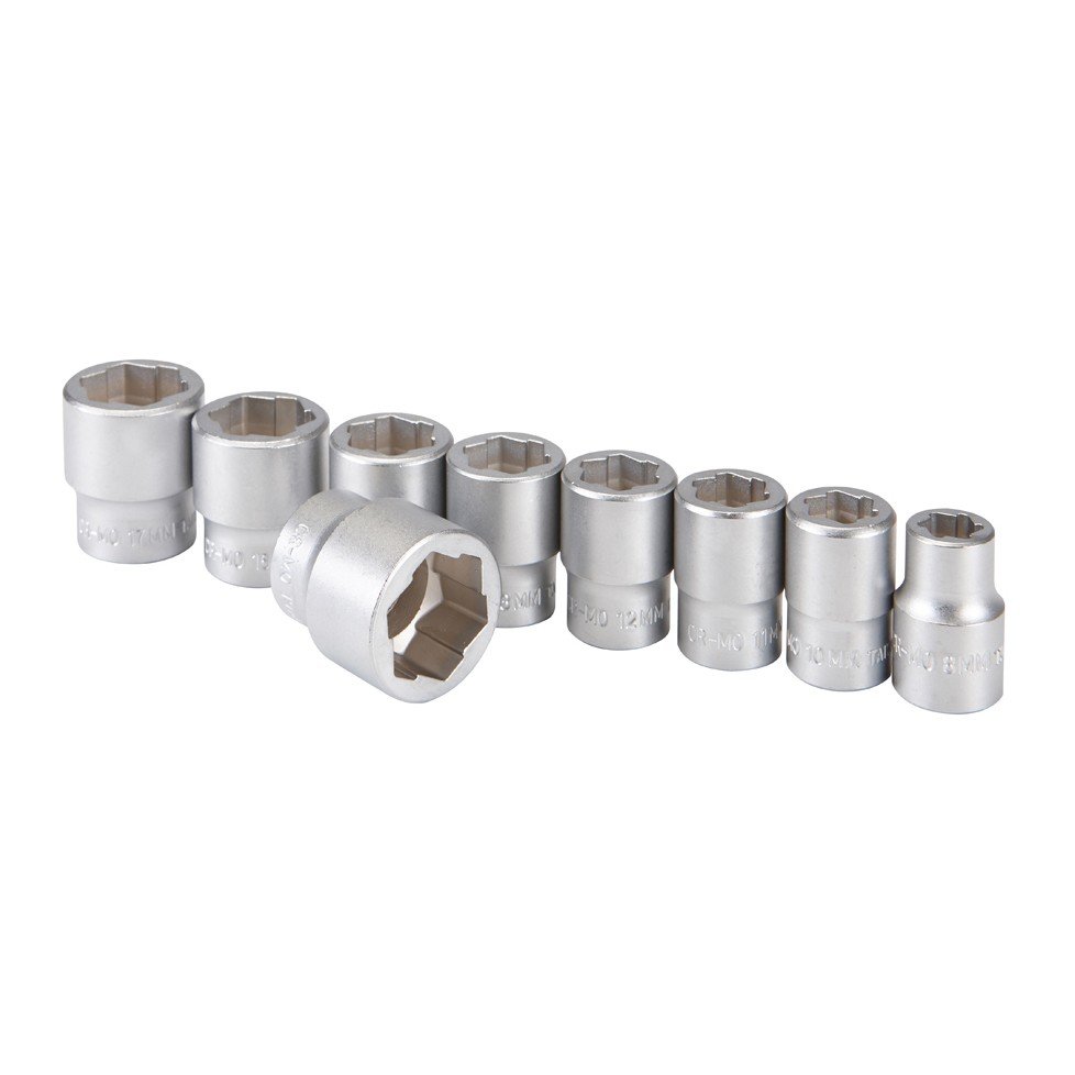

    I use these

    That doesn't look too bad... should be able to use vice grips or even channel locks. I assume you're torquing the correct direction? lol, have to ask.

    I'm not sure, looks like a flat head bolt in the other end. I'll look into this pliers. thanks.

    Only the nut comes off the aluminum crash bar. The bolt is welded in place.

    Cut it off and replace the bolt.
    I end up having to remove broken bolts, nuts, studs etc hundreds of times a year at work. If you want to use the nut / stud removers like posted above go ahead but if you lack the skills to get a new shiney nut off then advanced tools may not go so well either. Not trying to be a dick but there is a skill required to get broken hardware extracted / removed.
    If that is a serrated flange nut against aluminum with a carriage bolt on the other side cutting will be the best coarse of action.

    If that’s the case cut it off, remove the crash bar and then drill the bolt out and replace with a normal bolt.

    You can get a cheap set at harbor freight.
    Bolt extractor
    Look under specialty sockets online
