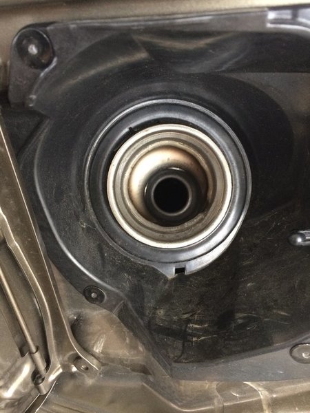

    weird one guys. 2014 DC. 6000 miles. just went to fill up and tried three gas stations. no gas will go into the tank! all appears normal. is there supposed to be a little flap over the fill up hole? the gas nozzle/handle will just click like the auto shut off and no gas will flow!

    thanks so much for the quick replys! I'm 100 miles from home in the middle of nowhere. on my way to the fourth gas station. this is so strange... I'll try the nice and slow approach. f'n weird. seems I remember a little hinged flap over the hole that seems to be missing on mine. maybe that's just other vehicles. the little details we forget. yikes. I was poking around with a pen to see if the flap was stuck in the "up" position and realized I better stop before I drop the pen in the tank. I don't need that right now.

    I filled my truck up today and noticed the flap I remembered is missing. I believe it's a case of faulty memory, must have been some other vehicle.
