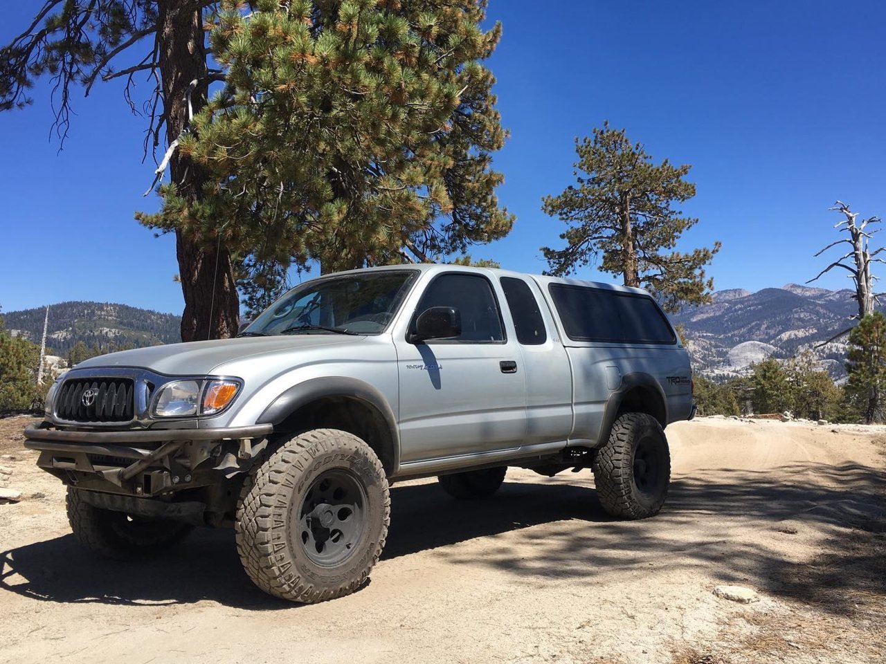

    Just wanted to swoop back in here and give a progress update...
    The Trail Gear bumper showed up last Thursday, and since I was heading out on a quick Labor Day weekend truck trip early Saturday, I decided to install it on Friday even though it's not yet powder coated.
    The install went very smooth and I did it all myself except for mounting the actual bumper, I needed my girlfriend to help hold it in place so I could get a bolt or two in it. I had it balanced on my knees trying to do it myself but I decided to just ask for a hand.
    The support/crossmember piece went on nice and easy, lined up perfectly. The only hassle was mounting the skid plate to the Trail Gear setup, but it was only a minor hassle. You just have to hold the TG nut strip in place while threading the bolts in. It helps to loosen all the skid plate bolts first so you can get everything properly in place with some wiggle room.
    Today I'm uninstalling it, spray painting the sections that "need" it (for looks), reinstalling the stock bumper, then dropping the TG off at the powder coater.
    Kinda silly to do it as I did, but the bumper came in handy several times this weekend.
    We drove up Bald Mountain near Shaver Lake, and we took the difficult route. After summiting, we headed over to Brewer Lake and that route gets very gnarly during the last 3/4 mile. I crushed the factory transfer case skid trying to make it the last 50 yards to the lake's edge, and had a few other "love taps" as well (skid plates, frame rails, drive shaft, rear diff, lol). Needed one tug on the way out, and the TG bumper's recovery point receiver was nice to have.
    So now I need to get a proper transfer case skid. But that's a story for another thread.
