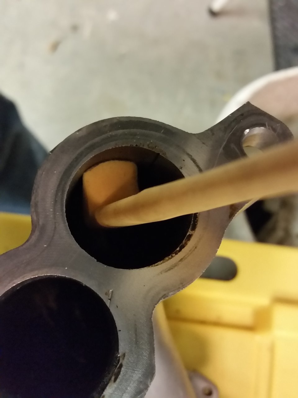

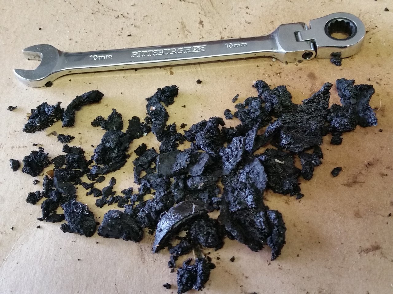

    I used an "L shaped" flat head screw driver as a scraper to reach in and pull crap out. It worked really well. Here is just some of what I scrapped out of 4 or the ports.
    I like your idea of stuffing a rag in, then cleaning and then pulling the rag out. Scrapping the heavy sludge, then Supertech spray degreaser, let is sit, then small wire brush worked great on the intake runners. Make sure you scrape as much out as you can first to keep the amount of sludge to a minimum. That makes sense about stuff burning off if it falls in. I rigged up a hose on the end of my shop vac to suck out some stuff already.

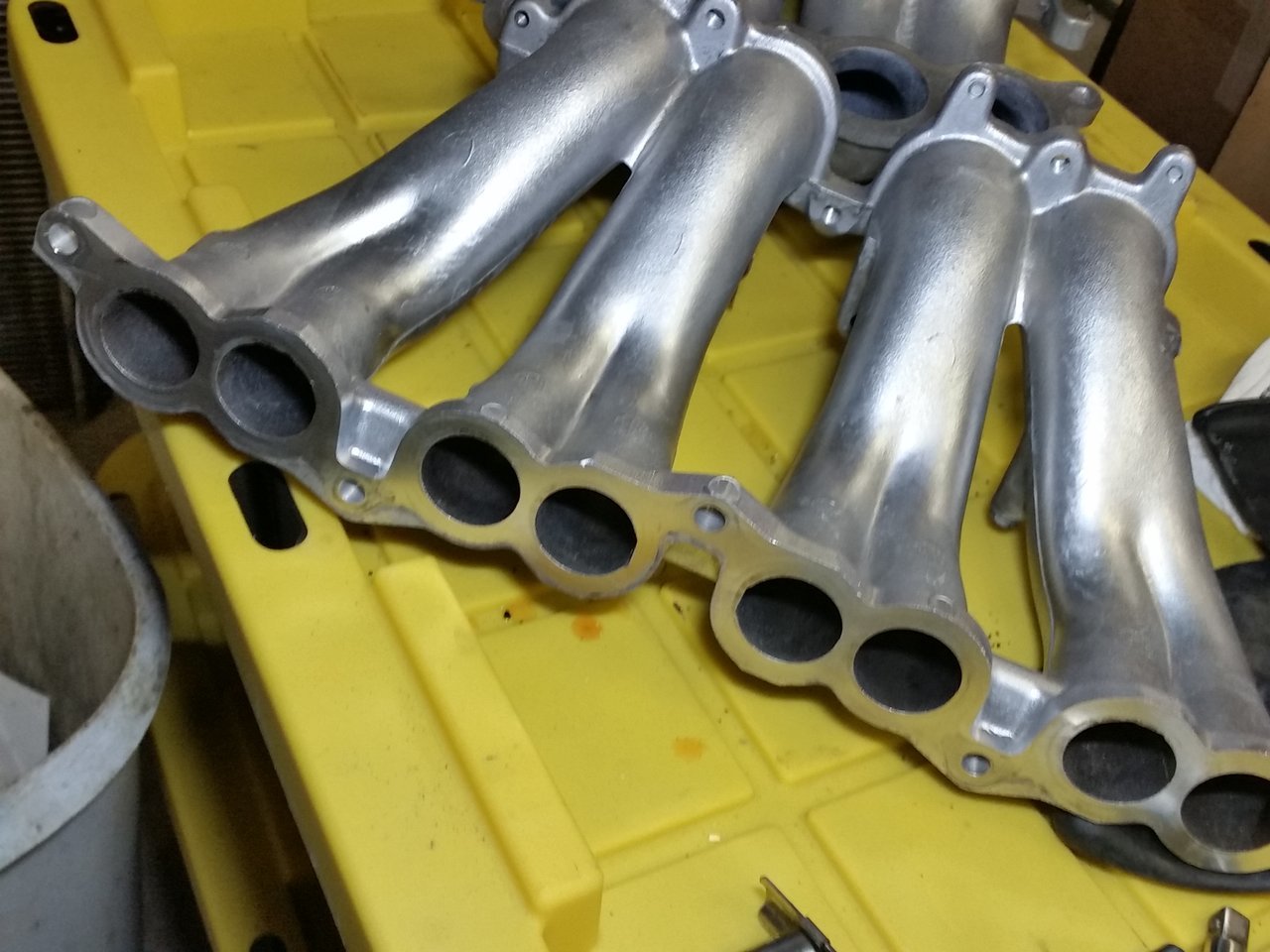

    Here is my lower intake all cleaned up. I'm very pleased with how it cleaned up.... inside and out. Upper intake looks the same way.

    Looks really good! That manifold look like new! I ended up painting mine after I cleaned it. Hopefully it sticks will long term.

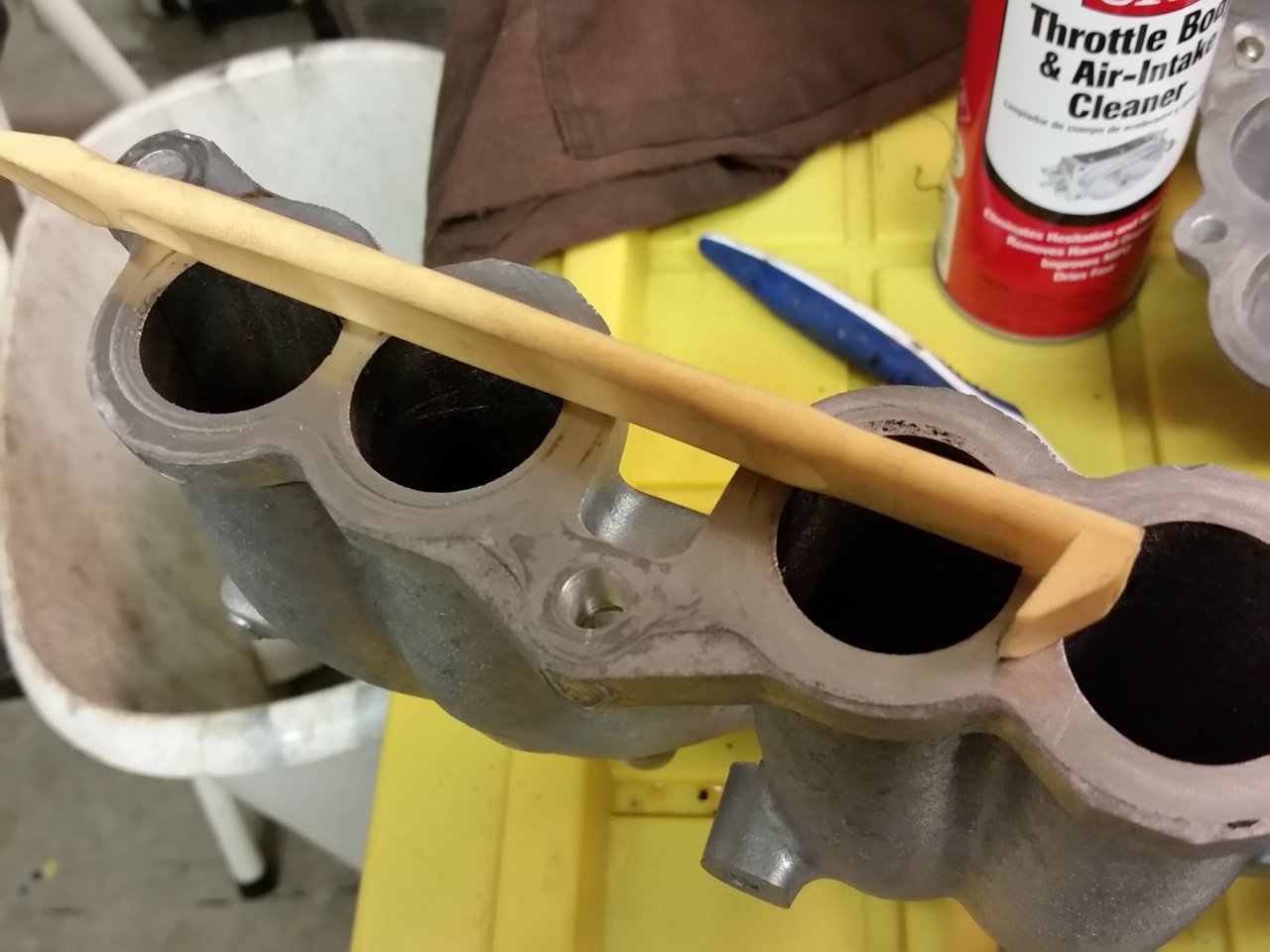

    Harbor Frieght scraper set had this scrapper that I filed a rounded end on. It should work awesome for scraping and pulling crap out of the head ports. :)

    Nice innovation with that tool. Makes a nice scraper.

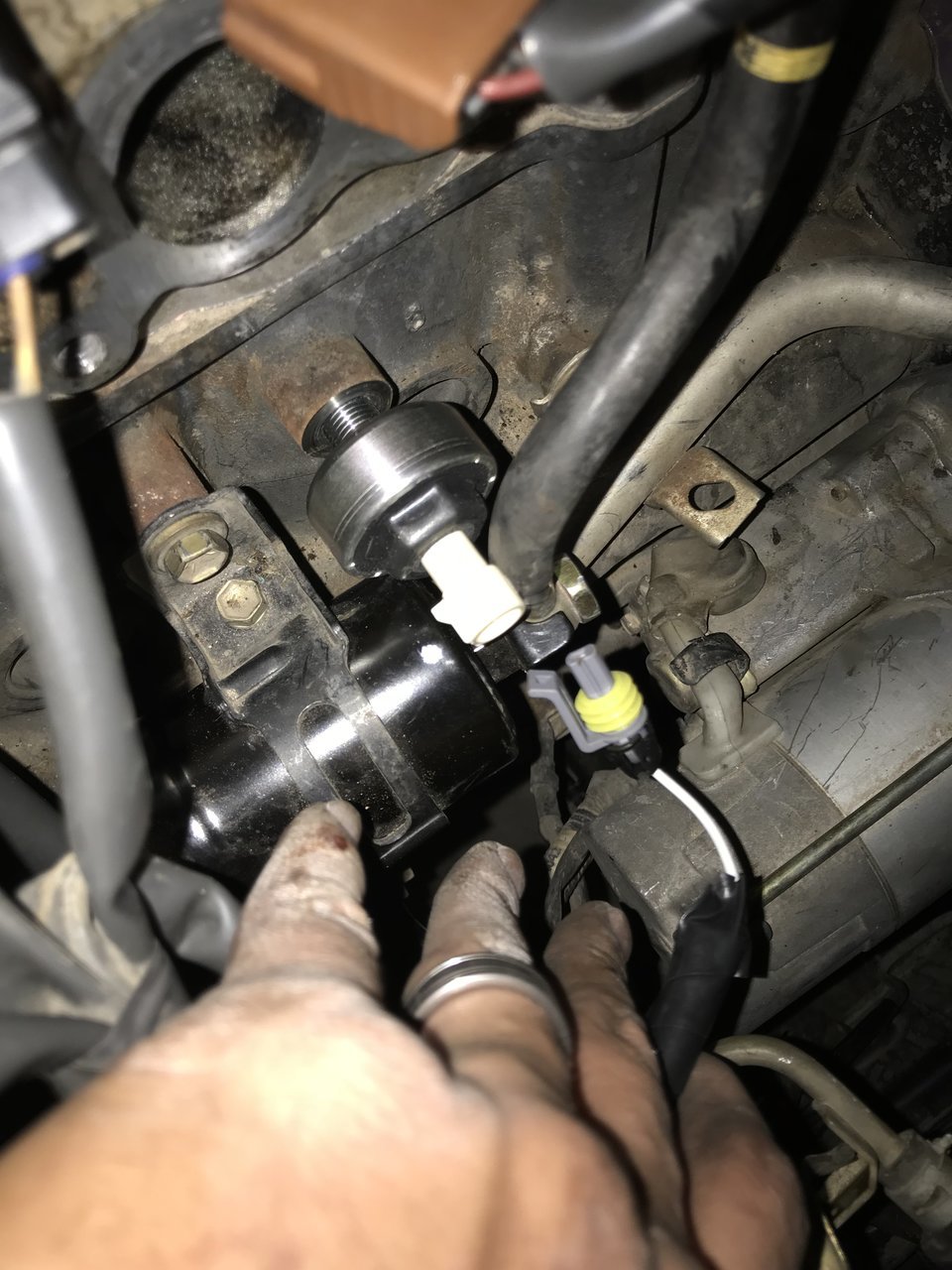

    I plan on just reusing the stock plenum gaskets, They're metal gaskets so they should be fine. I reused the exhaust manifold gasket as well and I haven't had any issues leaking. I did get a new TB gasket from Autozone, though, B/c my old one fell apart when removing it.
    I installed a GM knock sensor. I did a bunch of reading on CT that said they work better on our trucks. I also swapped out the pigtail connector for it as well in order for it to be PNP. I used these from Autozone:

    Here’s a pic of the knock sensor installed.
    You can see some of the carbon build up in one of the runners as well. Not much compared to yours but I’m hoping to clean that out today or Tomorrow

    Thanks for pic. Did you cut the end of the OEM connecter? I broke the plastic the locks mine on, so that would work out well for me. Isn't it just one wire?
