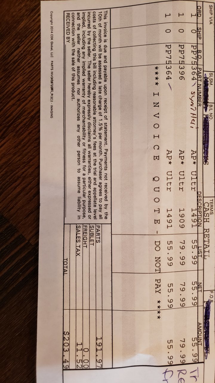

    I just got back from the dealer and their prices are outrageous. Here is their price for one quart each. I would appreciate any clarification on this. Thanks.

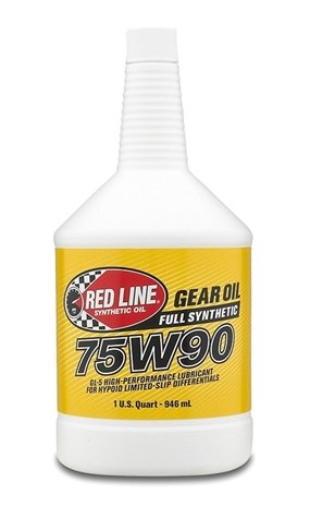

    If you want some alternatives...
    Redline makes a 75w85; lot's of guy's just run whatever 75w90.

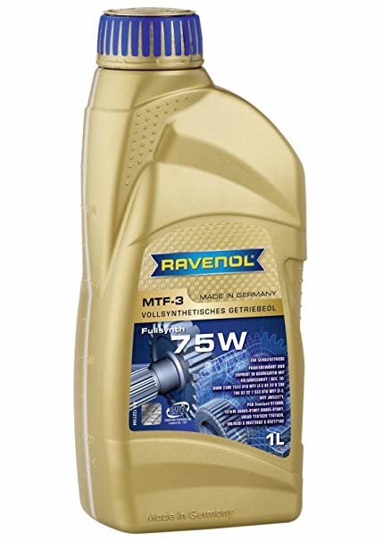

    Ravenol makes a SAE 75w; seems to be the popular alternative.

    Interesting. The fact that the Toyota crap is so expensive is a joke.

    I am gonna go with the Ravenol. Amazon Carries it for $15.96 for the transfer case.
    Ravenol J1C1003 SAE 75W Manual Transmission Fluid - MTF-3 Full Synthetic (1 Liter)

    Just as an fyi, if you did want to use the specified visc, the Redline 75w-85 gl5 is not much more; $15/qt shipped.
    I only used it because I didn't want to deal with any question about what oil I used if there are ever diff issues...
    If interested, this is the cheapest I found: Ebay 181968651033 ; $90/six.

    What he said, I use Redline 75W90 in diffs and Ravenol in TCase. Both 100% synthetic gear oils.

    I hit 40k miles and just swapped out my Front/Rear Diff, and TCase fluids last weekend. Took exactly 7quarts. I went with Valvoline 75W90 Synthetic for $12.99 a quart, and picked up a hand pump.
