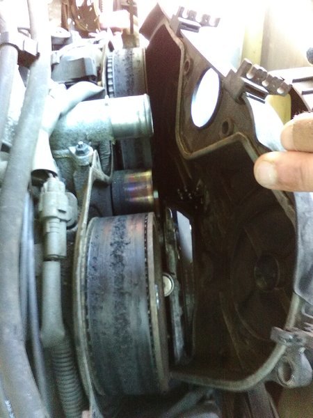

    Hi, new here and first Tacoma but not new to working on my own vehicles. Was hoping to find help with this mystery purchase. Solid higher mileage taco from cousin bought for 700!, she thought timing belt/catastrophic engine failure possible. Asked her some questions and sounds like loud metal sounds and white smoke (I'm hoping coolant from water pump failure). Non interference may have saved it. It's the 3.4 liter 5v Fe or whatever. Do I try a compression check or tear into water pump timing belt job? Oil and coolant look fine... it turns over but no start. Thanks a lot if you can make informed suggestions.

    you might be able to slide the timing cover forward without taking anything else off. that way you can see if the belt is still there. and you can manually turn the engine with a wrench to make sure it's all moving inside. if your belts are moving, everything should be ok . i would say verify that the belt is still there and moving. BUT, if you plan to keep the truck and get it working 100% no matter what, just do a timing belt and water pump service. if you don't think it's been done for a while, it probably hasn't

    Very Easy to slide the upper timing belt cover front and look.
    Perchance did she keep driving till the engine stopped??

    I have seen timing belts lose teeth but not break. So the belt could appear in tact. I dont know if its possible on a tacoma, but I usually open the oil fill if its on the valve cover and look for valve movement. I just got my tacoma so I not physically opened the oil cap. I think pulling the timing cover forward would work also. Just make sure you see the cams turning.
    White smoke would be head gasket or a crack somewhere. look at your plugs and look for one or more that are cleaner than the others. That is where your water is burning.

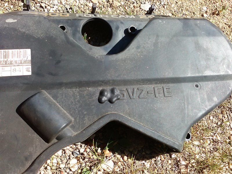

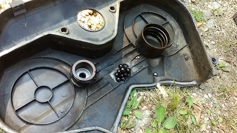

    Never seen anything quite like this, and also never more excited about broken auto parts.KIMG0246.jpg IMG_20160625_100415.jpg KIMG0244.jpg

    I could have guessed the malfunction had I noticed the grape cluster of dents on the "5vz" cover

    That must have been pretty loud till it failed
    You never heard anything or your sound system is so loud you can listen 1/2 a mile away ??

    The seal plastic melted so bearings are stuck hard on the cover. Also melted water pump bearing seals so that is stuck too.

    and you can remove those bearings, just gotta melt the plastic a bit with a heat gun. theyre not there permanently.

    Advance used to sell gates but now dayco. I was joking about the bearings bring permanent, they'll flake off with a scraper
