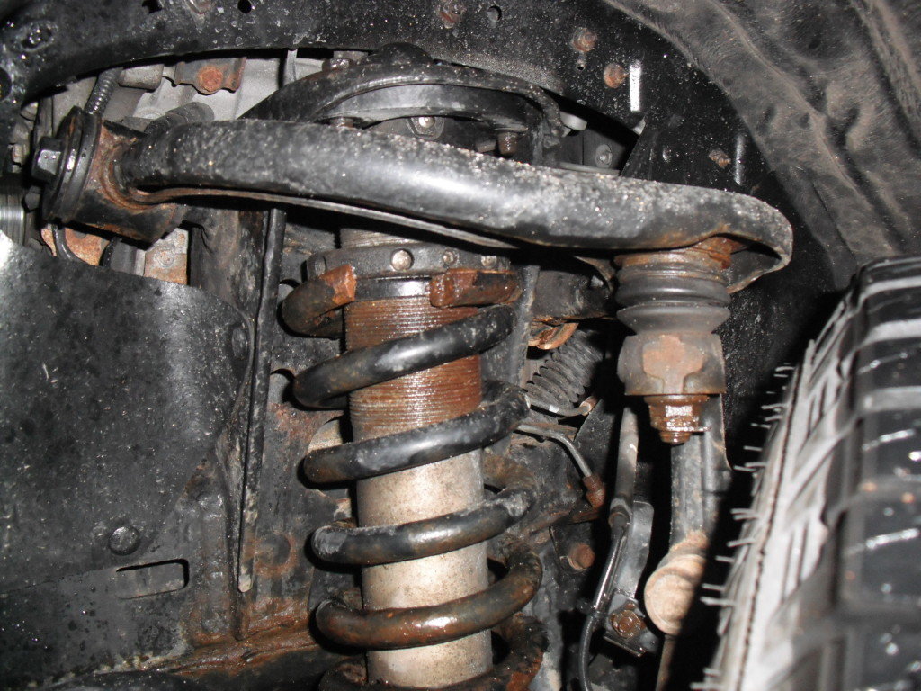

    I found out I need to have my Donahoe Coilovers rebuilt. Both fronts are leaking and I have 1 broken spring. Keep in mind I'm not looking to do any off-roading so the DR's probably aren't really necessary.

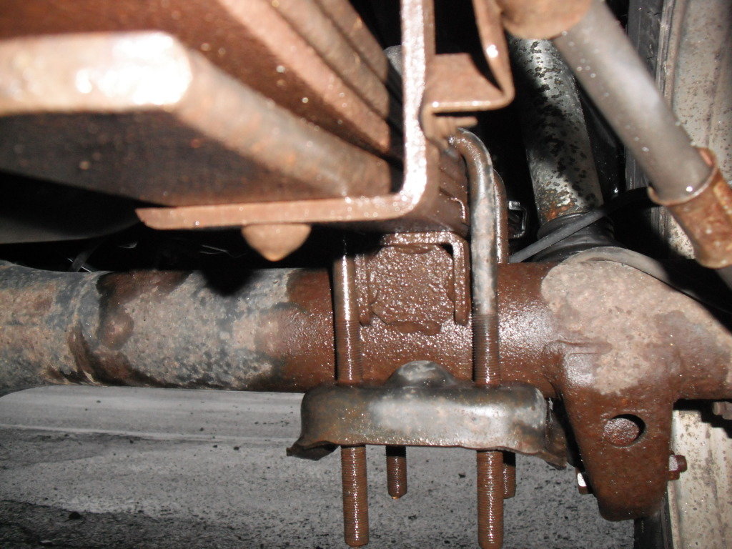

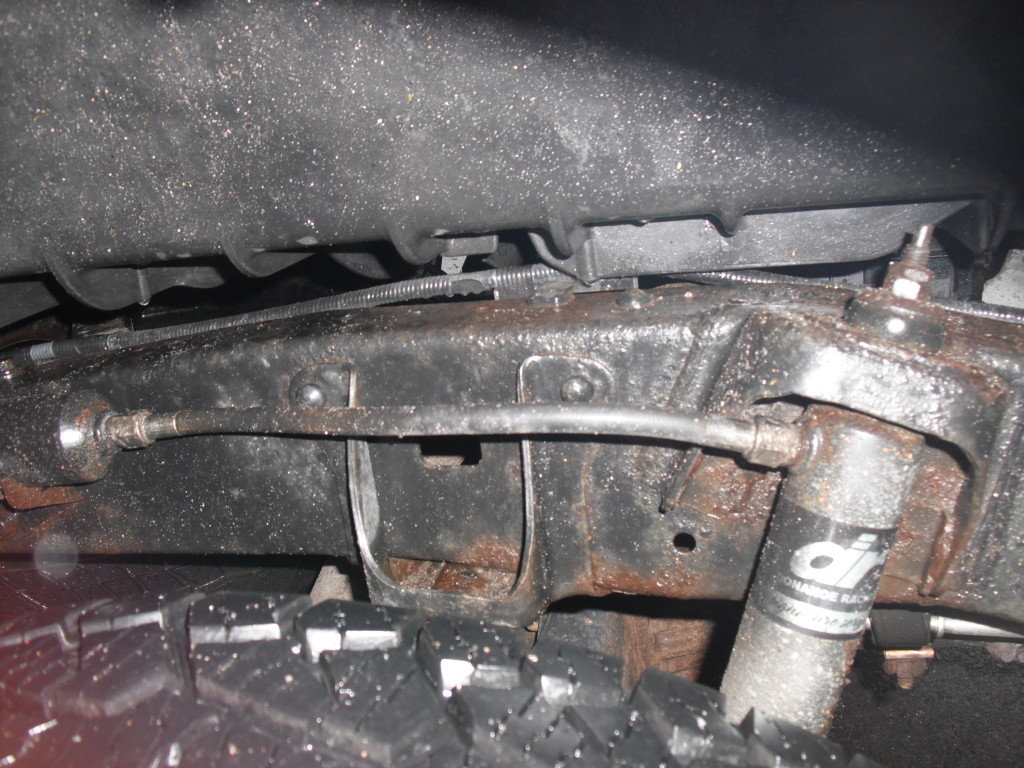

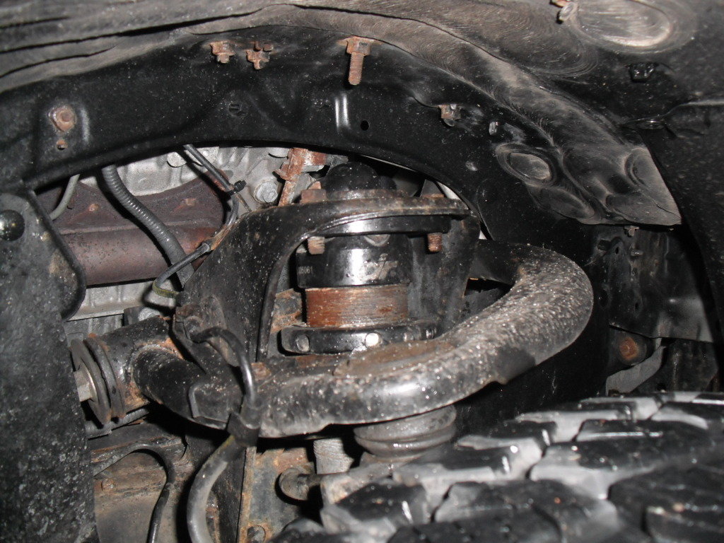

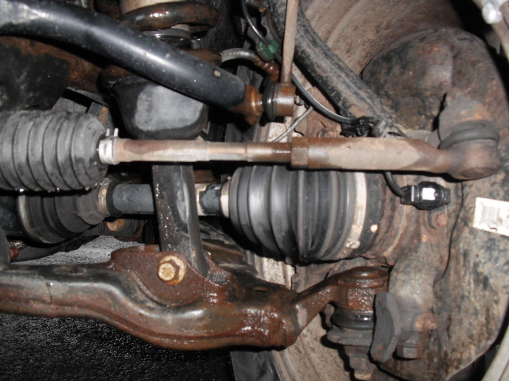

    The rear has Donahoe Racing resi's on it now. I'm assuming I can just keep them because they aren't leaking. Do the rear shocks provide any lift that I need to account for? Here are some pics of the suspension. I don't know exactly what the TSB springs look like so maybe someone can tell me if I have it or not. I'm trying to figure out if I have any lift in the back at all.
    Rear
    Broken Spring
    I noticed the new Icon's come with a sway bar relocation brackets. Do I have those on my truck and if so do I need to take them off if I go with the 5100's? Where do I look?

    The fronts look spent! It appears you have a broken coil. Don't reuse those. I would suggest complete coilovers like 5100/eibachs or OME preassemled. This would avoid downtime.
    The rears appear to have an add-a-leaf installed. Those u-bolts are long! No need to address anything back there unless you think the springs or shocks are weak. Post your hub to fender measurement to see if you have any lift over stock.
