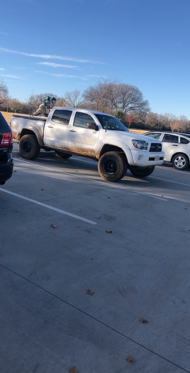

    2.5” or so up front with a 1/4” spacer on the driver side for taco lean and I have JBA upper control arms. In the rear I have the Headstrong 3 leaf AAL. I do eventually want to get the medium Dakars, and I will be switching out the 885’s and selling them soon for 886’s when I get my hybrid bumper and full skids put on later this week
