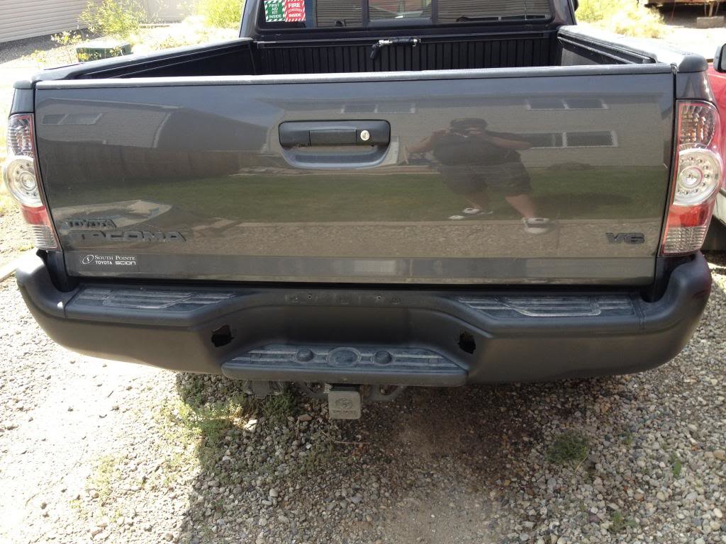

    Plasti dip. It would cost you under $10(USD), a couple of hours of your time. It's so simple. And you don't have to change bumpers.

    I did it to mine and can't be happier a year later

    I bed lined mine with spray on bed liner. There are more photos on my build page. Took awhile to get it off and remove the plastic pieces but it was worth it.

    How did you sand down the chrome bumper and did you use roll on or spray can bed liner?

    I scratched the chrome with sand paper and a wire drill brush. Then 2 coats of etching primer. Then spray on bed liner.

    If you are asking me, it was rolled on.

    Yeah, Plasti-Dipped my rear, too. Cleaned off the chrome with 409, used newspaper and taped off around the bumper, and blamo! It looks awesome and has held up very well.
