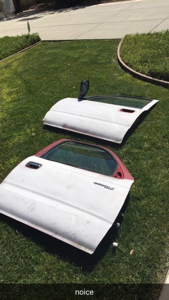

    I'm picking up some spare power doors out of a 98-99 Tacoma. Does anyone know how to remove it? I can't seem to find the factory service manual for it

    No problem I'm just picking up complete doors from a parts truck how would I remove those. Doors

    The entire door assembly including the metal frame interior and all the parts, how would I remove it from the body of the vehicle

    Got the doors, thanks guys!
    The hinges were a paint to get off the body, I had to partially remove the fenders.
