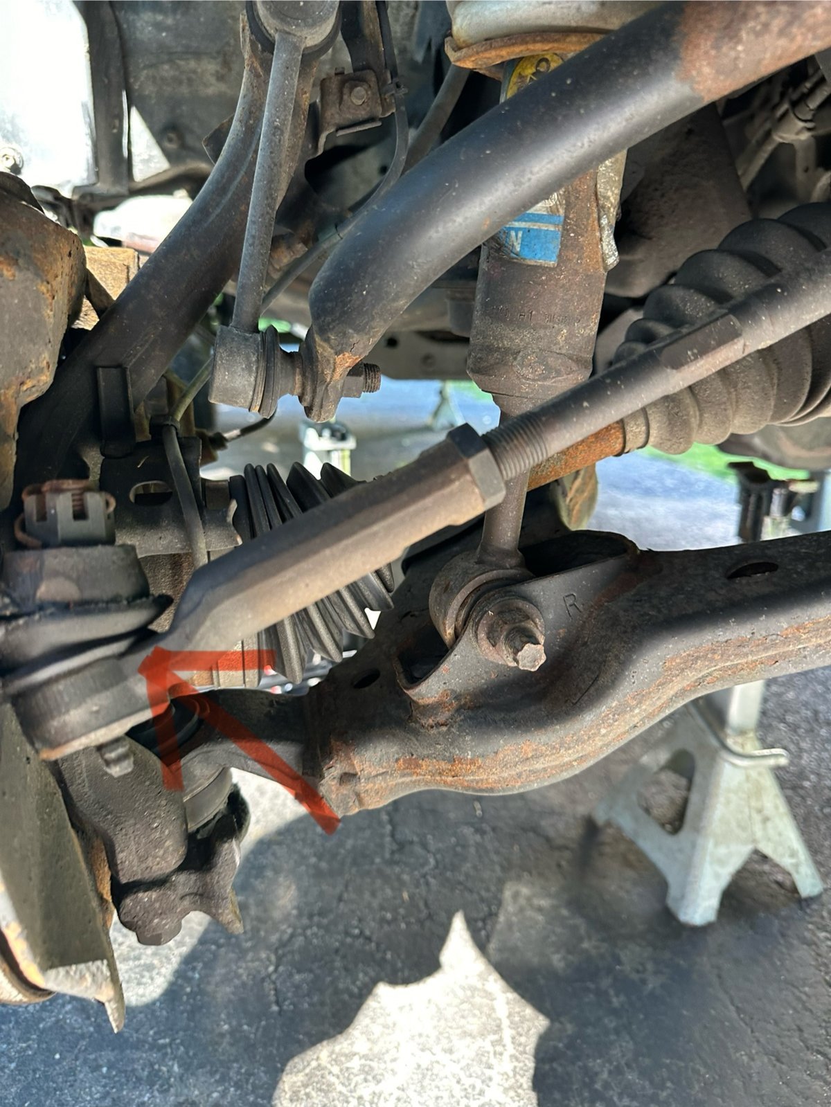

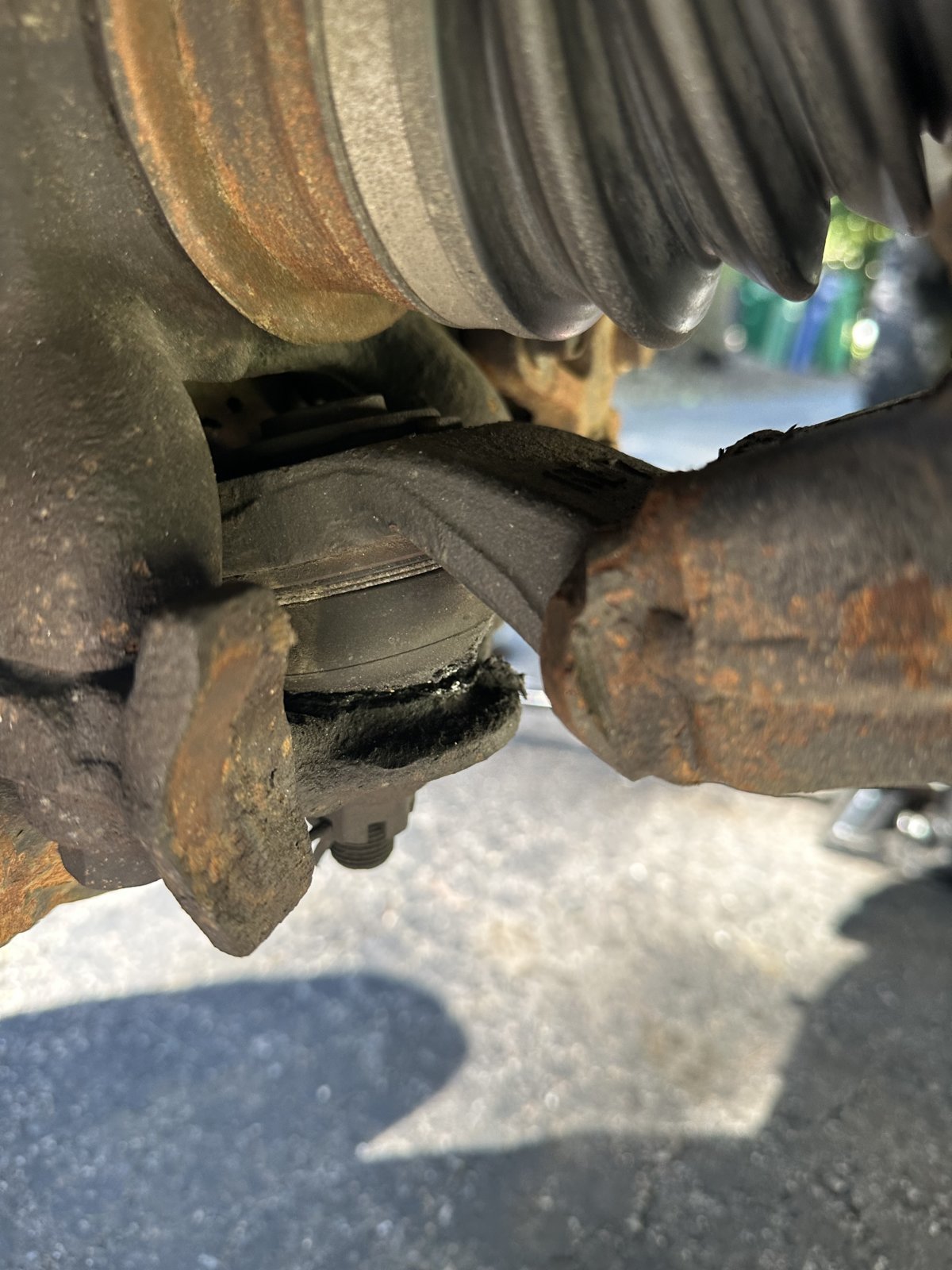

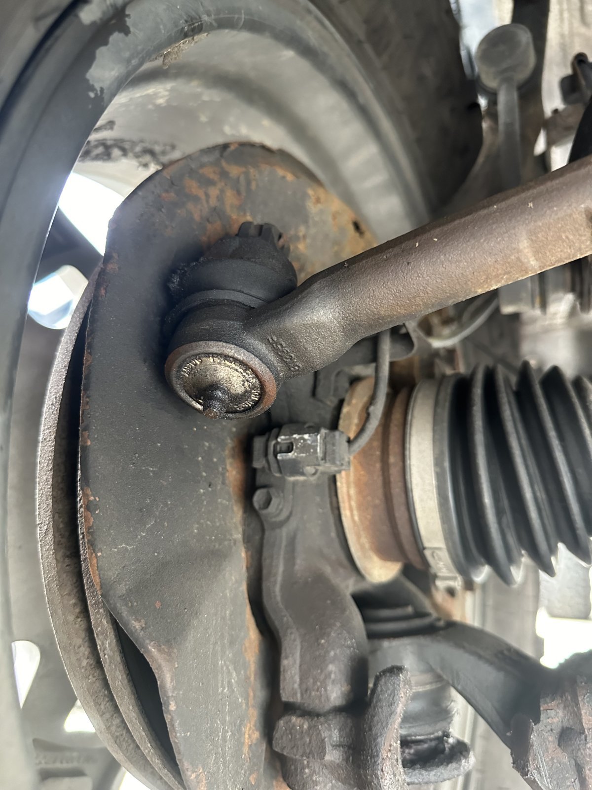

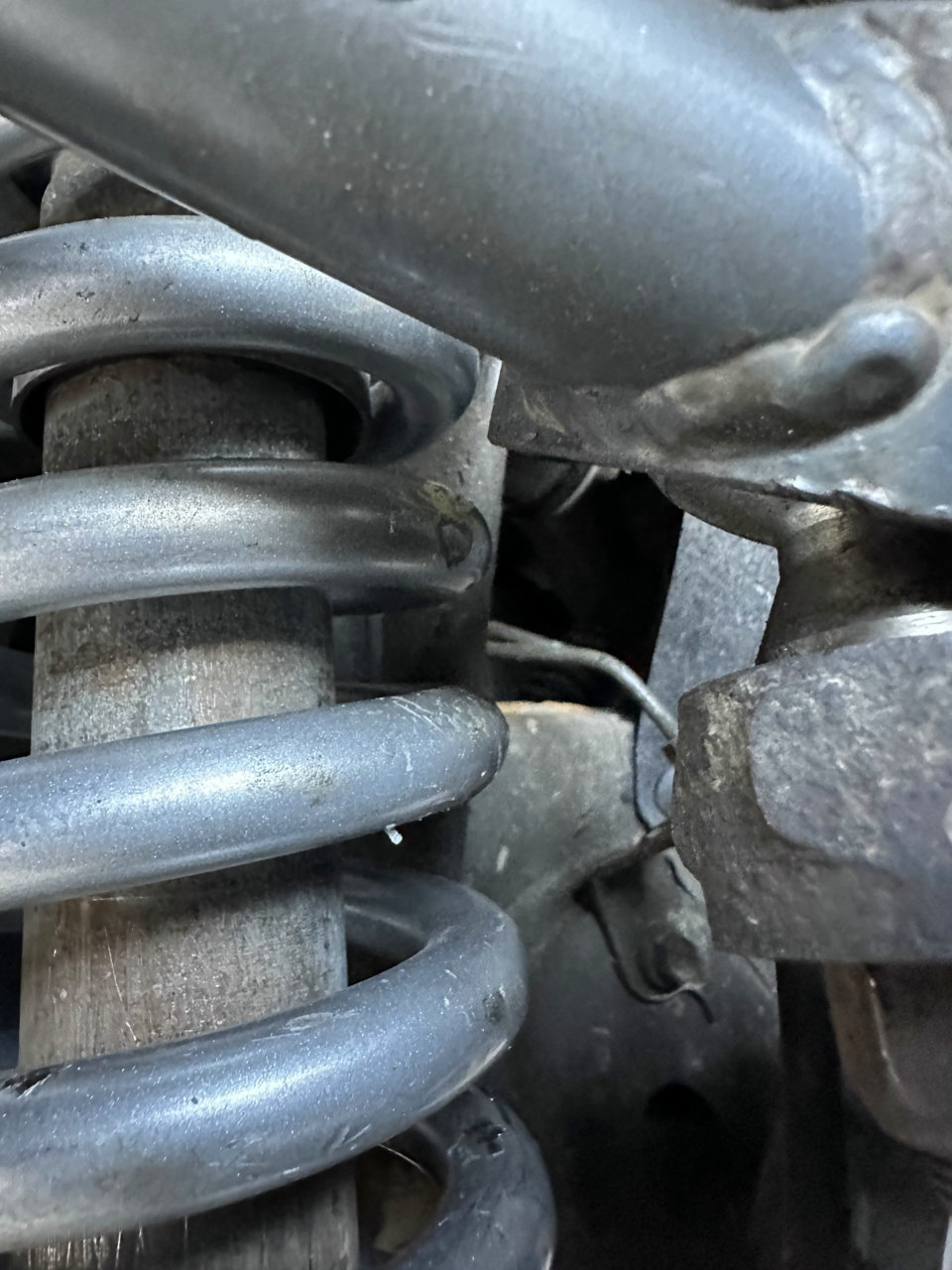

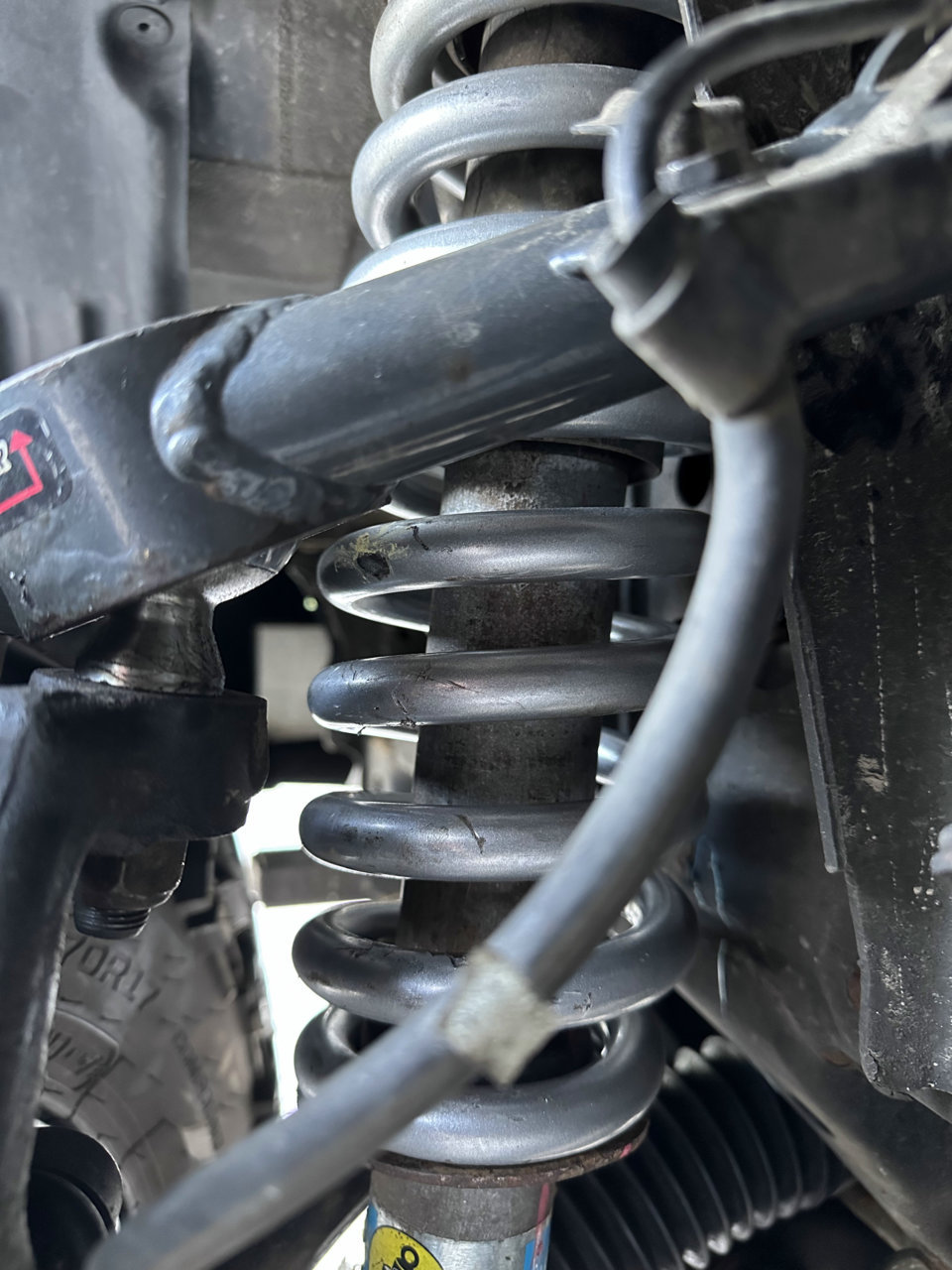

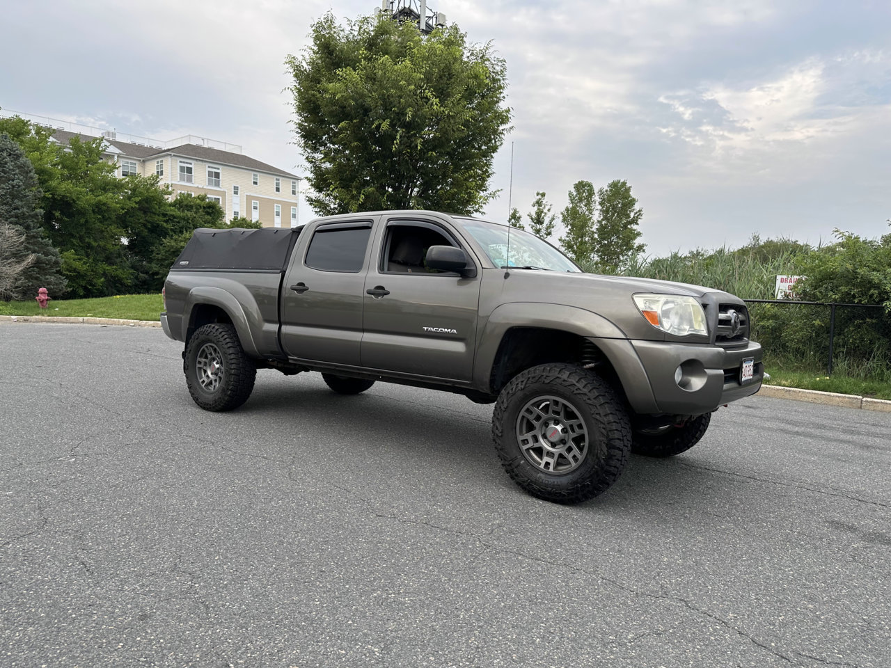

    Install went smooth, got some nice lift and clearance (more clearance than expected - should have gone with bigger tires ;))
    Unfortunately, it has been a mess with the alignment shop..
    Little story time/vent lol:
    Dropped off Wed morning. Will be done by end of day. Called 15 mins before they closed and they said they were just getting to it...ok?
    Got a ride over and receive a call when I am 5 mins away that they can't adjust the tie rods since they're bent.
    Options are a full alignment refund ($160 - which was steep in my opinion) or pay for new tie rods and wait another day. I opt to just replace the tie rods and more forward.
    Day 2, I call at noon to make sure that they give me a print out of the alignment for my records. Lady on the phone says no problem. Call at 4:30pm to make sure the truck is ready before I have to bike 30 mins there. The guy puts me on hold for 2 mins to double check. 15 mins on hold and no response, so I decide to hangup and call back. The guy forgot about me, and says truck is ready. I bike over.
    Once I arrive, takes about 20 mins for them to find my paperwork and let me pay. The moog inner and outer tie rods were basically double the price from them (I guess that is kind of industry standard?), $460 for parts & labor (1.5hrs). They said they didn't print out the alignment specs, but whatever, I already spent two days without a vehicle, I just want to leave.
    CURRENT STATUS: Drive home, already pulling to the right on a slow side street - highway is gonna be worse. I hit a pot hole and hear a loud bang - the UCA is hitting the coils. Drive on the highway and got vibrations at 60 mph + ....wheels were already balanced, but I think they rebalanced them and messed them up because they also lost the lug nut lock that was in my center console.
    So I am going to try to rotate the coil to avoid contact with the UCA, but clearly still need to have my alignment adjusted and vibration fixed. Also, I need my lug nut lock and a print out of the alignment specs. I also have a 3 hr drive tmro morning - so not an ideal situation.
    I've used this shop before and they did good work, but never going here again due to their terrible customer service, lack of communication and clearly just not giving a **** about me or my time.
    Wish me luck that I can get the alignment sorted. Not sure which adjustment would effect the UCA hitting the coil, but rotating the coil should help I hope. I think contact happens when wheel droops down.

    alignment should stop it from hitting...but then again...you have a shit alignemnt shop. I would DEMAND the "bent" tie rods back as they are supposed to give you old parts back if you ask(may be too late for that now), and I would DEMAND a print out fo your alignment. I bet they half assed it, IF they did it at all....

    Totally. I should have just found a 4x4 shop.

    Update 2 months later:
    After poking around on my front end, I realized the 5100s were at the 1st perch, causing highway vibrations, UCA contact with the coils and bad CV angles.
    Dropped it down to 0"/bottom perch: no longer had vibrations, UCA & coil are clear of each other and CV axel looks to be at a healthy angle.
    Lost about 1.5" of lift, but no big deal - my tires have plenty of clearance and no contact issues with the light off roading I've done.
    Too much droop.
    Truck has been driving great. Still a very slight pull on highway, but it isn't too bad. The tire/alignment shop said they would re-do the alignment once I had proper alignment specs for my truck and lift, but I kinda never want to see those guys again lol.
