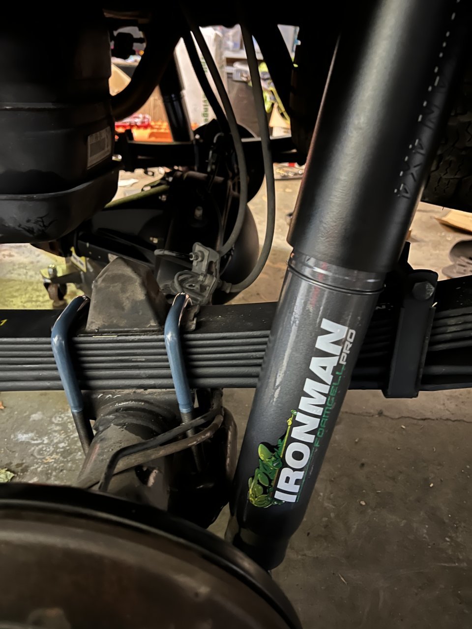

    So freaking close…..

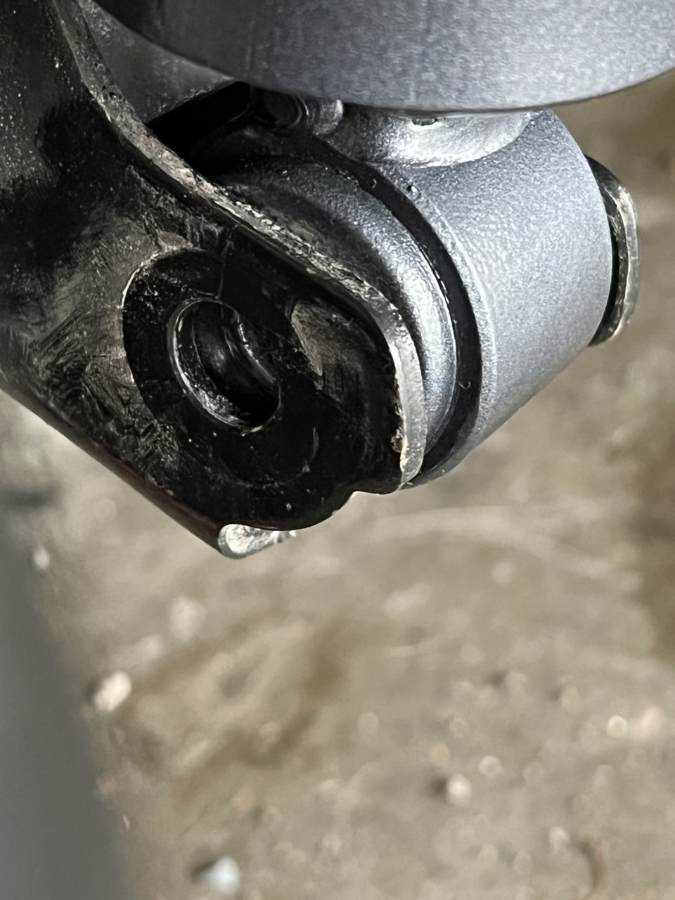

    The last eyelet is slightly off. I need to move the axle angle forward I think. Trying to figure how to do that.

    Edit. never mind! The freaking shocks are offset differently so had to rotate it. smallest font ever…
    But I’ve just a few torques away from finishing this freaking thing!!

    Is your axle attached to the leaf pack while you are trying to get leaf pack bolts in? I attached the axle to the leaf pack in the last step. The centering pin didn’t line up at first, but my buddy and were able to pull on the axle and get it to line up. No ratchet strap required.
    To get the leaf spring bolts in, I put a screwdriver in the hole to pry stuff into alignment while I pushed the bolt in with my hand. Once in, I used some gentle hammering to force it the rest of the way.

    When this happens, just jam a thick flathead screwdriver in from the opposite side as the bolt enters and manhandle it into place. You can do it I believe in you lol.
