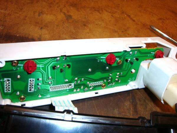

  7. Jul 13, 2010 at 9:44 AM
    scocar
    scocar hypotenoper
    Nov 11, 2009
    #25814
    39,867
    Good god this was a bitch, but I have pics in my gallery of the whole process. See numbered pix titled CDash removeal and Temp Cntrl.
    Basically, you have to remove the entire white temp control unit form the center dash, take that apart, and then work from the back of that. The brown things are the twist-lock bulbs. I think they are $9 each.
  8. Jul 14, 2010 at 6:18 AM
    jayyyg84
    jayyyg84 [OP] Active Member
    Jun 22, 2010
    #39320
    38
    joe
    atomic city
    tacoKruizer
    toyo tech coilover
    after seeing that process, which is not to bad. but looks like just time consuming and a big pain in the "dumb engineer who designed this idea" ass!!!!! ill pass on the fix till my ocd gets the better of me. LOL no wonder why them engineers are crazy!!!
