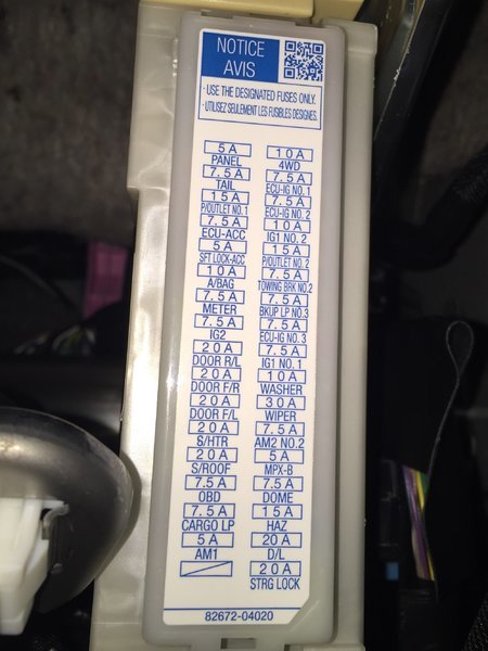

    Is there a fuse to disable the driver knee airbag?
  15. Jun 23, 2016 at 3:21 PM
    Pittrider
    Pittrider Pitty, those needing correction.
    Nov 3, 2015
    #168558
    3,883
    Greg
    B.C.
    2016 MGM LTD LB
    Do you need to know, or care?
    I'm confused, are the last 2 fuses a 02 amp fuse or a 20 amp fuse and what's an OE fuse? Lid says 20 amps but installed 02 amp fuse. Also see 5L fuses, are those for the left side of the truck? These Gen3's are gettin' worse every day. :)

    I feel the same way about OP asking simple questions, but this thread came up when I searched for what size fuses are located in this fuse box, so this thread could have been a little more useful. I took a clearer picture of the driver side below dash fuse box (junction box) cover and a picture of a fuse laying on its side. I'm not sure why Toyota made it difficult to open this cover...you do need to insert a little flathead screwdriver or something in that rectangular "hole" on the end. It's easy but not obvious.
    There's NO fuse puller in this box. Just use needle nosed pliers to grab and pull straight out. These particular fuses match the shape and size of the "low profile mini fuse" shown here: https://en.m.wikipedia.org/wiki/Fuse_(automotive)
