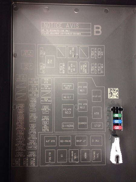

    Are there fuse box diagrams in print for the 2017 Taco? Being an old fart, my eyesight under the dash is limited.
    I gave a cursory look through the owner's manuals, and couldn't find one. If it's there, please let me know what page it's on.
    I'd be interested in the fuse/relay box under the hood as well. Thanks.

    Are you asking for something different than the diagram that's printed on the under-dash fuse box cover or inside the lid of the engine compartment fuse box?
    Pictures in post #7 and #11 of this thread we're posting in right now.
    If there's a 2016/2017 difference I don't know what it is, but look at your fuse box lids and see if they differ from the 2016 pictures.
    [​IMG] [​IMG]

    I was wondering if there is actually any printed source detailing the fuse/relay boxes that one can use as a reference.
    I would have thought that Toyota would have that info in the owner's manual.
    But I appreciate those photos you posted. I hope you don't mind that I saved the images and printed them out as my own reference for now.

    I'm hoping you guys can help me out. I'm trying to find where or which fuse manages the fog lights on a 3rd gen.
    I'm somewhat stumped with owner's manual and doing searches best I can in Tacoma World. All I found was relay in engine compartment.
    I have 2 in 1 fog /drl and fogs not working, though all is connected.
    Any help is appreciated.Thanks

    Looks like under the hood, third row from the left, bottom 15A fuse is fog lights.

    Thank you. With your help I found the blown fuse. I should admit it and buy readers... too old to see the small print on the fuse box cover.
