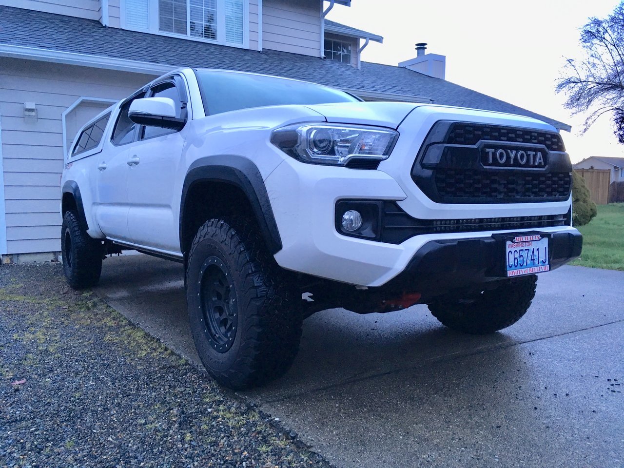

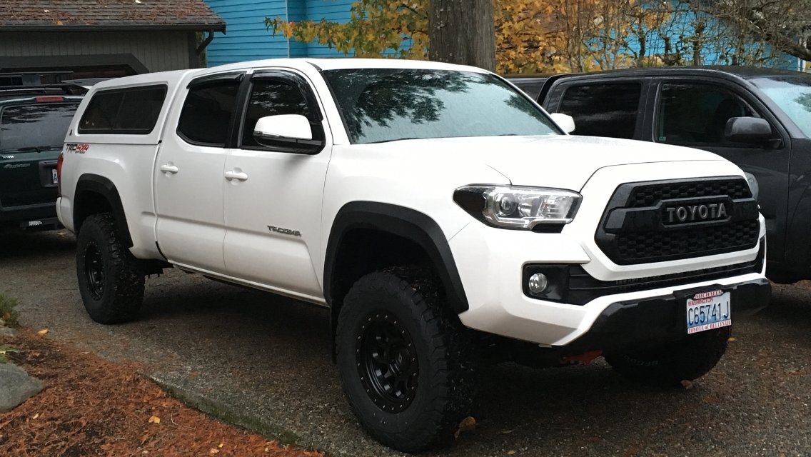

    Toytec Alumaseries Coilovers OME El111R Camburg UCAs Scs sr8 17” 285/70/17 KO2
    Perfect stance/capability IMO.
    5100 front-3rd notch
    Stock coils
    5100 rear w/ toytec 1.5” block.
    265/75/16 BFG KO2.
    Absolutely great setup for my needs. I tow a boat a lot, camp, fish, forest service roads.. no hardcore off-roading but it does fantastic on and off road. Little bit stiffer than factory.
    Hope this helps.

    Truck looks great! And I would be using the truck for just as much as you. No hardcore off-roading. Mines a sport so my guess when you say “stiffer” is in between stock sport and off road suspension. Gas mpg affected much?

    Yeah it’s stiffer than sport and off-road but very daily drivable and comfortable. I love it.
    My mpg went down 1 mpg with the switch to the 16” SCS wheel and 265/75 E rated ko2s. I drive in Seattle traffic and get 17mpg consistently and I’ve gotten as good as 22 freeway.

    Looks awesome! Any more pics?

    Thank you!

    Of course bro. Simple, clean, usable.
