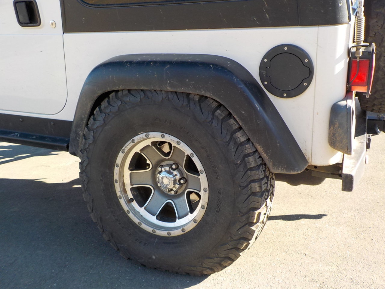

    Does it look something like this? If so you got three options.
    1) reduce tire size
    2) cut fender and body parts to fit wheel
    3) put wheels in clothes dryer on high heat for 50 minutes to shrink them down
    Option 3 is just a joke. More details on truck/wheels/rims/tires and pics would assist in helping you, Sean.
