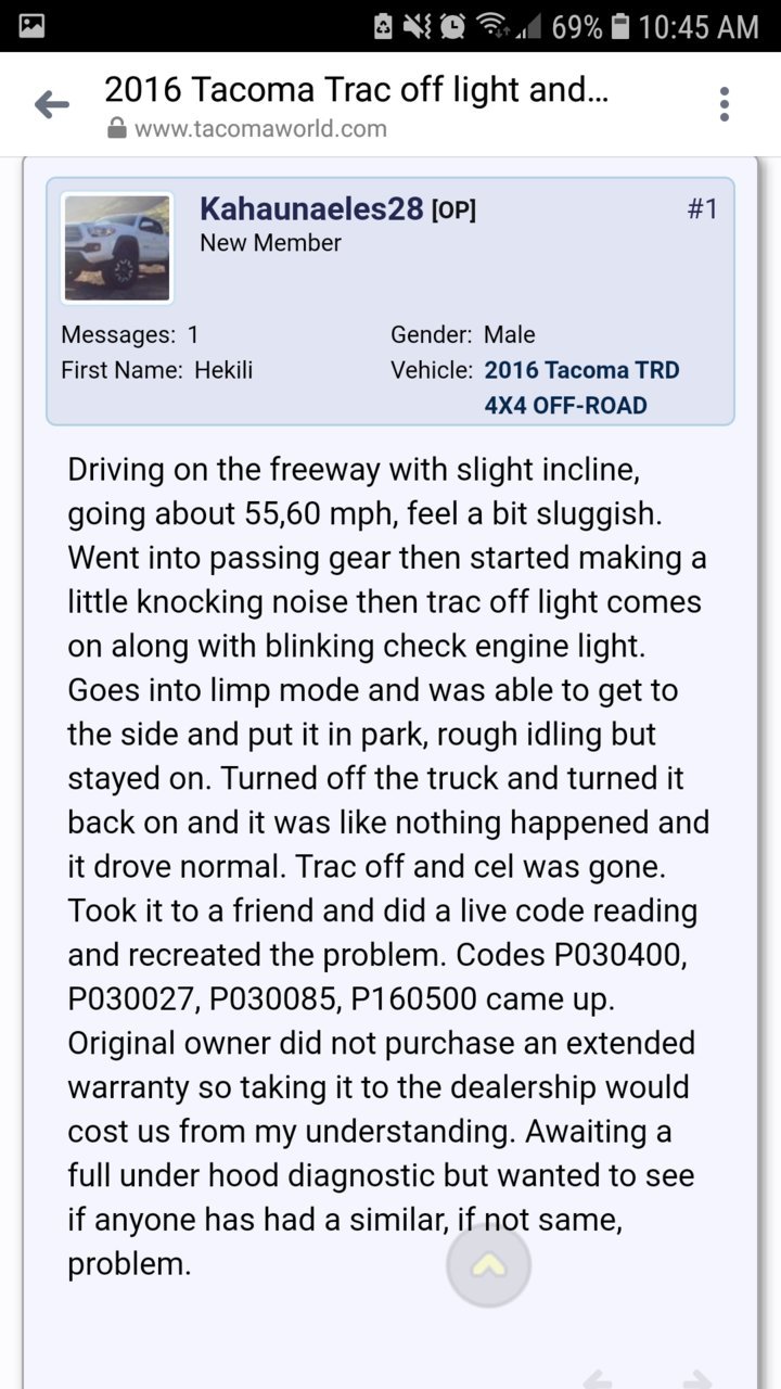

    This guy has had the same exact problem!

    From what I remember, it wasn't a good diagnosis in that. Engines have been replaced or cylinders and heads have been replaced on a few of these types of threads.
