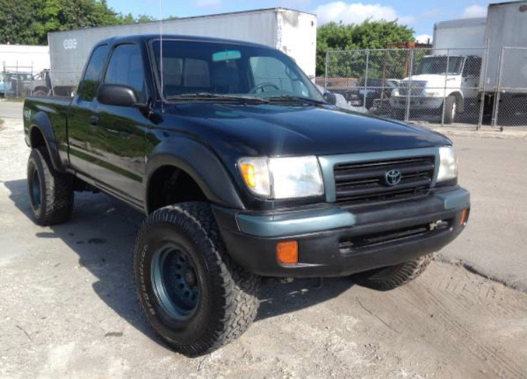

    Ive been looking high and low for a decent first gen.
    Criteria is that its a manual trans and around 150k miles or less..... yeah. good luck.
    This is a 98 with 160k miles on it.

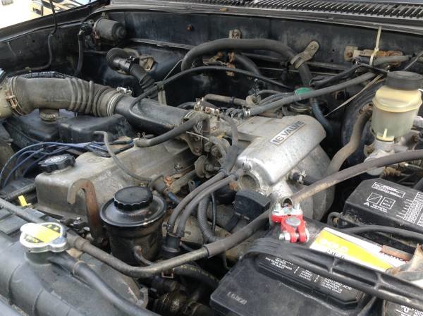

    I have some concerns about the four banger (3rz).
    How will it handle some ~32-33" tires?
    -I'm not looking for a rocketship, but i need it to get on the interstate and get up a hill.
    How does it cruise?
    -I'm not particularly interested in a vehicle i intend to overland later in life.... that cant comfortably cruise 80 on the interstate. yes I know this depends on gearing so lets not get too specific. I believe it's a TRDOR, 4x4 obviously.
    How's the power?
    -similar to above but I want to know if I can ride with the AC on without it needing a constant supply of nitrous lmao and without overheating it if it idles in the drive thru for 10 mins.
    made there any sensible power adders?
    -namely forced induction or other mods that actually make a difference without requiring a ton of investment. Again, sorry if this is ambiguous, so just generally speaking.
    How does the 3rz take miles? is this truck "long in the tooth"?
    Please contribute anything else you have to say, I would love to hear what other owners have to say about their trucks.
    Forgive me if any of my information is wrong. I'm a second gen guy and im doing my best to learn the ins and outs of these 1g's.
    If anyone has the ability to check the VIN out, it is: 4TAWM72N5TZ131789

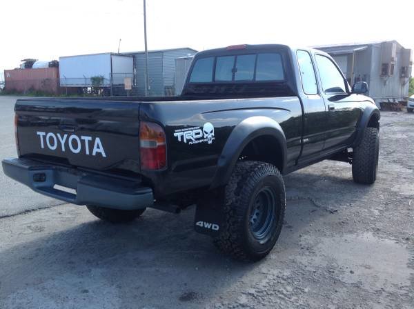

    another.

    It appears to be leveled. I hate the fender flares and the color coordinating trim lol but some things cant be all that AND the chips.. hahaha

    The TRD stickers are not from Toyota.
    I believe TRD OR designation was first used in 2000.
    Does it have a Diff lock switch on dashboard?
    150,000 mi is not too high depending on price, location and maintenance records. Run the VIN# for wrecks and check on Toyota owners website for Dealer service records and recalls.

    frame rust is good. its clean down there. florida truck its whole life, and not near the salt it appears.
    Yeah those are definitely not factory.. its the "punisher edition" lmao. debadge asap.
    I know about the rusting issues. I have found a ton of trucks but once i see that brown devil... goodbye. this one seems alright.

    Thats not bad miles for a 3RZ. But its not gonna be fast. 80 on the interstate is going to be a stretch.
    With larger than stock tires, regearing is going to be pretty much required . At least its a stick tho.

    I’m a little confused. Help me out. Highway speed is determined solely by RPM in the case of the truck considered. Are you saying the truck is not going to be able to overcome the resistances in its final gear, thus causing me to use 4th always? Or are you saying that it will be screaming? Because if the latter is the assumption, larger tires would help. Please don’t take this the wrong way I’m genuinely curious. My 2nd gen would do 85 if I wasn’t careful and they’re... not fast by any means. I’m trying to get a feel for what a I4 truck would feel like. I’d prefer not to regear.. it’s not locker version so can we determine what the ratio is from the fact that it’s just a 4x4?
