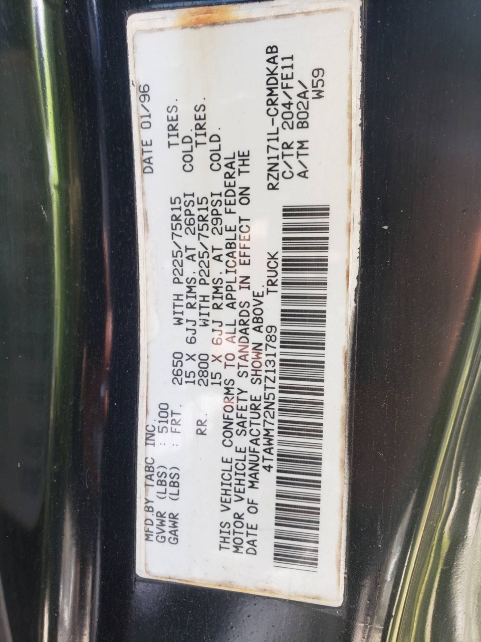

    B02A is 3.58 gears, open diff.
    W59 is the transmission.
    3.58 gears, 2.7l, and 32-33” tires is going to be a fucking dog.

    I mean, it’ll drive down the road, but you’re gonna struggle to hit 80. Any hint of a hill you’re gonna be in 3rd gear with the pedal to the floor.

    And it's not a 1998 as OP stated
    January 1996 is date put in service according to door sticker.
