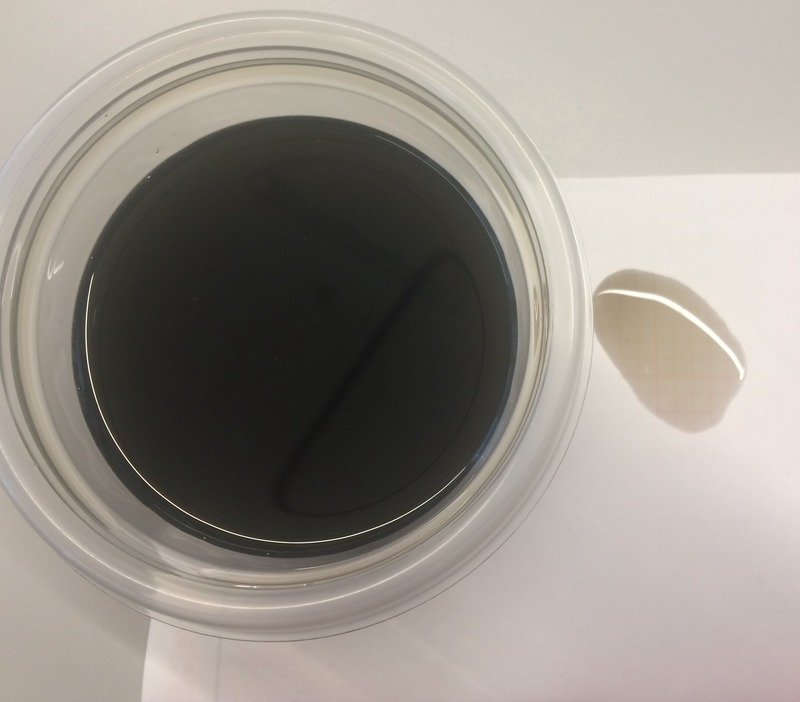

    The title says it. I have a howling noise coming from the front end that I can't pinpoint and sounds like I'm running mud tires.
    It increases in volume with speed and is fairly constant, but mostly goes away when turning right. There is no change when turning left and no change between 2wd and 4wd operation. At first, I thought it was tire wear b/c of worn shocks however, after replacing the shocks, having it aligned and having the tires rotated, there was no change.
    Two years and approximately 60K miles ago, I replaced the front diff side bearing with the ECGS bushing, replaced the CV shaft and replaced the diff lube with Mobil 1 75W90.
    My thoughts at this point are that I either have a wheel bearing that's bad or a diff carrier bearing going bad. Last night I jacked the truck up and spun both wheels and didn't notice that one was turning rough. I also replaced the front diff lube, again with Mobil 1 75W90.
    Since I don't see much gear lube, I'm having a hard time deciding whether the color of the oil I drained is "normal". (pic posted below) There was some paste on the drain plug and a couple of small pieces of grit/metal stuck to the magnet, but not enough to make me think that there was a major issue afoot.
    Any help you could render would be very much appreciated.
