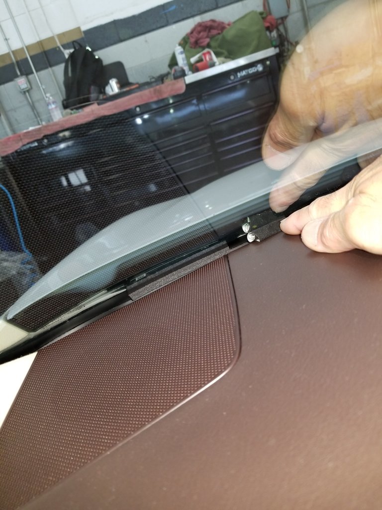

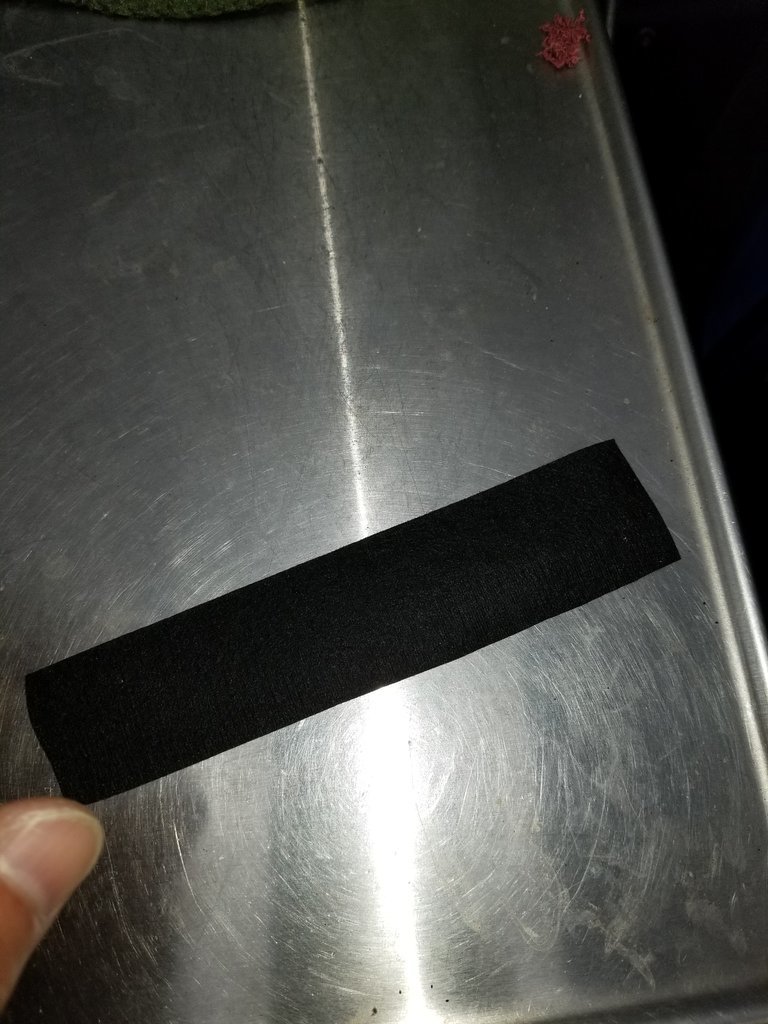

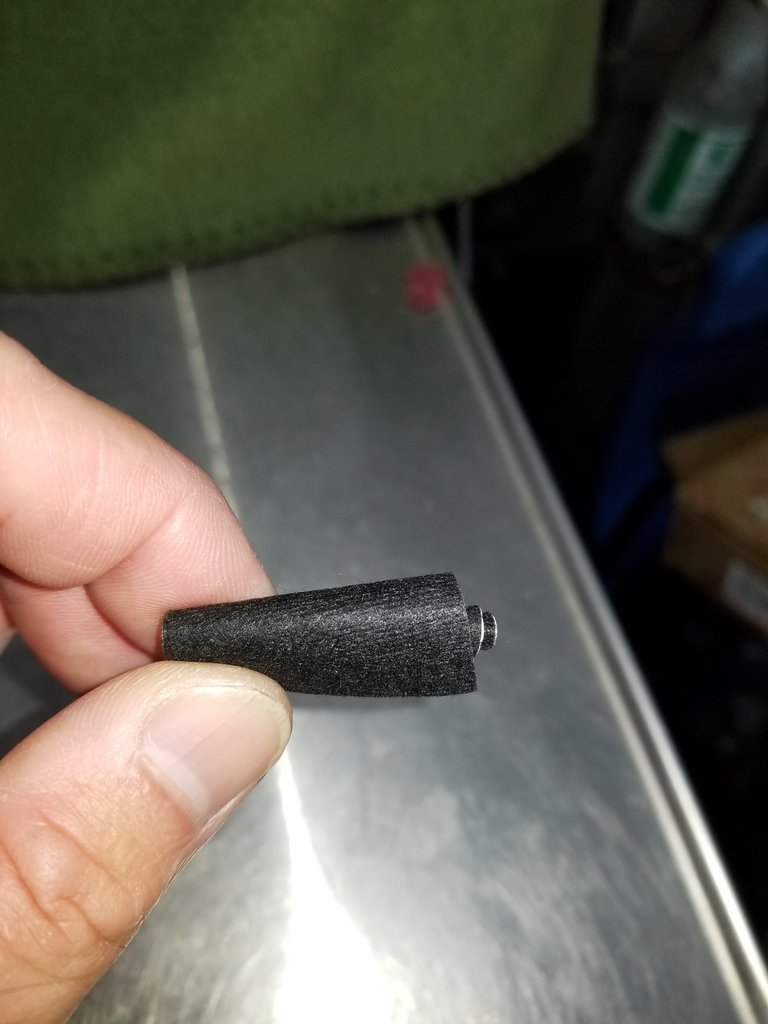

    To fix that dash rattle. Get some felt and roll it up small and shove it between the dash and firewall. That should take od the rattle. Might have to do 3or 4 small rolls of felt because they dash is held in with clips guide pins.
