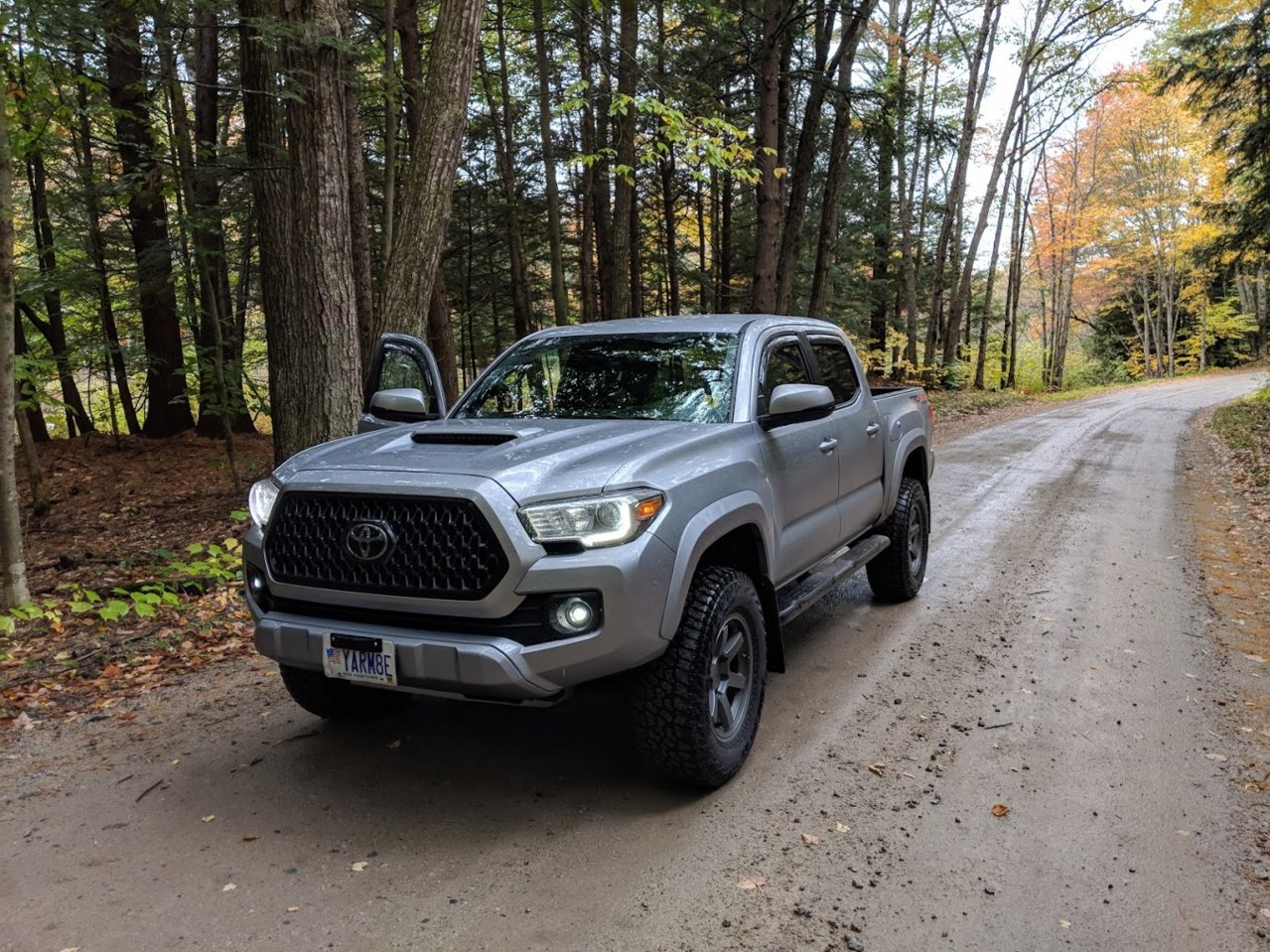

    Here's the build with before and after pics. I've updated it regularly as the time passes, still very pleased with the results and it's been more than adequate for what I need.
    https://www.tacomaworld.com/threads/dclb-with-885-springs-5100s-at-0-and-3-leaf-aal.502144/
    Here's how it sits after 18 months
    For your budget I'd still go 6112/5160 and stay at 2 inches with a 265/75/16 tire. That size seems to be the sweet spot for driveability, performance an reliability. Go any bigger and you can really go down the rabbit hole in money and mods to make it work.

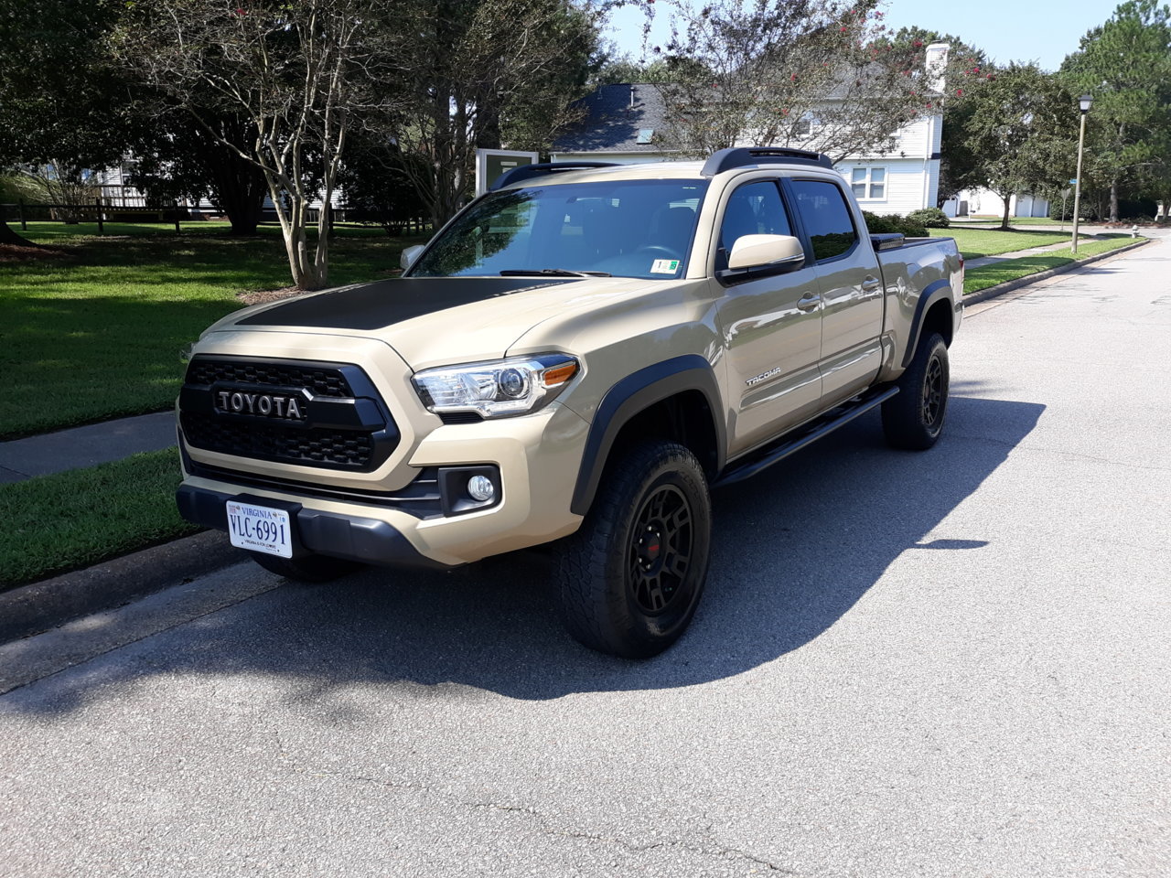

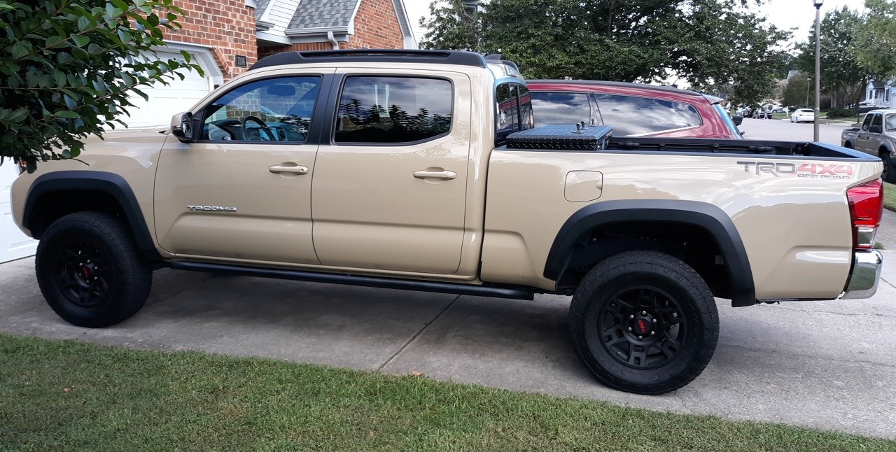

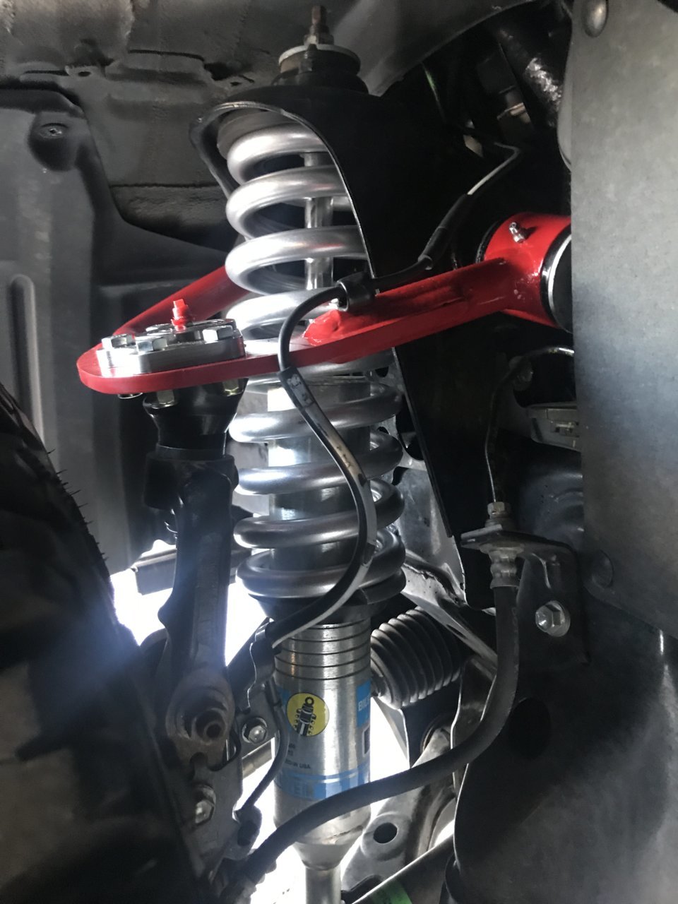

    OME 887 coils with Bilstein 5100's, set at 0, 1/4" driver side spacer up front for about 2" front lift. Wheelers 3 leaf add a leaf in the rear with the overload spring removed and 5100s in the rear for about 1 1/2" rear lift. Cost me about $950 in parts. Did the install myself, thanks to this site and Youtube U! Local alignment shop, Joe's Alignment in Blythe California did a kick ass job. I have a trip through Colorado, Durango to Silverton, and about 15,000 miles on the lift now. I still go out in the garage to drink a few beers and look at it. Oh it rides a little better than stock in my and my wife's opinion, highway ride. Off road, it handles the wash board roads a little better but it isn't a Raptor by any means. I love it.

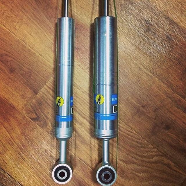

    6112 on the right, much bigger shock with more oil and cooling capability so it's not going to fade nearly as fast as a 5100 on something like a washboard surface.
    ejewels[QUOTED][OP] likes this.

    The 5100/887 vs stock. I had my doubts, prior to install, that these were going to give me any additional lift. But sure enough I got about 2 inches. I guess they are firmer.
    ejewels[OP] likes this.

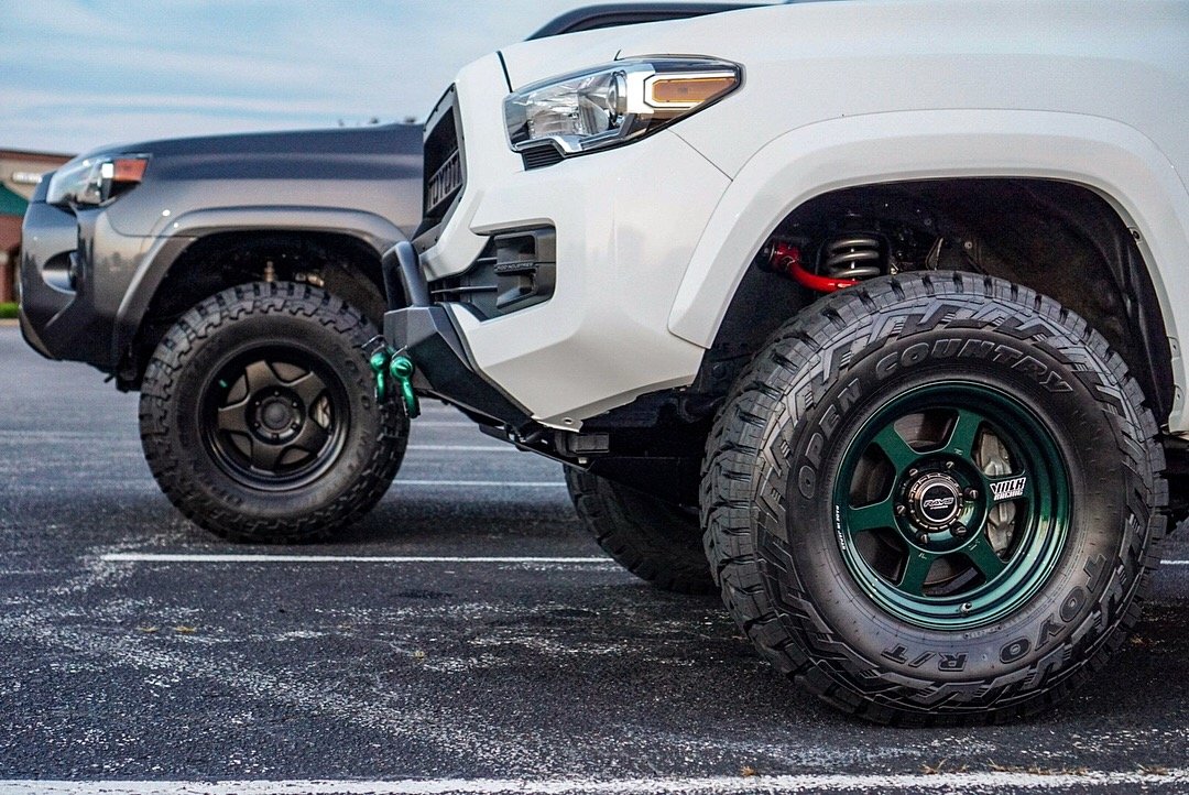

    Bilstein 8112/8100, JBA UCAs, Icon RXT leaf pack, work wheels 17x8.5;-10os, 285/75/17 cooper LTX AT3, Mobtown HC rear bumper and Sliders, SSO front bumper, BAMF greceased grill.
    P

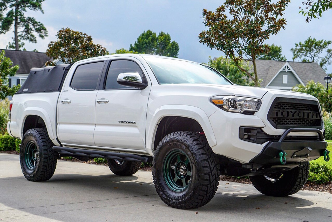

    Plenty of people offroad in the 5100/885/886/887/888 combo and plenty just run them for the look on the road. Nothing wrong with the setup, but once you outgrow them and start doing things that weren’t meant for the setup, it’s no longer a good choice.
    As far as headstrong goes, they admit and said it multiple times, 100 and 100s of people call everyday asking what setup to buy and the numerous questions of a lift and ask the same questions all day everyday, they would be on the phone for 30min plus with each customer. It’s easier to email, copy and paste answers and reach everyone all at once. Although I understand it can be frustrating from other point of views.
    To the OP 2” is plenty of lift. The lifts you see that are 3” lift, theyre maxing out their preload on their coilovers. No setup should be maxing them out. It’s exremely hard to reach a 3” lift and have a comfy ride as most setup will settle. You will have to sacrifice something either way. 2” lift is perfect, 3” is more for looks at that point as Your not doing any crazy off-roading.
    6112s on the highest 6/5 setting with 650lb coils that I switched out from the 600lb spring it comes with. I have 2 1/4” of lift up front and 3” in the rear using icon rxt leaf and 5160s. JBA UCAs, 286/75/16 Toyo RTs. I like rake on my trucks,. I’m preparing for a steel bumper and etc so it should come down about .5-.75” in the rear. Also did the ECGS upgrade.
    6112 is a good setup for your needs unless you absolutely want more than a 2” lift. They will take you anywhere and everywhere.
    Good luck on your decision! Lots of good setups!

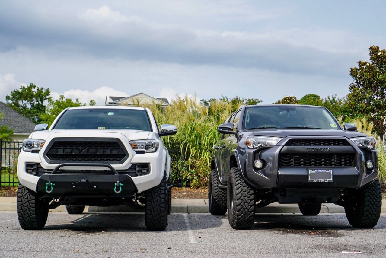

    Also this is my truck against a 3” Icon lift on his t4r with 34” tire 285/75r17 with wheel spacers.
    el taco pastor and ATdivide like this.

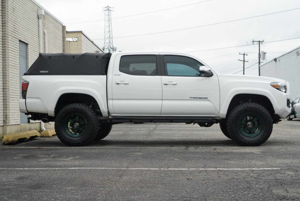

    I have the 5100s, OME 884, 1-1/2" AAL and a 1/4" spacer on the driver's side for lean. I did it for to help out on sketchy camp roads as well as for looks. Did the install with my cousin, then an alignment the next day. No issues here.

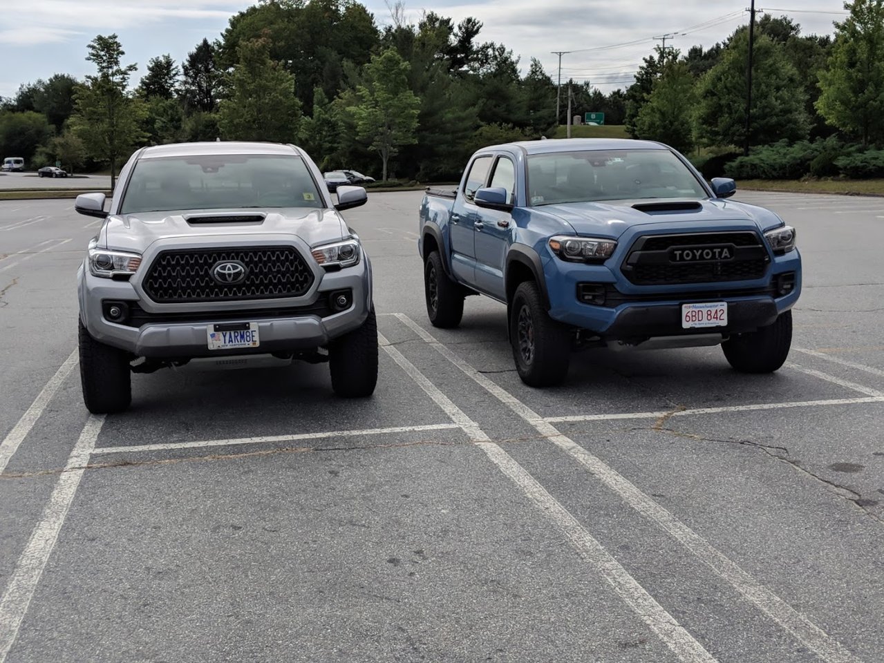

    Next to a Pro:
    TacoBlancoOffRoad and jsinnard like this.

    Original post edited for those who want to see a 4” lift vs 2” and Thank you!!!!

    I thought my post would steer you to the 6112 assuming the extra money cost vs the 5100s isn’t a deal breaker. 6112 is a better system comparing the 2
    6112 come with a 60mm piston with a 2.65” body, more oil better cooling, same size piston as a fox, icon, king piston, vs 46mm piston of the 5100 meaning 100xs Better ride and can take bigger hit off-roading if you hit a dip or pot hole. 5160 is exactly like a 5100, but it has a rear resi for more oil meaning better cooling capacity and allow more travel while off-roading.
