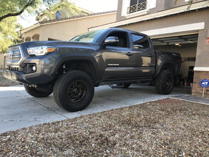

    Icon Stage 4 with tubular control arms. I haven't had a chance to go off roading just yet, but it's a nice ride on the road.

    The wheels are from @SCSPerformance and the tires are the ones that come with the TRD Off Road.

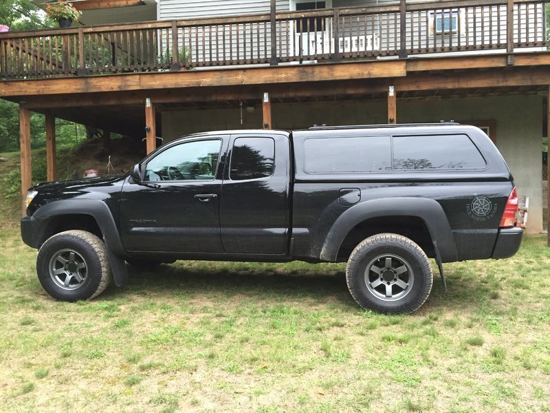

    The more you lift it , the more problems you have, the more money you spend to fix the problem. I did a 2" up front and 2" in back, Headstrong supplied the parts, I'm happy with the result.IMG_0466.jpg
