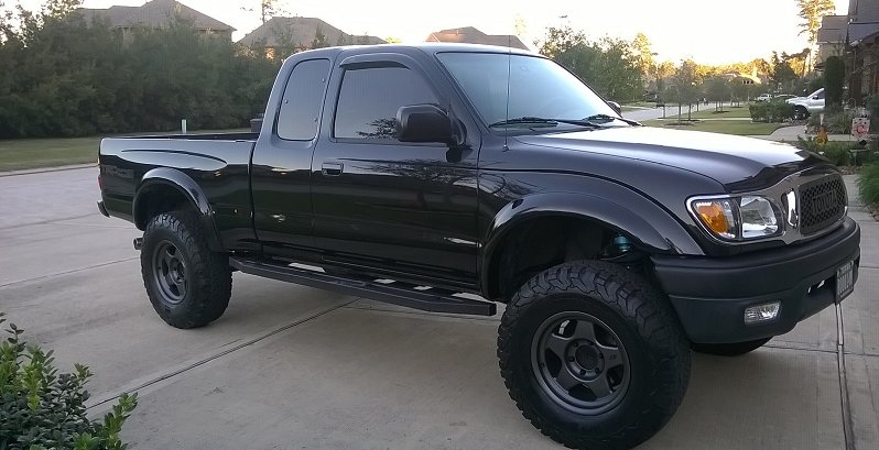

    Why screw with anything less?
    Kings FTW. Fantastic on road ride as well.

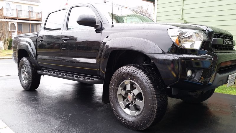

    2015 4x4 dclb
    Icon suspension '15 toyota nav TRD FJ SE anthracite wheels Weathertechs Trd pro pieces
    98%on road. Want to do it once. Don't want negative side effects. Sounds like me.
    Icon stage 2. Falken 265/75/16
    Love it! Rides just right for me!

    Well not a 3rd gen but curious whT lift do you have the coil overs set at?
    Stock upper arms?

    Looking at the stage 1 or 2. What do you have the coil over lift set at?
  10. Jan 5, 2017 at 4:57 AM
    #30
    spiralout462
    spiralout462 Well-Known Member
    Sep 16, 2012
    #87068
    1,792
    Eastern Shore VA
    2015 4x4 dclb
    I left it alone. I haven't cranked up or down yet.
    Yes, stock UCA.

    Thank so for the reply. So did you get about 2" or less?
    Also these are the 2.5 Icons that give you up to 3.5 lift on the 2nd gen when cranked correct?
  12. Jan 5, 2017 at 8:39 AM
    #32
    spiralout462
    Sep 16, 2012
    #87068
    1,792
    Eastern Shore VA
    2015 4x4 dclb
    At least 2" out of the box for me. 2wd dcsb.
    Correct
