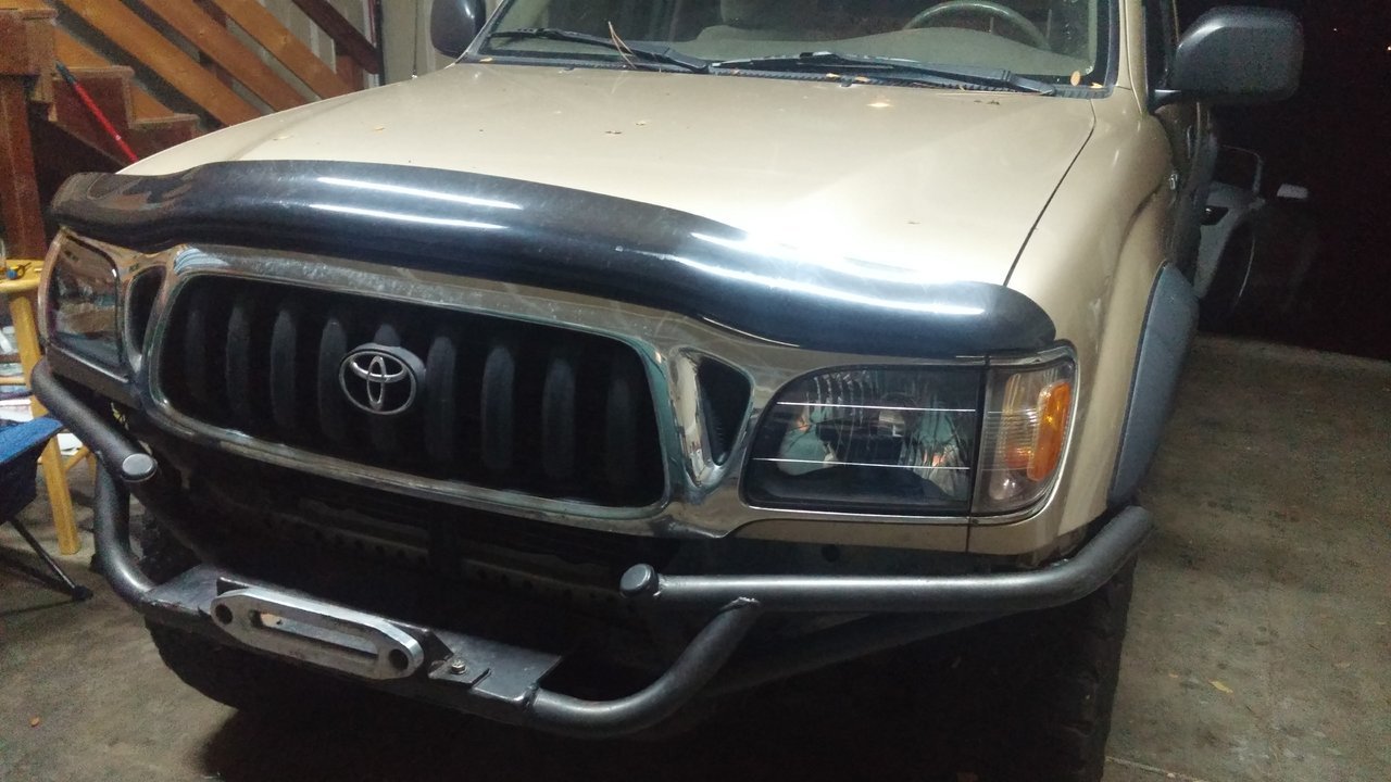

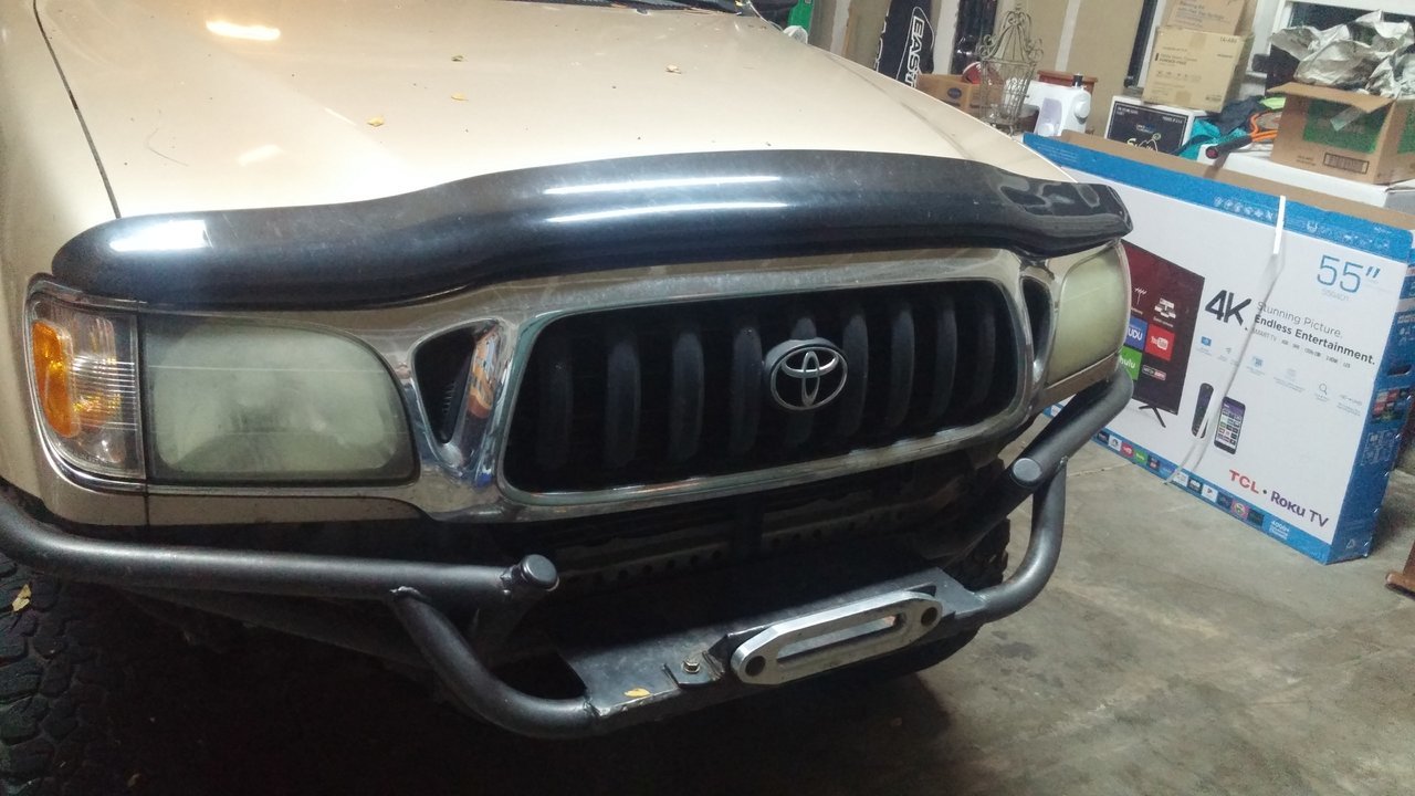

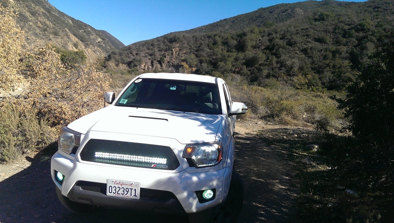

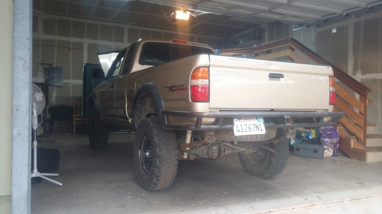

    My son has a 1st gen and has a light bar mounted roughly wear the top of the windshield meets the roof. It's super bright but I don't care for that location as it illuminates the tiniest spec on the windshield and pollutes the dash some.
    I'd like mine mounted somewhere north of the hood. I plan to get a winch, so the obvious spot is spoken for. I don't care about the shape of the lights. I'd consider replacing the grill for a behind-the-grill setup.
    For kicks, you can see before/after with new headlights. I bought it like that and they were the most hazed lights I've ever seen. I drove it home at night, from the seller, some 175 miles (two lane) with the brights and was never flashed once.

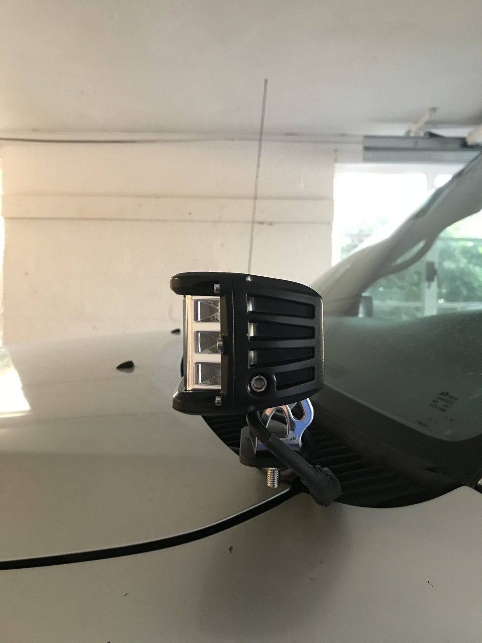

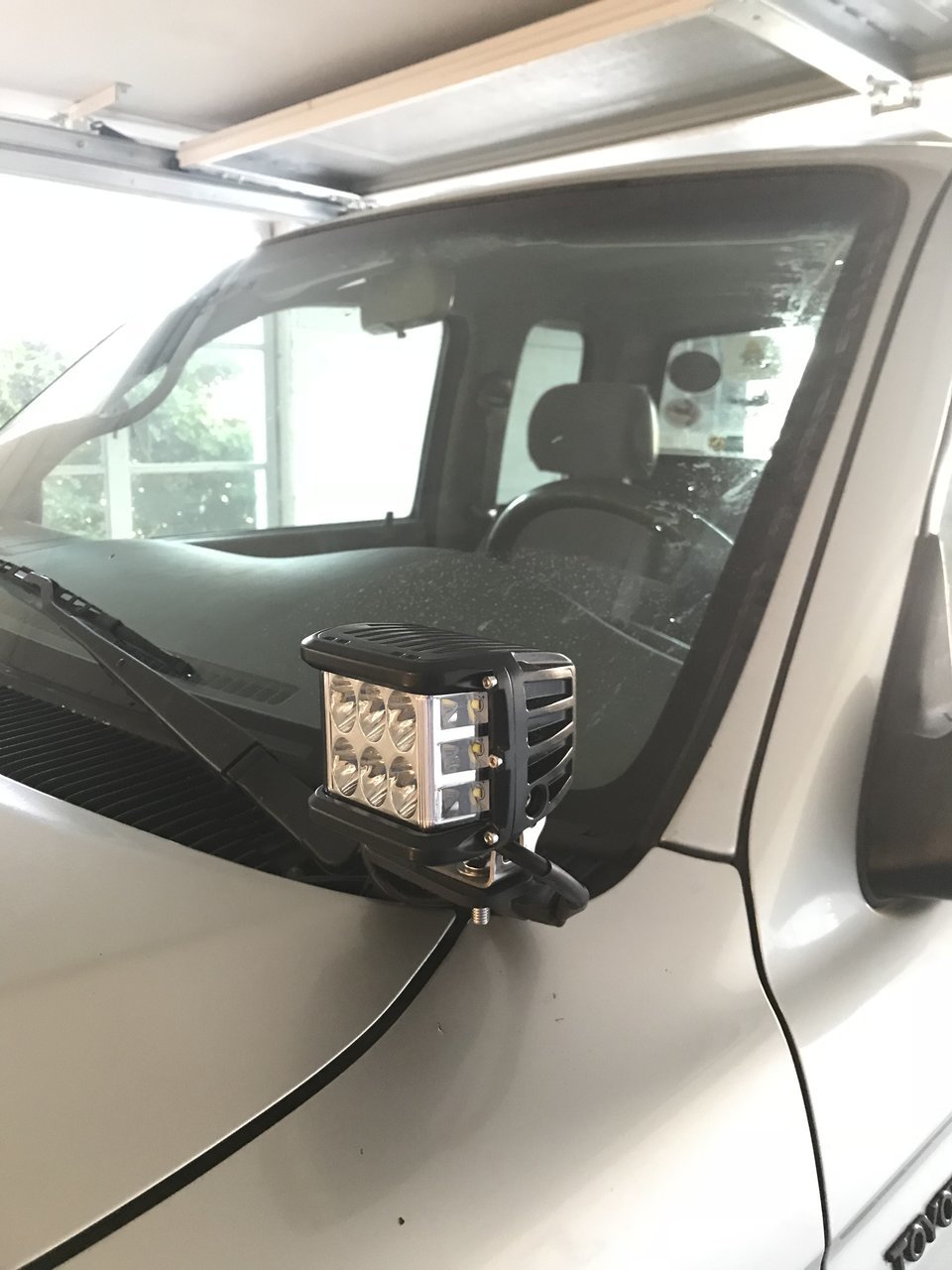

    tony2018 Well-Known Member
    Feb 24, 2014
    #123866

    Thats an interesting front bumper design. What what lights do you have?

    The first owner made the bumpers custom. He worked for the Navy and did on their time. He did a fantastic job, very strong, welded directly to the frame.
    I don't have lights yet. I'm open to recommendations.

    They're hard to see, but it has great rocker bars too, so not in the way.

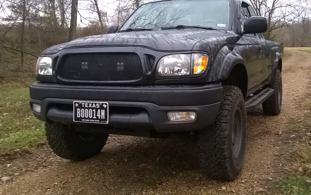

    I’d say stuff a bar behind the grill, and get a mesh grill.
    Worked well for me, doesn’t block the light any

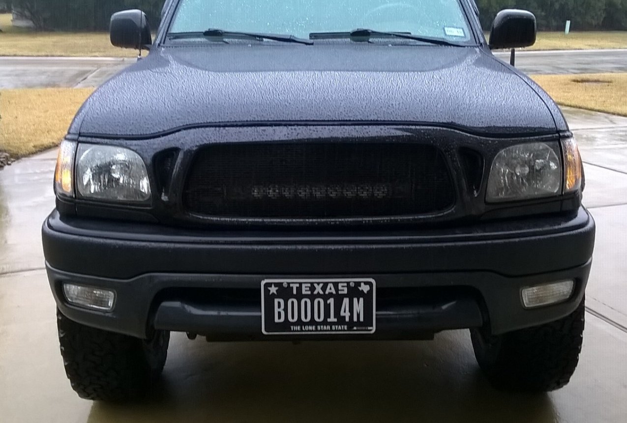

    Hi Art,

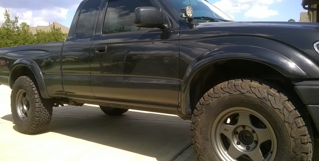

    I mounted mine behind a Homer grill (a great guy here on TW) @HomerTaco. Youre right, youll need to replace your grill with some sort of a mesh set up for the light to pass through for effectiveness.
    I also had a BAMF light bar mount for our 1st Gens and mounted 2 Baja Pod lights then switched to a Rigid Radiance Amber backlight. Better coverage for what I need.
    Some pics below, feel free to PM me with any questions. I also had some ditch lights on either side of the hood, you might like that set up too. Pics below.
    12 months ago with ditch lights (CBI mounts with Baja pods)
    4 months ago with Baja pods behind the grille.
    Current setup
    ArtP[OP] likes this.

    I REALLY like the idea of hiding and protecting it behind the grill. It's also up higher. I'm sold.

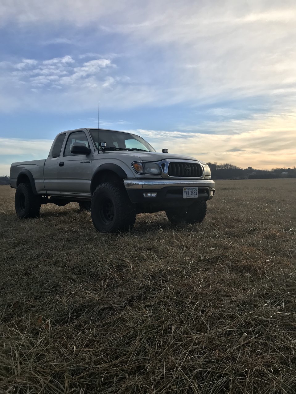

    Ever considered ditch lights? F78CEE36-3164-460B-BD22-9B56C341C7A9.jpg6A7C9C07-3B9E-4CD8-873B-3E25D5B67AC9.jpgFC9567C5-2E46-4E54-B6D7-EB75435A9F6E.jpgF804F323-E622-4580-9B43-714B674690EB.jpg

    You get wind noise from those lights on the highway? How about glare from the hood? How about visibility, do they block your peripheral view?
    But to answer, yeah, I considered them, but thought there must be a better way. I'm here to learn though. I have no experience with them.
