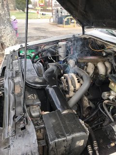

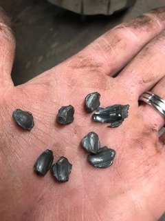

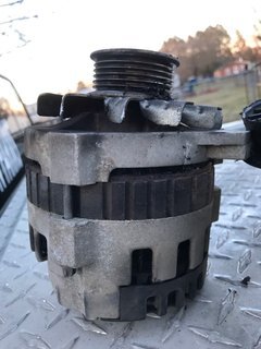

    My alternator had been making a noise for some time and it finally went out on my old truck last year on my way home. I started smelling smoke about 3 miles from home and called my wife and said get the hose ready, this is after she put it out. Those are the balls from the bearing in my hand.
