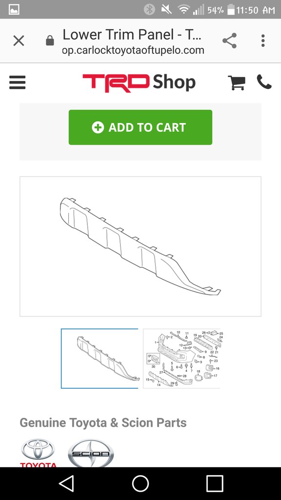

    Im trying to find out some info on the removal of this piece as i would like to wrap or paint it.
    I want to know how difficult/easy it is to remove.
    I cannot seem to find any instructions. I spent time searching the forum.

    Piece of the front bumper?

    Do you need to know, or care?
    Read through this....
    https://www.tacomaworld.com/threads/16-tacoma-bumper-cap-removal.404082/

    This is pretty easy to remove. You'll need to pull the grill first. Then there are clips all around the perimeter of the bumper insert that you'll see with a flashlight. You'll want to remove (I think one push pin and a couple friction fit clips) the radiator splash guards. Your challenge will be the two blue clips at the lower corners. I was replacing mine so I just cut the clips out but you'll have to be more careful. Taco Bandit has a great YouTube video of his process if you Google his channel and Tacoma front bumper replacement. Let me know if you have questions once you get into it. I may have missed a step here by memory.
