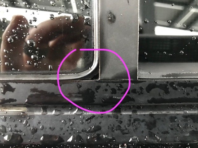

    Have had the SnugTop Rebel for 4 years now, never leaked on me once. SoCal been getting a ton more rain than usual this winter. I realized the driver side window on the shell was leaking, which was soaking the bed rug, which was draining down the bed yada yada.
    Took the shell in twice for reseals, as in they took the window out and resealed the bastard. Today realized it was still leaking, so went in the back of the truck to do more investigating. The only area around the window that was wet was here (see pic)Pic1.jpg

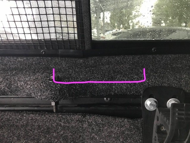

    as you can see, its seeping down on to the rails by the darker shade of the bed rug and the actual rail itself. No other part around the window is wet. So I looked closer and this is what I found. Pic2.jpg

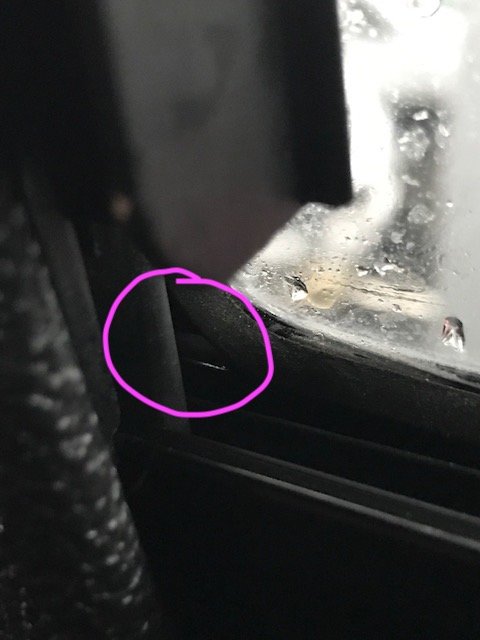

    That rubber is supposed to be at a 90 degree angle, a view from further back.Pic3.jpg

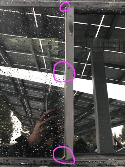

    This "hole" is in the exact spot where the leak seems to be coming from. I then went to the outside and saw this:Pic4.jpg
    Same corner, but from the outside. Further back view:Pic5.jpg
    It seems the rubber seal around the glass has peeled in those corners. I compared this side to the passenger side. Exterior peeling a bit, but the interior doesn't have a hole like the driver side does.

    silicone that bitch up

    That’s what I’m thinking. Wanted to post in case someone else has had this issue prior to me. Maybe I’m a unicorn...

    Over time those seals shrink in length opening up at the corners and where the two ends meet. Either goop it or get new seals. The frame to shell seal should last much better than those rubber pieces.

    Lots of silicone. My old shell I hade for 13 years. when I got rid of it the rubber seals in some spots had shrunk so much there were half inch gaps everywhere.
