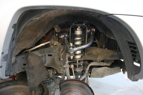

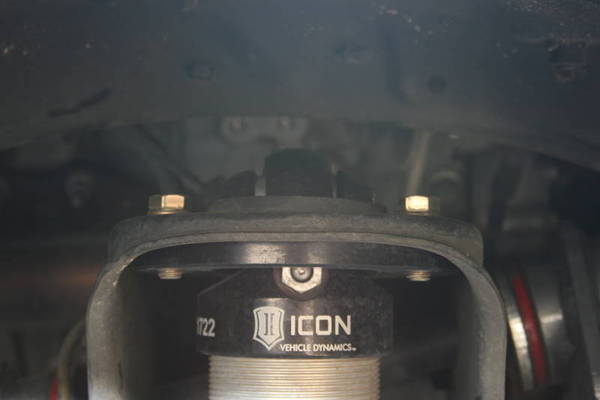

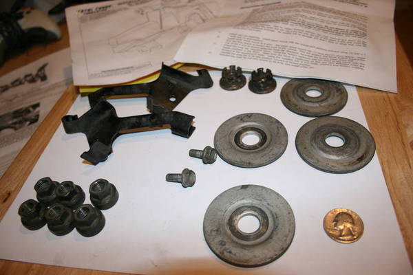

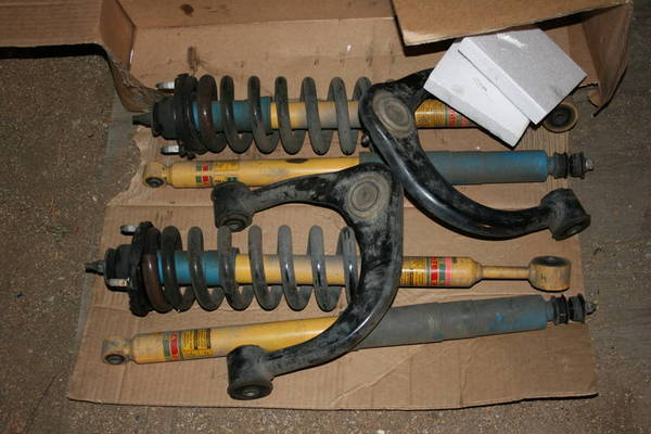

    Ok I am getting started. I got the truck on stands and the wheels off. I am posting some photos so the next guy can have a good reference. Looks straight forward like four bolts on the coilover. three up top and on down low. First I got to pull of the uca's. Using the install write up that's stickied in the suspension thread. I hope this goes well any input is welcomed.
    couple of quick questions:
    Do I need to disconnect the battery?
    Is their a right and left shock or can the be put on in any configuration?
    ok here is what I have for parts:
    Here is a look under her skirt

    No, you don't need to disconnect the battery. But, if it makes you feel better, go ahead. Takes 10 seconds.
    There is no left/right coilover, but depending on how many miles you had on the stock parts before changing them out, one might be a little more "broken in" than the other due to the "taco lean", but probably would be barely noticeable at all.

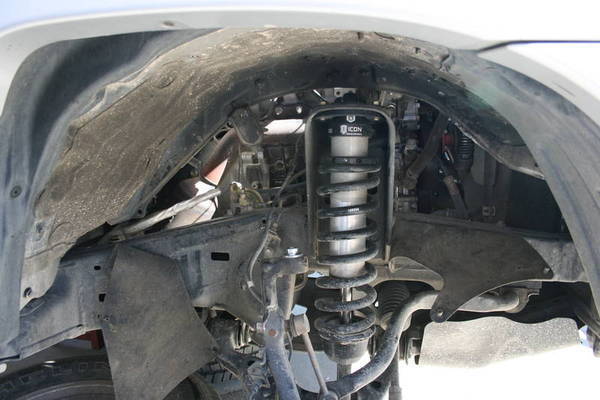

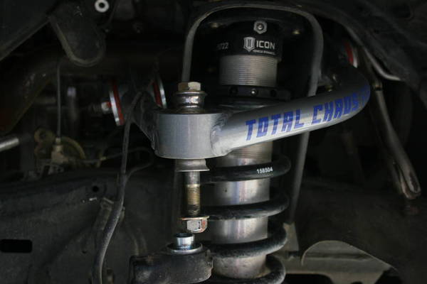

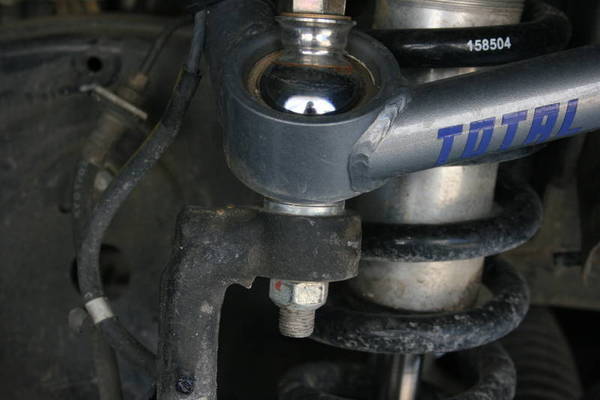

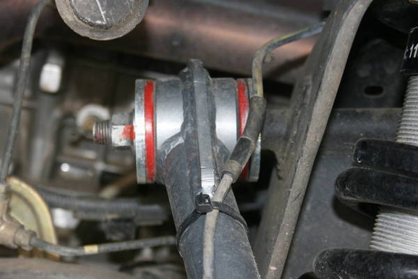

    Ok so I managed to get the ucs off. My only problem is a little sleeve where the ball connects. The last pic in the post is the part i need to convince.
    first I undid the bolt at the ball joint.
    Then I removed the long bolt on top. Wish the shop had put it back in like chris4x4 did. I t was a pain getting it out. I will definitly put it back in backwards.
    Lastly the problem child sleeve.

    So, can you not get it out? Is that the problem?

    yeah its really in there. I just tried tappping it with a little hammer but it didnt budge. I couldn't really get a good swing cuz of some stuff below it.
    Did yours just pop out? Thats right you would of put it in and not needed to remove it. I hope it doesnt require a press:(

    have you soaked in in PB Blast or wd-40 or anything like that?
    try soaking it real good and hitting it with a rubber mallet...
