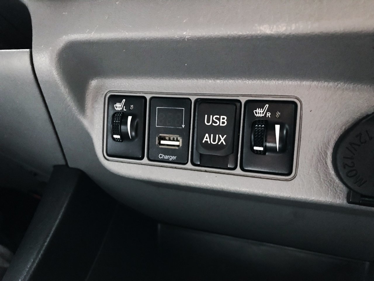

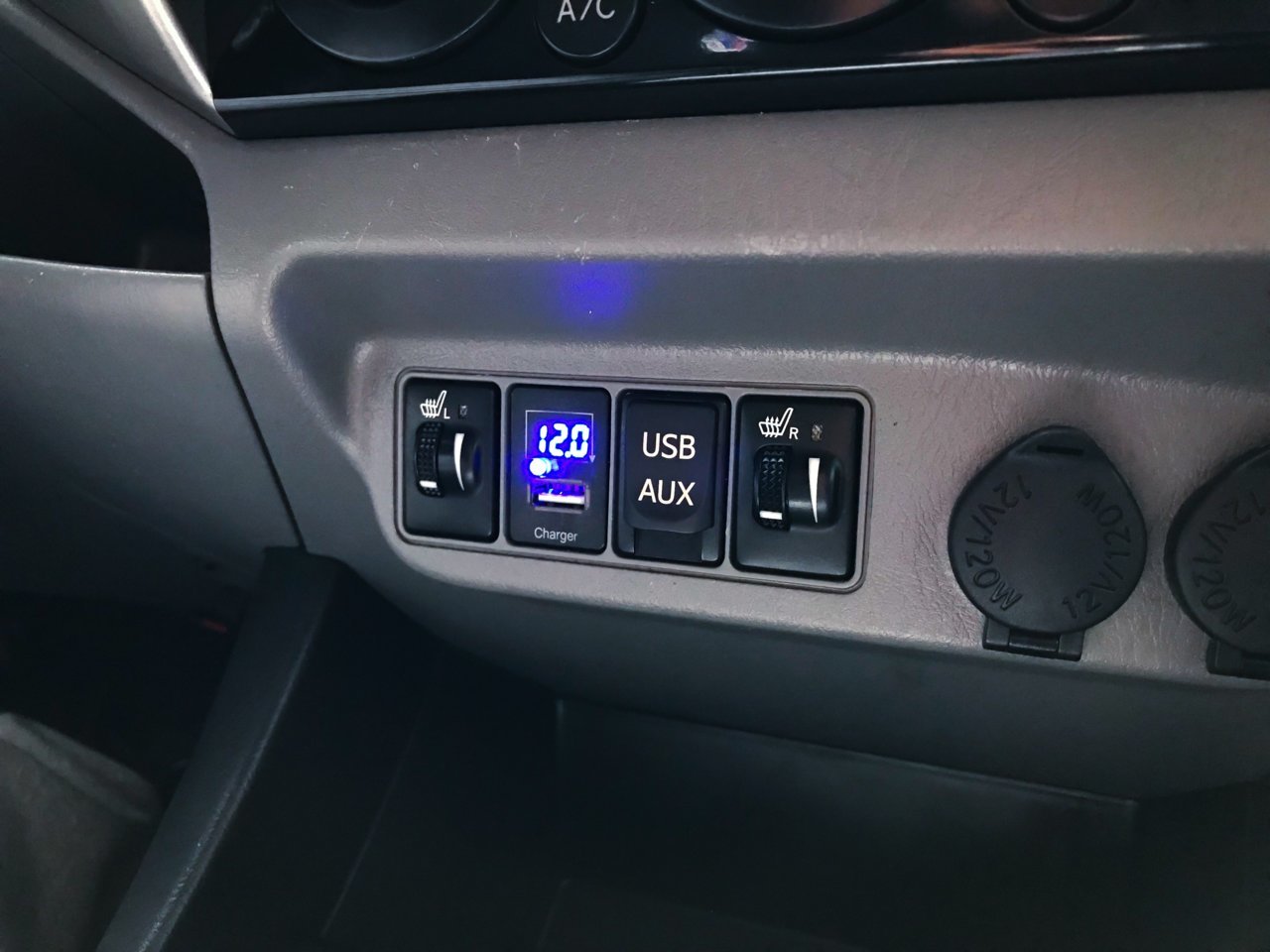

    I need a USB Type-B port, prefer next to USB/Aux port. It doesn't have to have a cover like the USB/Aux port but would be nice if did. I can't find anything online.

    Haltech Elite 1500 uses Type-B, I wanted an easy way to connect to my ECU. I guess I could run a conversion cable to back of regular USB outlet.

    Ok, so while the "haltech" website is seemingly broken, I was able to find a few details on reseller websites. Looks like that device *itself* has a USB-B socket, and comes with an A-to-B wire, and you are under the impression that you would need a B-male-to-B-female wire run from that box to a socket on your dashboard, correct?
    You don't need or want that.
    What you want, is this;
    https://www.amazon.com/USB-C-Female-Cable-Panel-Mount/dp/B076MPGMW6
    and this;
    https://www.amazon.com/Electop-Female-Print-Adapter-Converter/dp/B014RESWU4

    Now need an outlet that'll accept plug a usb into the back, which looks stock
