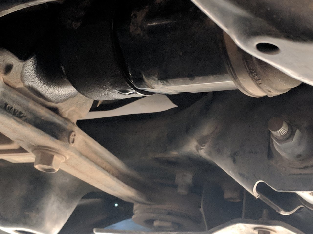

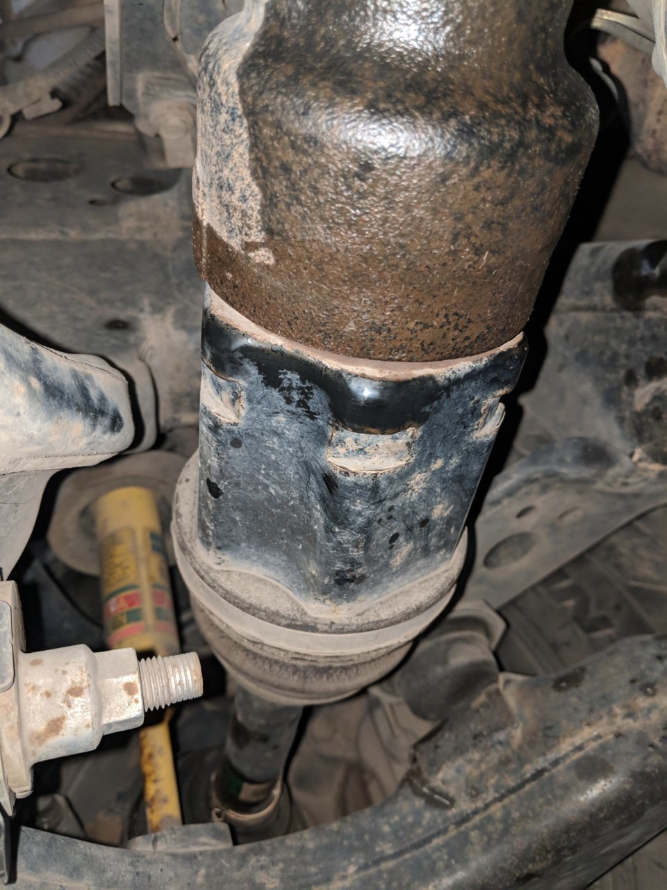

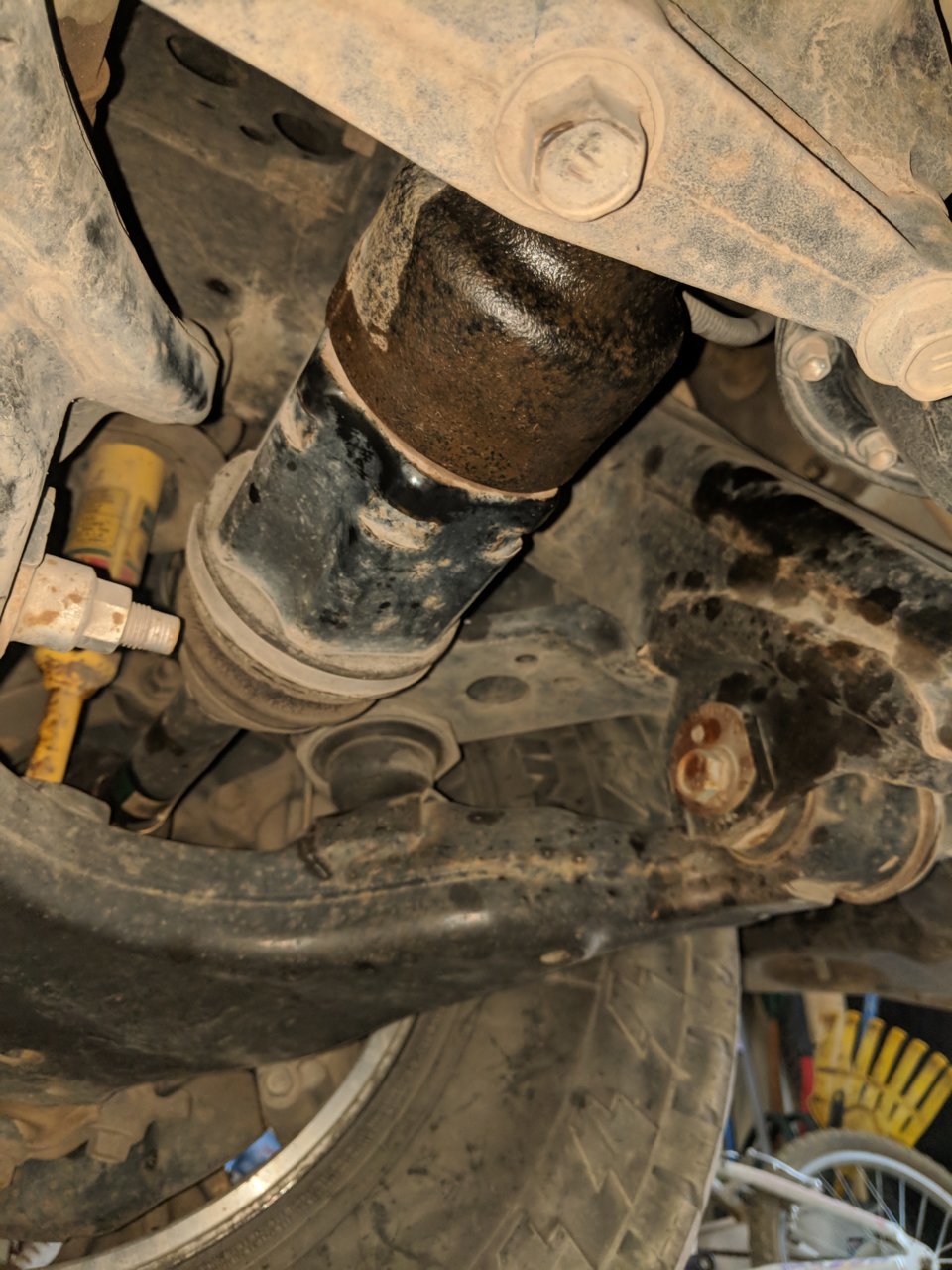

    A new leak showed up today. Hoping you guys can tell me what it is and how to fix it myself. Its located by the passenger side tire near the oil pan.

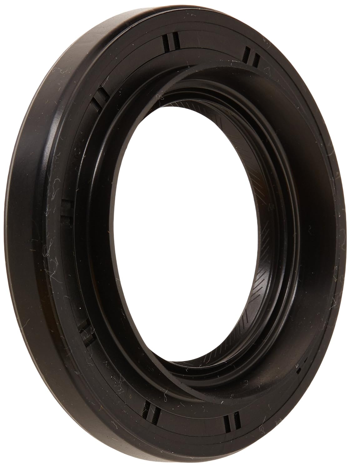

    Axle seal

    You will need to pull CV axle and replace seal. Not too difficult of a job, just have to be careful removing and installing new seal to not scratch/damage mating surfaces. Seal is like $15 from the stealership.

    Pack some grease into the back of the seal where the little spring is before you install it. The grease will help keep the spring in place when you're tapping on it

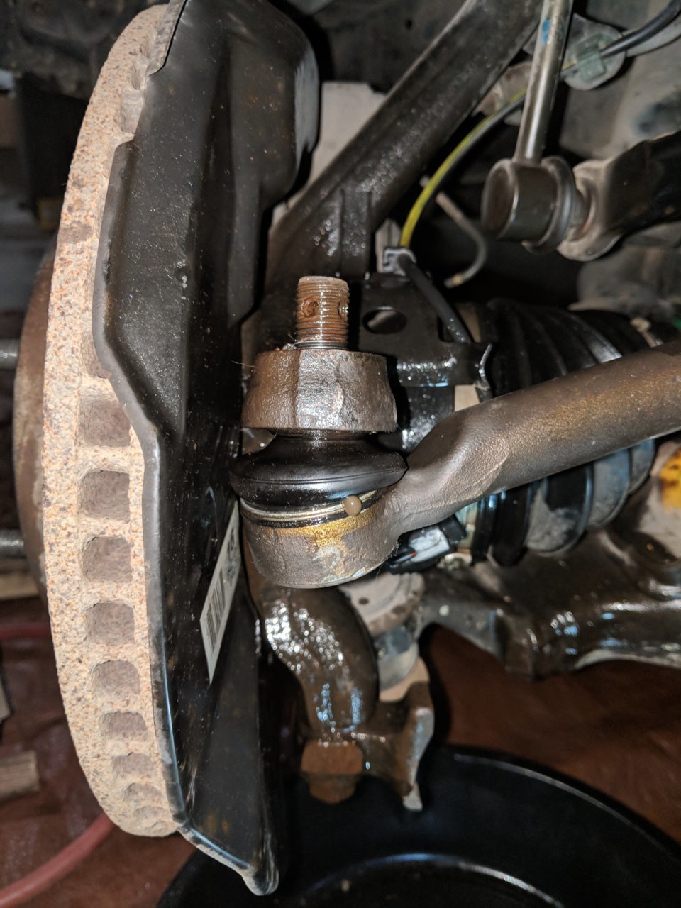

    I'm working on it right now. The bottom of the knuckle has two bolts. The smaller of the bolt I believe is called the tie rod. It has a rubber boot on the bolt. I was banging on it with a hammer to knock it loose and I hit the rubber boot. It now has a pretty cool whole in it. How bad did I screw up? Can I replace just the rubber part?

    That tie rod end might wear a little prematurely, but it’s not ruined. You have to keep an eye on it though. If debris and water get in the boot and rust the joint, it’ll go south real quick. You can get a needle attachment for a grease gun and keep fresh grease in there. That does kinda suck though. Changing a tie rod end is not very hard. You could replace it if you wanted.
    The “proper” approach would have been to rent a tie rod separator from an Autozone for free.

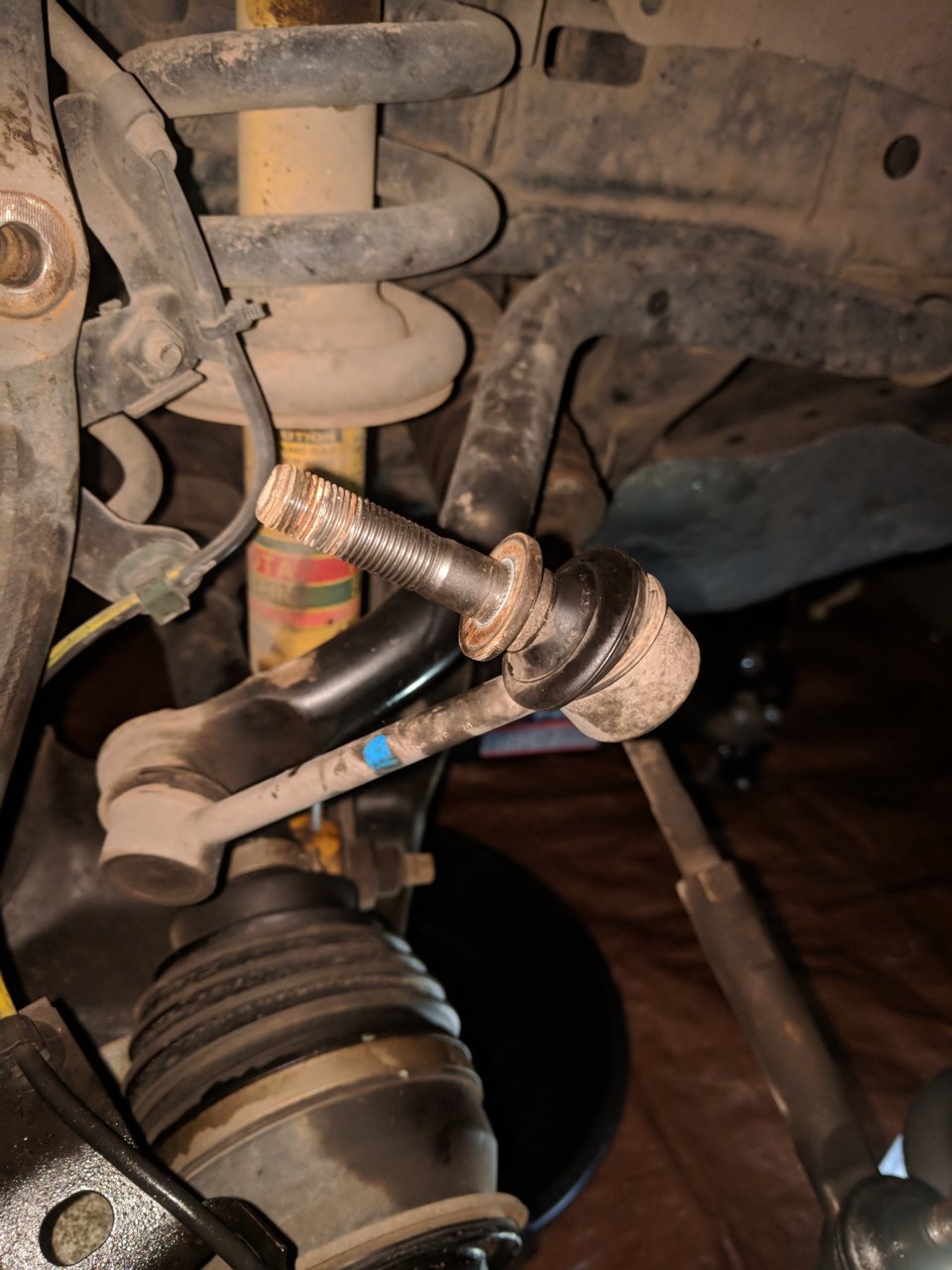

    I made the same mistake with the Stabilizer bar link. The rubber boot on that is poked through too. The nut kept on spinning so I tried to grab the other end with pliers. The pliers must have made the whole.

    Winter is almost started. We get lots of snow and mud. I can guarantee water and dirt will get in there. Plus its leaking fluid. So I have to replace the whole tie rod then?

    The stabilizer links are not nearly as important. You just don’t want them getting so corroded that they fall off and do damage to your cv axle.
    As for the tie rod, I think that you can just replace the end you damaged, not the entire unit. The other end goes into the the steering rack and you need a special tool to remove it. The end you damaged should just unthread, and you can put a new one on. But it’s postition is critical, as in # of turns. It’ll mess with your alignment.
