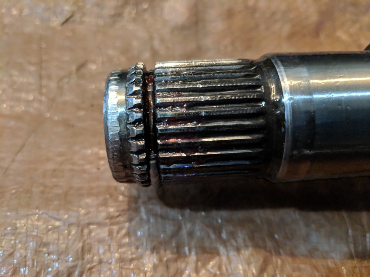

    Can you post a pic of the shaft splines?

    My internet really sucks. Most of the pictures I tried to post didn't go. But give me a few minutes to try.

  8. Sep 18, 2018 at 7:32 PM

    Well... just gonna be blunt here. Splines are screwed. And looking at the end of the shaft you more than likely damaged the inside where it mates to the diff.

    Do I need to purchase a whole new cv? Is it repairable? Can I sand or file it down?

    I shouldn't admit this, but I have filed down spines on the trail when I needed. You can get just the inner shaft separate though. Or if you don't really do any hardcore wheeling go with an OEM rebuilt

    Yeah lots of it. Try to match the pitch on the main splines if you are going to try. Good luck man. I've done it on drive shaft yokes and made it work but it's sort of a 50/50.
    And like I mentioned looking at the end of the shaft before the splines, it is possible that the internal part mat be mushroomed

    Good point. I will try to sand the possible mushroom part first. It seems much easier.

    Just to clarify... I'm talking about on the inside of the axle tube where the CV shaft enters the internal shaft. That part may be buggered up too. Look inside with a light and verify they aren't deformed
