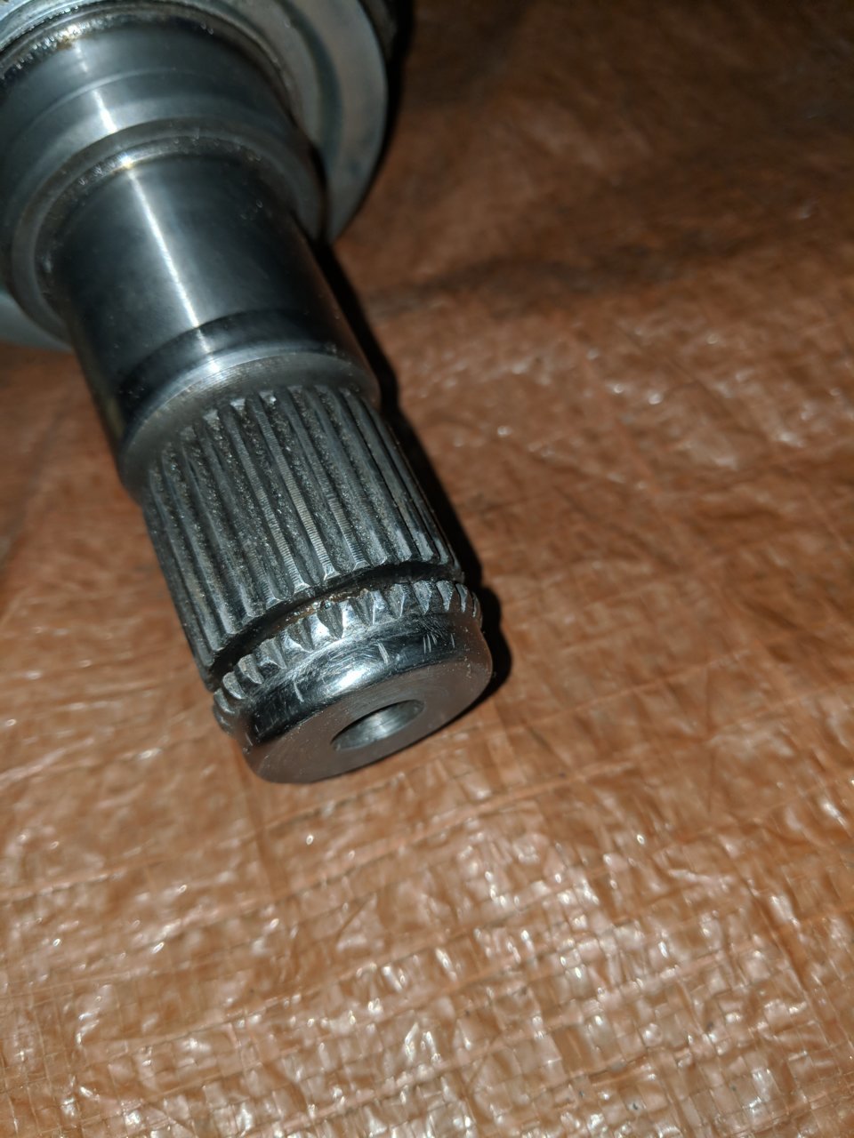

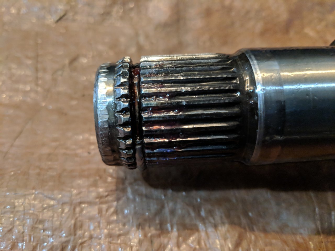

    Without prior damage I've always been able to shove the CV in by hand on either side. Make sure the c-clip opening is on top, compress tube, make sure splines are lining up and then one good shove and in it goes.
    Kudos for trying but maybe get some help? You've destroyed a tie rod, a sway bar link, a CV and likely your ADD tube so far and you ain't even done

    Good enough you think?
    Before:
    After:

    What about the diff tube?

    I will clean up the CV a little more and see if it slides in without the c-clip. I'm assuming it should just slide in with no c-clip.

    Booyah!!!! Sanding worked. CV is in

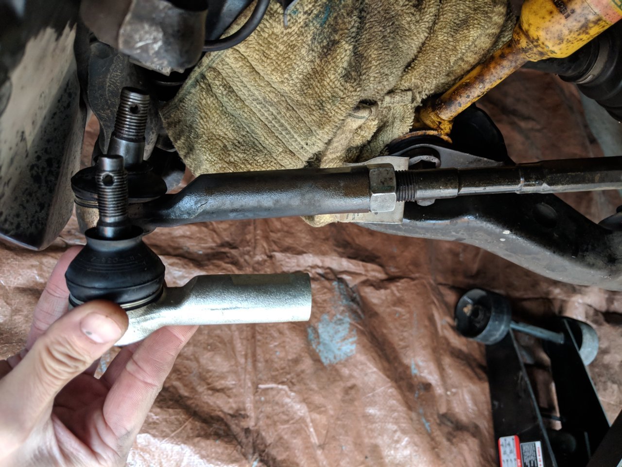

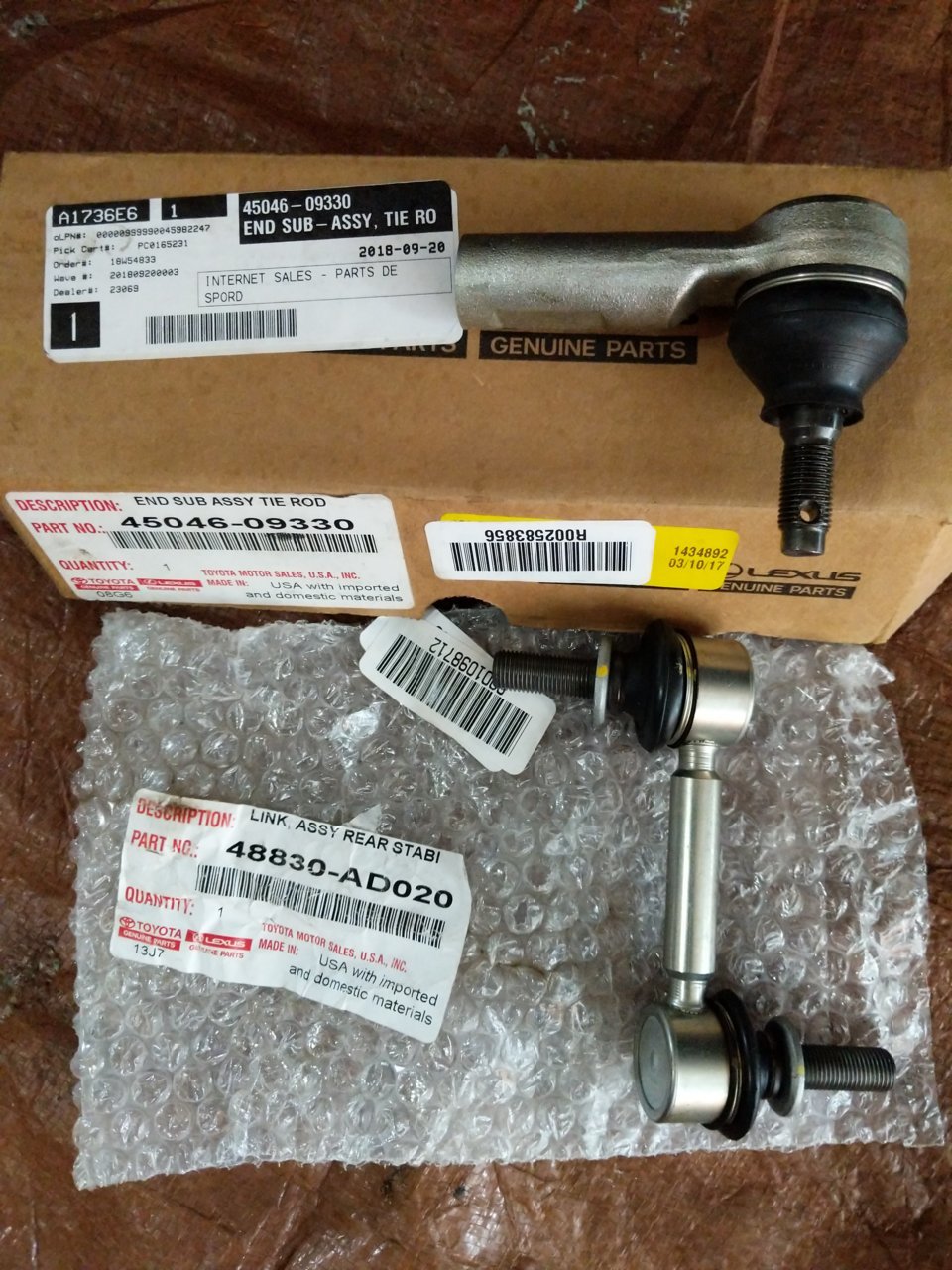

    Morning tw,
    I'm installing the new tie rod to replace the one I damned and the new tie rod is about two inches shorter. Does that sound correct? Internet instructions say to count the number of turns when removing the old one and screw the new one on the same number of turns. But if it's shorter will that mess things up?

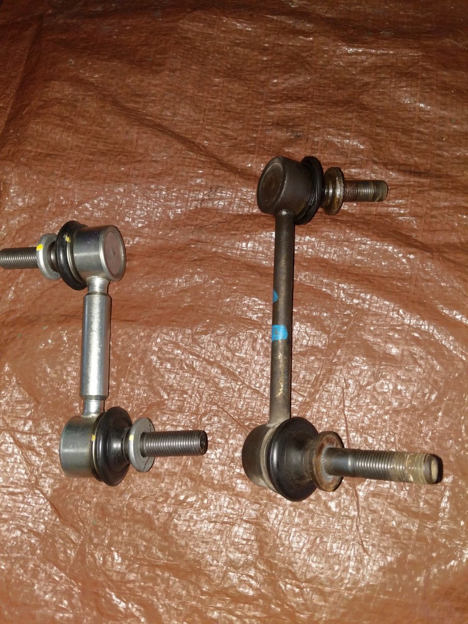

    I'm replacing the stabilizer link too and it's also shorter. Wtf? The angles the bolts are facing is different and it doesn't seem to fit.

  16. Oct 6, 2018 at 12:59 PM
    #96
    [eric]
    [eric] [OP] Well-Known Member
    Feb 11, 2009
    #13502
    232
    Eric
    Bend, OR
    2005 Tacoma TRD OFF Road
