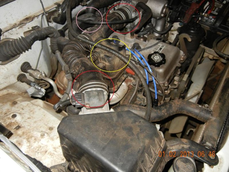

    Thanks for the input guys. I see the clamps at each end which I marked in red. Where I circled in pink, that one tube is where its unfortunately right over the spark plug. I don't think I can remove the 3rd spark plug without removing the intake first. I don't have any clearance to pull off the plug boot and inserting a ratchet. Btw its a 3rz motor from a 97 4runner (idk if that would make a difference). Where I circled yellow that square box thing is mounted would I have to remove that as well?

    I didn't realize you had a 4-Runner motor in there. The intake is different than that of my Tacoma. Any advice I can give you would just be a guess based on your pictures; can you remove the tube that you have circled in pink? I'm assuming not, otherwise, you wouldn't be asking. If you can remove that then you might be able to clear the intake using a long enough extension on the ratchet.
    That box you have circled in yellow is part of the intake (at least it is on my truck) and you would have to remove it. That is the section that has the 12mm bolts (x2) hiding under it; could be different on that 4-Runner motor. There is a hose clamp between the two that you have circled in red (just to the left of the yellow circle in your photo). I would loosen it and remove anything else attached to the first section of intake tubing then get that section out of your way. Then you can look around under the box circled in yellow to find the bolts or whatever may be attaching it to the motor. Good luck.

    the part of the intake hose that is the hard plastic part above the third spark plug should be connected to the plastic box circled in yellow. you need to unscrew to 2 nuts (around 9-12 mm) that screw onto two studs that are connected to the plastic box and thus attach the box to a medal bracket. This is straight down of the yellow circle.

    I really appreciate the help guys! Yes the tube circled in pink is connected to the intake. I'll try to remove the intake tomorrow or friday. I will take your guys advice. Also I am gonna take more pics so I remember how to put it back in the proper place haha.

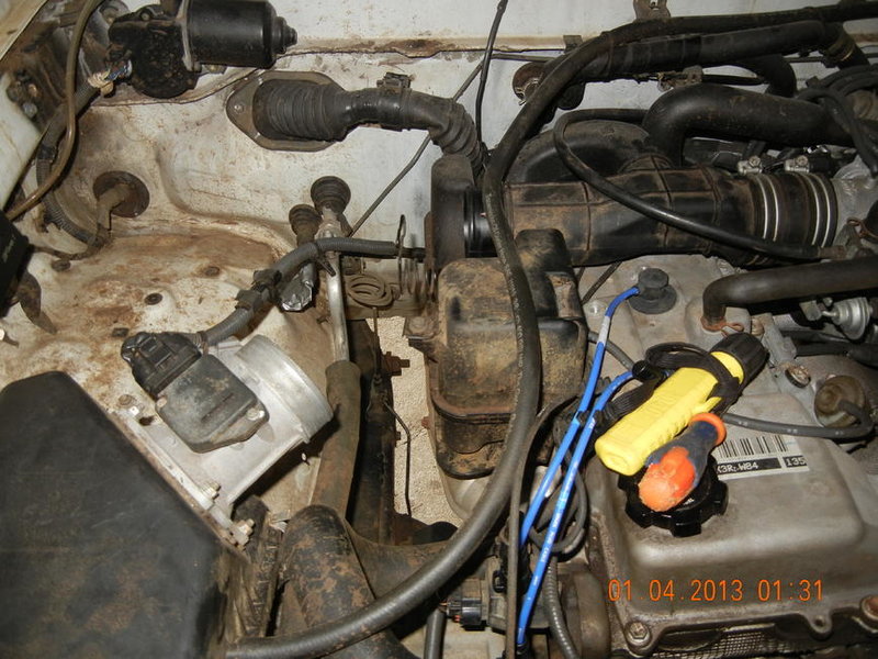

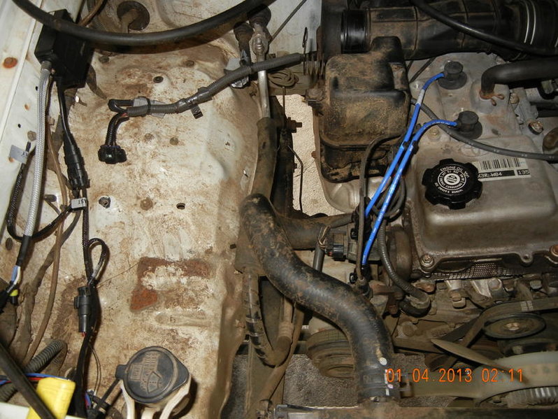

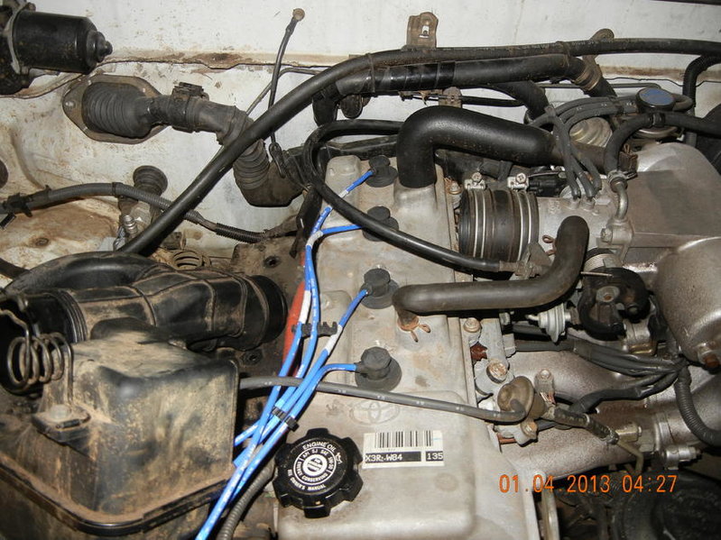

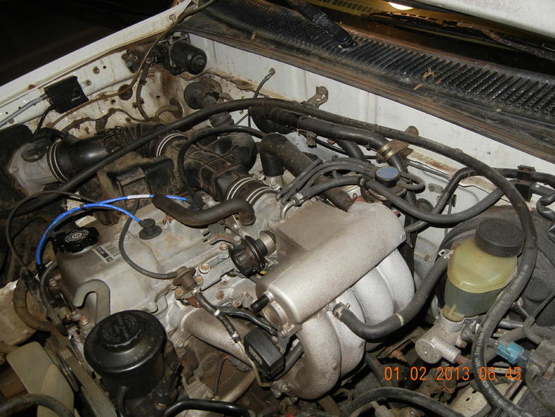

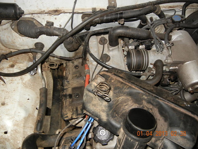

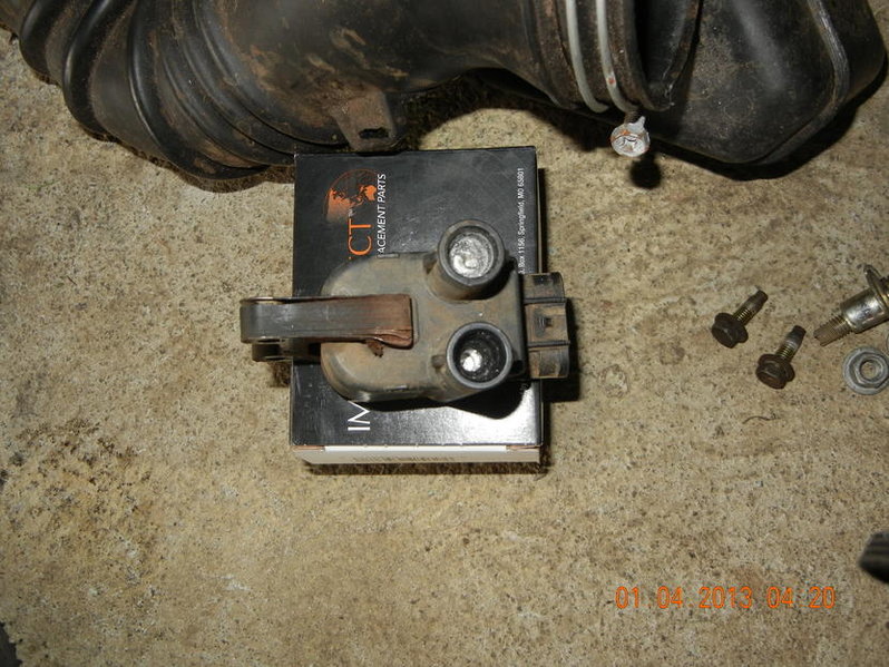

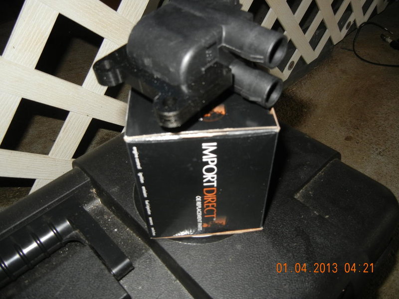

    Good news guys mission accomplished! Took me quite a while but, I had a good time and a great learning experience. You guys were correct there were 2 nuts hiding under that boxed shaped piece. I've followed your guys advice and it went really well! I took a bunch of pics so you guys can check it out. Ran into a problem though with the final spark plug it was the winning stretch then boom it hit me. The coil where you plug in the spark plug wire was all corroded so I went to O'Reilly's and got a replacement for 85$. Wasn't all that bad because it was easy to uninstall the coil because they were only 2 nuts to unscrew and a plug. Also O'Reilly's is only a 10 minute drive from home. Thanks for the help guys!
