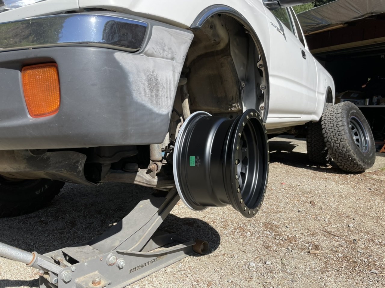

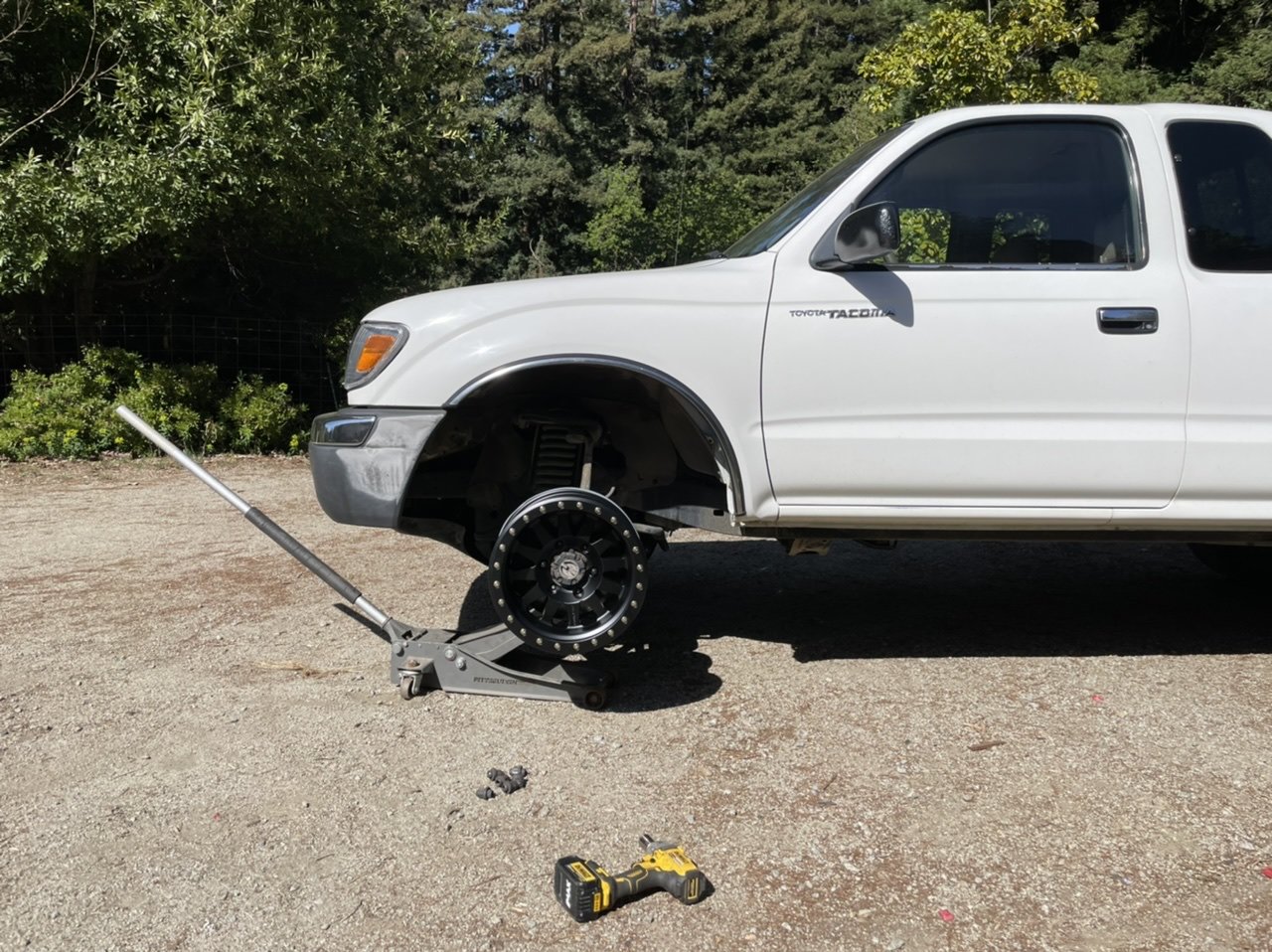

    Method Double Standards 15x8 with 3.5” backspacing. Clears with plenty of room.
