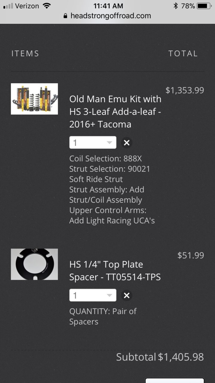

    OME is a great kit to start off with. You can always upgrade from there. The OME kit is where I started and it has slowly escalated from there. Currently looking to add extended coilovers to the front to replace my OME setup and I am also looking for more travel.

    I did ome 886 with 1/2” spacers got 3” lift up front. Did headstrong hs-3 rear 3-leaf pack got 2” in back. Did lr spa uca’s. Total cost for full suspension 1350 or close to it. So its definitly doable.
    Without a bumper go with 888. For 3” you will maybe need 1/4” spacers ontop.

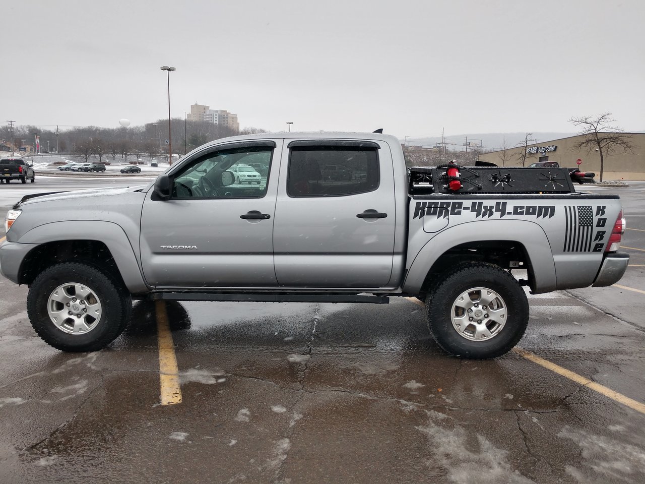

    I was in the same boat as you, went 5100's with 886's and 1/4" top plate spacer on the DS. single add a leaf rear , $750 shipped. Wheelers
    My alignment is in spec except for the caster which wont affect tire wear but does make the truck handle differently. Will be going with JBA UCAs soon.
