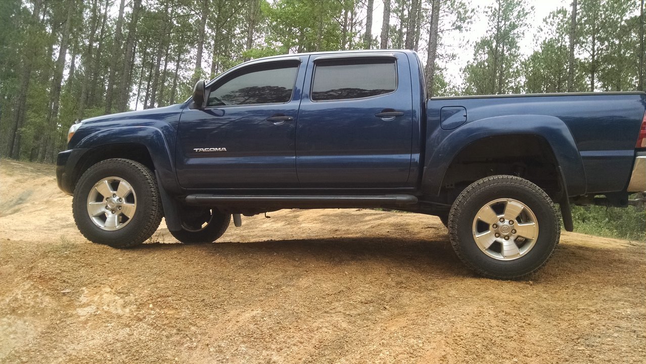

    I may catch some slack for being a cheap wad but I did everything to mine for right at $1200
    *eBay lift: Supreme Suspension 3"front/2"rear $180
    *2013 TRD Sport Wheels: $300
    *eBay spacers: 1.25" hub centric billets w/lugnuts $70
    *Tire rack.com tires: 255-75-17 (32-10-17) Kuhmo Road Venture AT $640
    *Mount/Balance: $45
    I only recommend this setup because you say you don't off-road. The issue with these types of lifts without purchasing aftermarket upper control arms is when the suspension is at its max lowest point, the upper control arm contacts the strut spring.

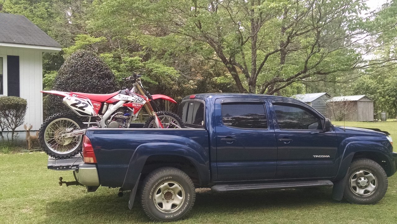

    With that said, I love my kit. It handles dirt roads well and I probably put 10,000 miles on it so far. Just an option for ya.IMG_20170413_135523690.jpg IMG_20170601_120503319.jpg

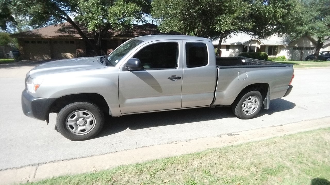

    Guys, thank you! Rusty that might be a good option for me (thanks for taking the time). I've added a picture at the top. Any other words of wisdom? Are there any reasonable wheels/tires that are taller than the TRD

    Ok guys, the OP has a 5 lug. Different suspension, different options. Fewer. Much fewer.
    On the wheels you have, 235x75 will fit, clear everything with no rubbing, and give you 1" of lift. Doesn't sound like much, but you'll notice it getting in and out.
    If you put any more tire on it that that, you'll hate the sluggishness it develops. We have modest rear gear ratios, and you are making it even lower numerically with the taller tire.
    We have a 5 lug forum, which is where you'll see more options. Don't be so enamored with the lift 'looks' that you screw up your ride/handling. Just proceed with caution.
