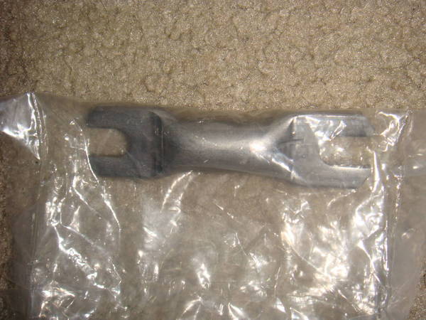

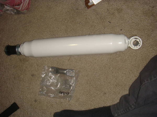

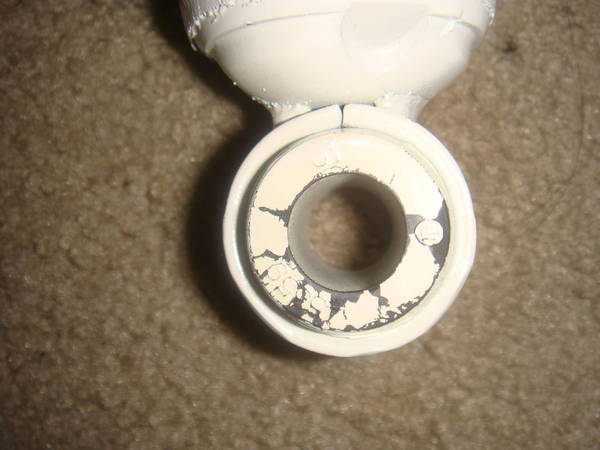

    the shocks i bought inside of the bushing to the part that connects at the bottom it doesnt have a sleeve for the bolt to go through
    also it came with this weird fork thing i dont know what its used for or what to do with it
    another weird thing is that the shock came compressed not extended is this fairly usually?
    so yeah i dont know what to do

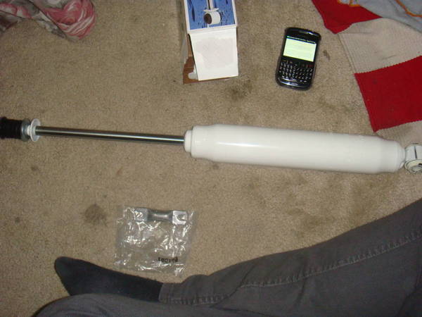

    o yeah and this is waht the shock looks like extended if you guys were wondering
    it was hard to pull out

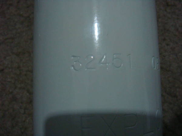

    and the part number
    it was suppose to be 324515

    I am not too sure what you mean by this.:confused: IIRC, my shocks came this way. I am not too sure about the part number. I will look for the invoice for the PN.
    This piece is for the top of the shock, when you tight the bolt with a wrench, this will hold the shock in place so it will not rotate.

    on the first picture
    the bushing has no sleeve
    so when you bolt it to the bottom plate of the axle then the bolt is just sits in there with no sleeve and then the bushing wears out faster

    I believe everything you are concerned about is normal, except for the part #. I take it those are ES3000? They probably just for got the 5. To my knowledge the Pro Comps don't have sleeves. Just about every manufacturer ships them compressed. If it were easy to pull out, it would be defective.

    I originally ordered rear Pro Comps for my truck. The bushing was too long. I called the factory and they told me to trim it. After I did, I noticed the inside diameter of the bushing was larger than the bolt, but I tried it because they confirmed it would work. After I installed them and took it down the road, I could hear a banging when going over speed bumps. The bottom of the shock was bottoming out against the bracket where it bolts on. So yeah, sent them back and got the adjustable Rancho RS9000. They bolted in like stockers. End of story.

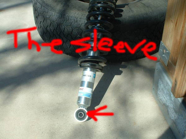

    I had pro comp 3000's on an old truck. They had metal sleeves that came in the bolt package. It just slid in as a collar/ washer type thing to keep the bolt from rubbing directly on the bushing. I would think you'd need that piece. It seems like you're going to get premature wear without it.

    also the shock had nothing ot keep it compressed
    it just stays compressed which is werid
    and when i pull them out it stays out and then i push them in they stay in
    its just weird
    are they just bad shocks?

    With the sleeves in different colors thingy, I think that is talking about the boots. Those metal sleeve/collars should be the same color as the bolts.

    My ome shocks came compressed, but had a metal bracket holding it. As soon as the bracket was removed the shock would extend all the way out slowly.

    so i finally figured it out
    oil filled shocks dont pop out like the gas filled ones
    so thats how it works

    and it turns out you can mount it up like that
    but im gonna make a sleeve so teh bushing doesnt wear out to fast

    All you need is a piece of metal tubing with the proper inside and outside diameter to match the bushing and mounting stud.

    Gas presurized shocks push the rod out. Non presurized do not.
    The dbl fork piece is for other aplications. It goes through the lower mount hole and two bolts go through the two forks.

    Sleaves for the rubber bushing are a good thing.
    Does your truck have some that are on the stock shocks?
    If so you may be able to use them. If not make sure what ever you end up using fits both the bolt on the I.D. and the rubber on the O.D.

    yeah im thinking of going to home depot and make some sleeves for it since i cant knock out the sleeves on the stock shocks
